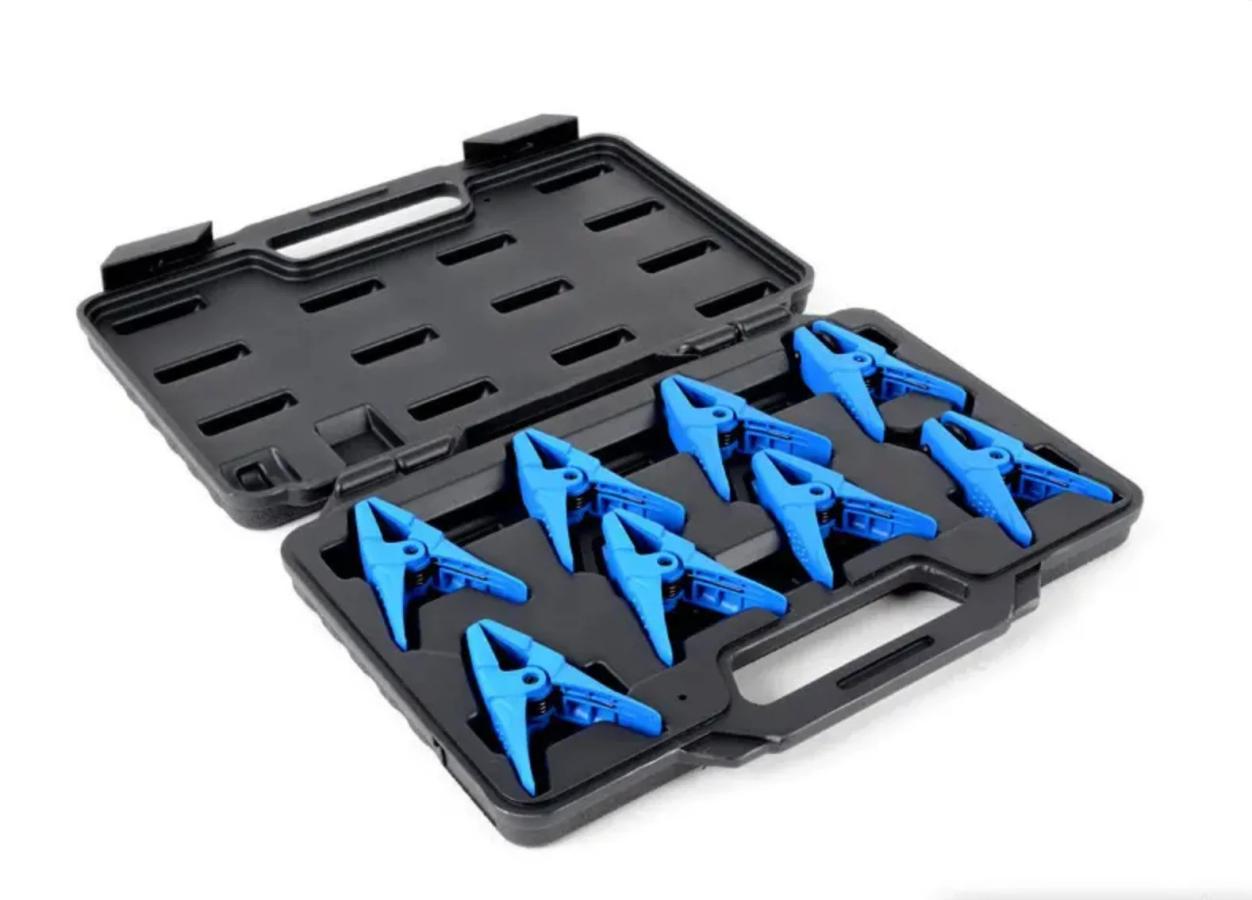

    I use the Motive bleeder for all bleeding tasks. Make sure you only use a flare wrench on the line, especially at the hard line. I use Schwaben stoppers to block the line while the caliper is off.

      I've never managed to avoid a total mess, but get yourself an assortment of vacuum caps. Then when you disconnect the lines, slip a vacuum cap over the hard line and it will prevent further leaks. You can also use them as plugs on the calipers.
      Most hand pump pressure bleeders ought to do the job, like the one from Motive. Just fill the reservoir, pressurize, and crack the bleeders till the bubbles stop (keep your catch bottle at or above the caliper; if your catch bottle is on the ground you can suck air via the bleeders threads and never know if you're done bleeding)

        Thanks for the tips. Seems I'll have to deal with some leakage of brake fluid. I'll pickup these plugs: link

          I use a rubber stopper that I can press onto the end of the hard line. Forgot where I got it from.
