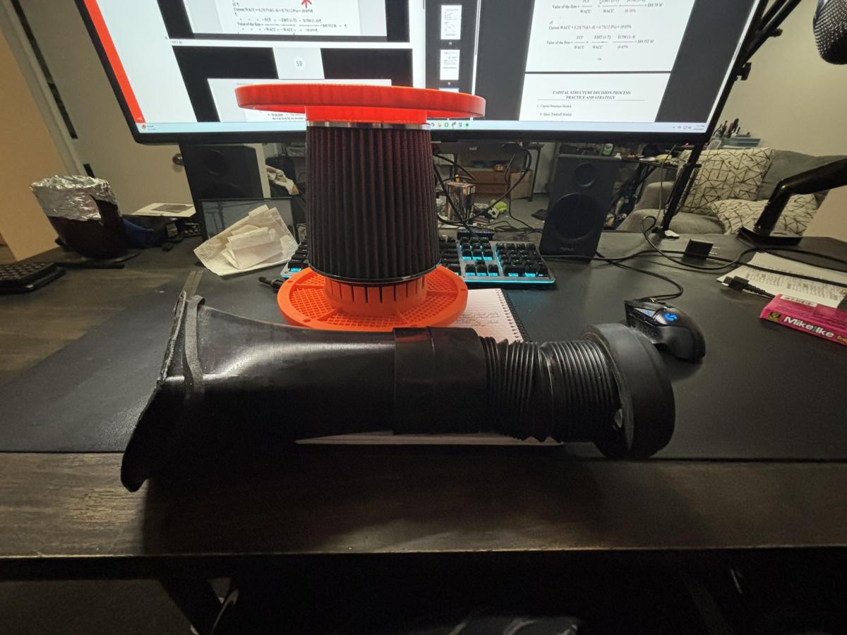

    I finally got to work on a project I've been putting off for a while. My car is a dedicated track car, and this is more of an intermediate/fun project until/if I decide to splurge on a CSL airbox.
    My current setup is a K&N Filter with an aluminum pipe running to an ECS Silicone Elbow to the stock airbox. This was a cheap alternative to switch back from a velocity stack setup. I want to provide better heat shielding to this and a more direct air feed. I plan to use the headlight intake duct as the sole air feed for the engine. This frees up the ability to use the fog lights purely for brake ducting and ditching the kidney grill feed. This is likely net neutral in terms of weight, but allows me to close off the kidney grills and brake ducts as I start experimenting with cooling.

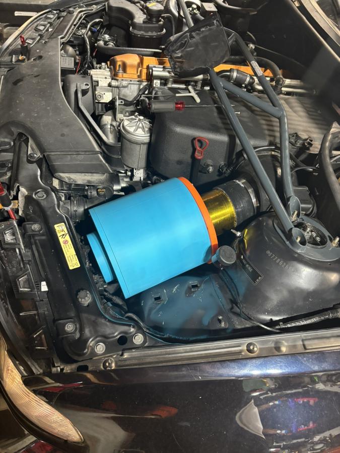

    I was hoping for insight if anyone has done similar, and if the volume of airflow is too low for the S54. See the pictures attached for my work-in-progress airbox, which I am making for the filter. This will have an 88mm opening at the front that takes a tube as a direct feed from the headlight opening.
    My expected benefits:
    • Contained airbox with direct airflow feed, less heat soak
    • Individual control of the kidney grill & brake duct openings without sacrificing intake air
    Current fears:
    • Too little airflow will be supplied through the headlight intake to properly feed the engine
    Let me know your thoughts as I'd love some feedback on this!

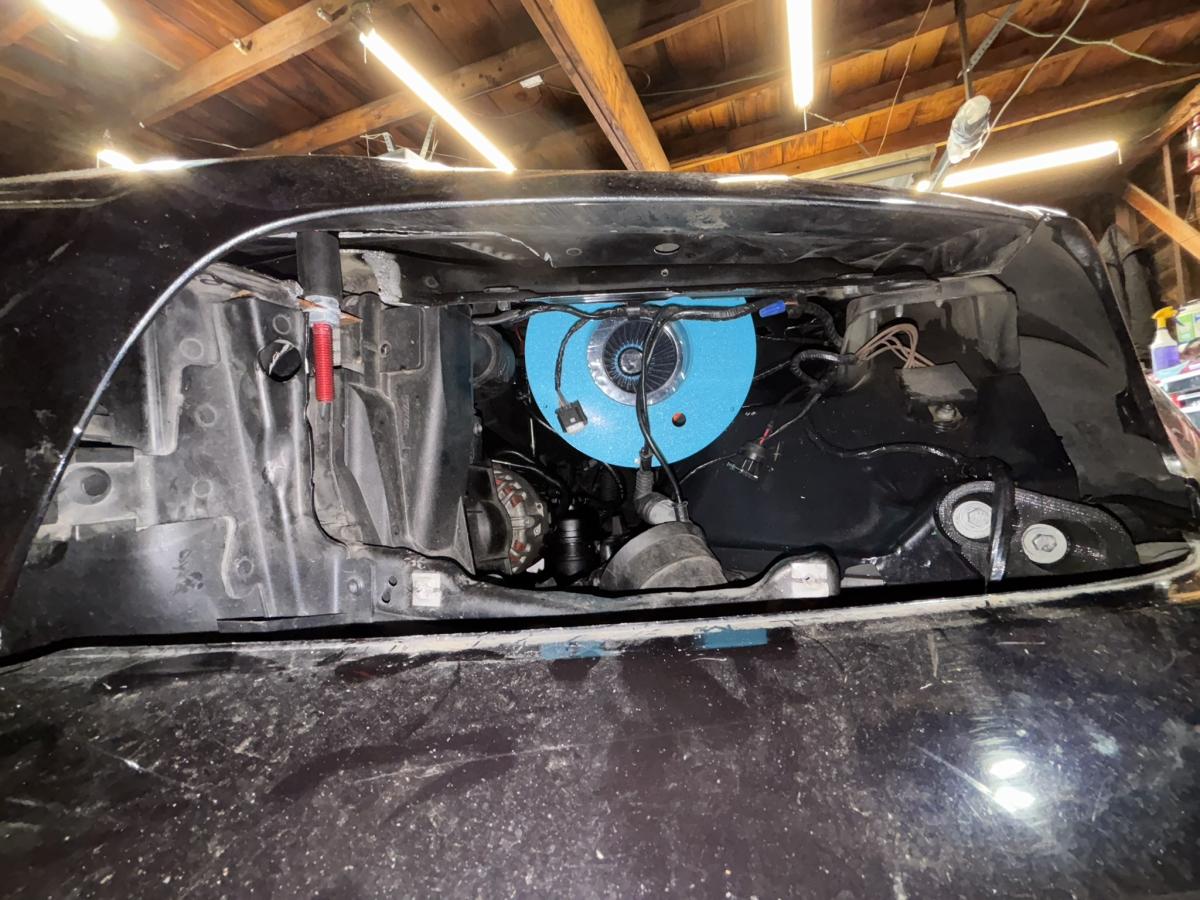

          Did you do any sort of ducting to make the intake only feed from the headlight air source?
          Once I can get the headlight cut and assembly done, I think I'll be able to better explain my concern about reducing overall airflow
            Ah, unfortunately I only installed the duct into the headlight. Didn't actually put it on a car, so can't help with the ducting part.

                Made some progress today. Still some minor fitment and cutting of the feed tube needed to be done but it's looking like it'll serve the purpose.
                I'm not sure about the lower headlight trim yet. This headlight duct isn't my model and I'm not a huge fan that they have it run lower than the headlight itself. One of these days I'll go and make my own.
