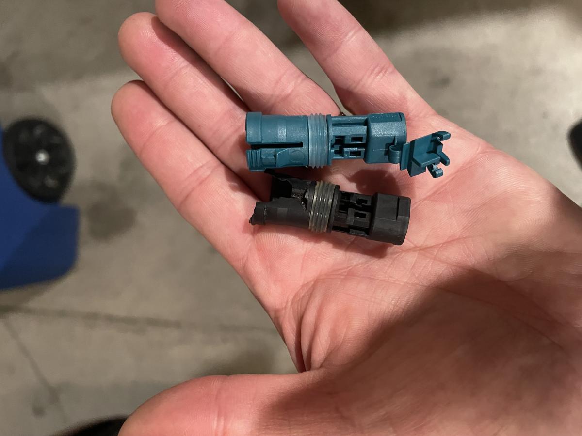

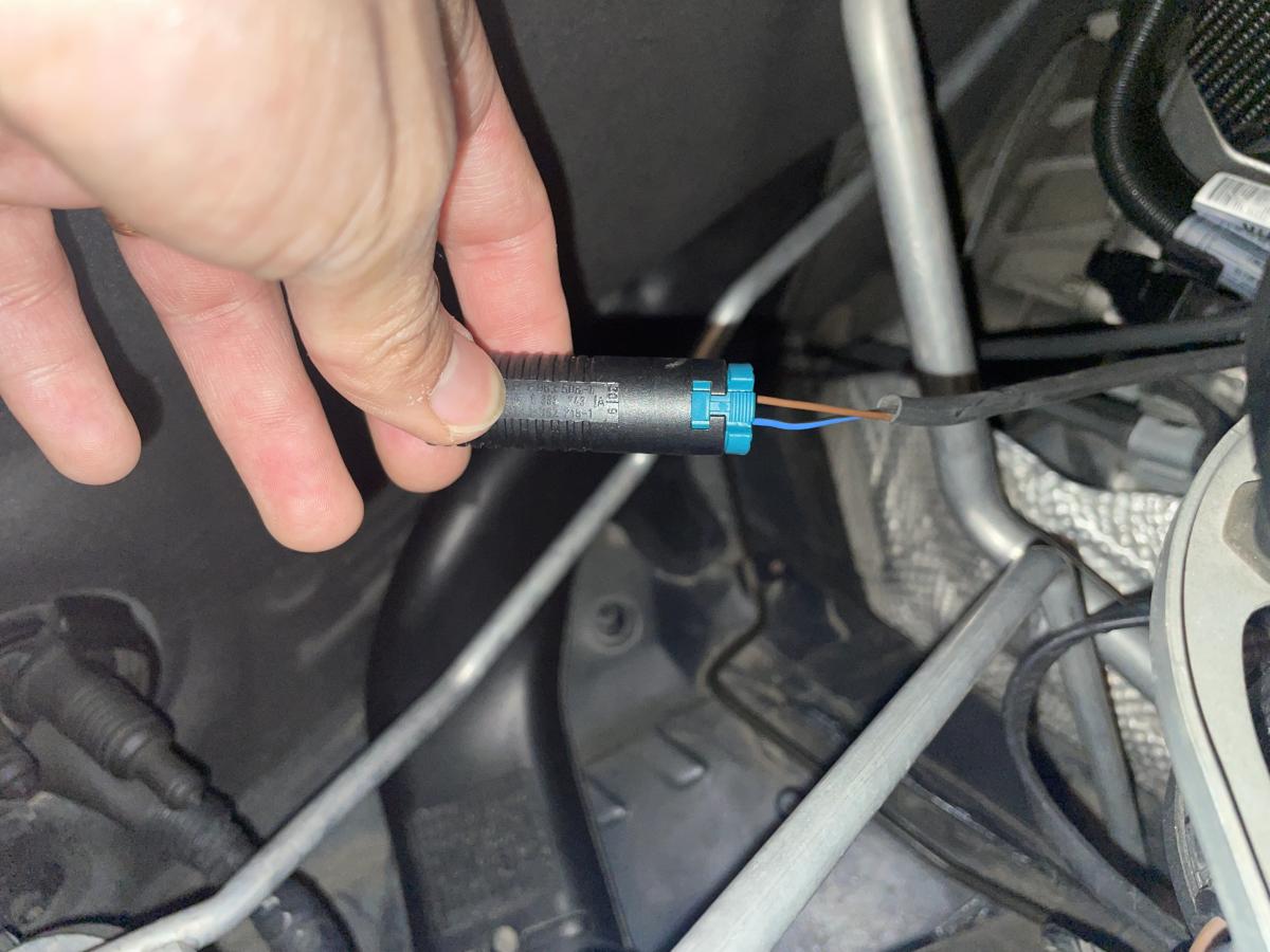

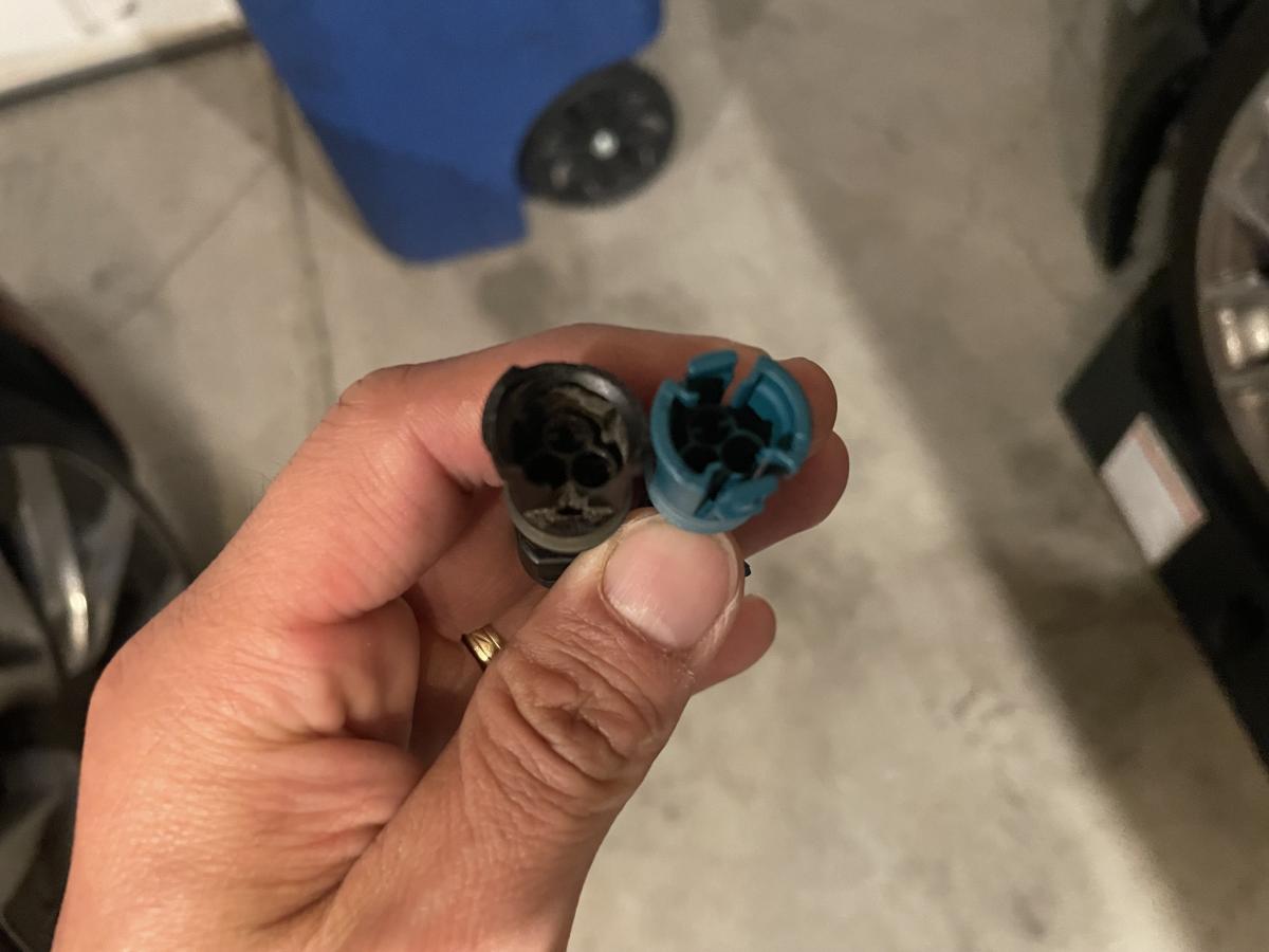

while working on my car I ripped the EGT sensor and on top of it I manage to break the engine side connector, it was too old and it crumbled on me.
so I searched for the connector part number for the EGT sensor but did not find it, however while searching RealOEM I found that the speed wheel sensor was very similar so I went ahead and bought it.
part number is:
https://www.fcpeuro.com/products/bmw-universal-socket-housing-uncoded-2-pol-61131392246?ads_cmpid=21618870943&ads_adid=1748984 20748&ads_matchtype=&ads_network=g&ads_creative=71 0518540727&utm_term=&ads_targetid=pla-297546631617&utm_campaign=&utm_source=adwords&utm_ medium=ppc&ttv=2&gad_source=1&gad_campaignid=21618 870943&gbraid=0AAAAAD3np3UtC4br7hfEfLez5nD1frQxW
and it indeed is the perfect replacement!
