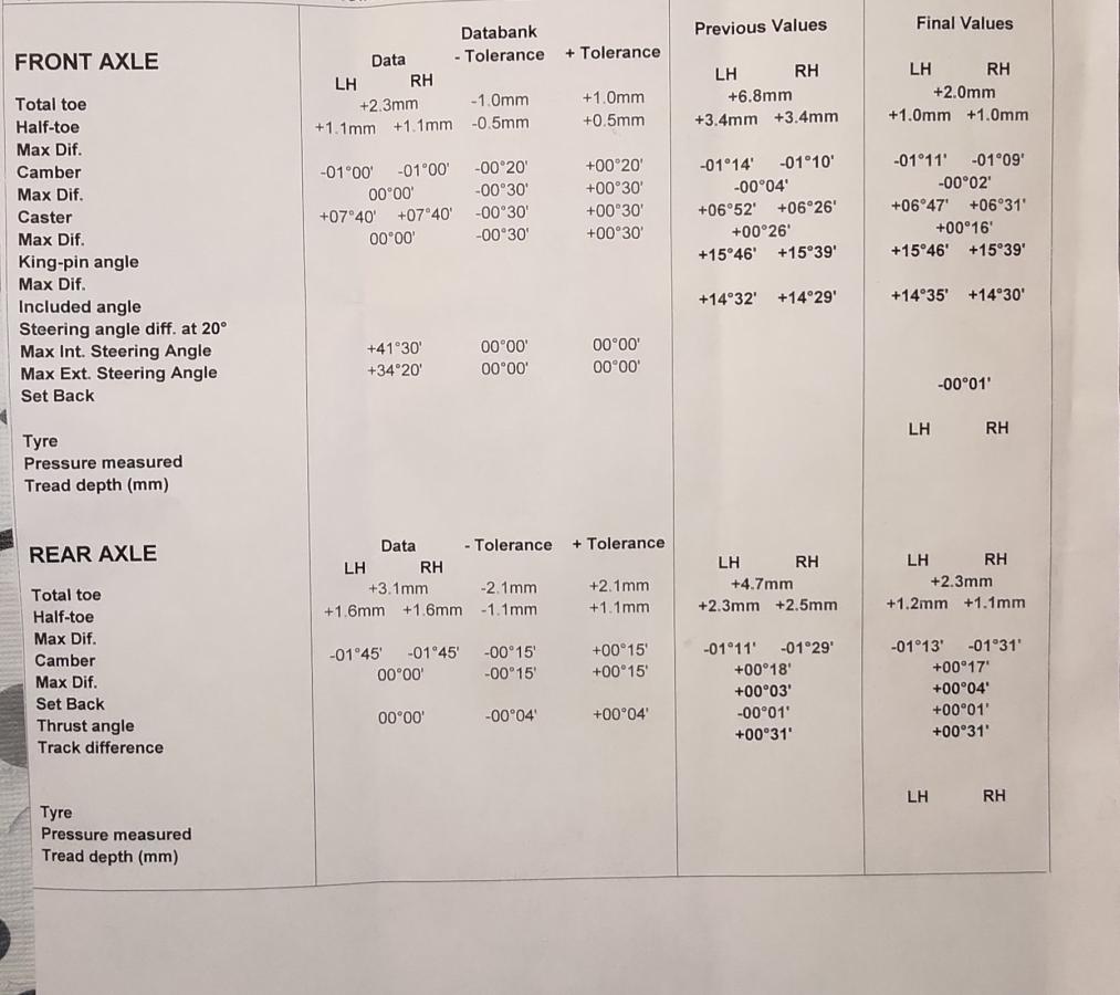

    I needed an alignment after raising the car back to stock height and new shocks,
    I assume from the report, the shop missed the castor angle alignment?
    Just need more info, before making another booking

        DataBank calls for 7.4 degrees and mines circa 6.4?
        Should i replace the front control arms ?
          Thanks for helping me out

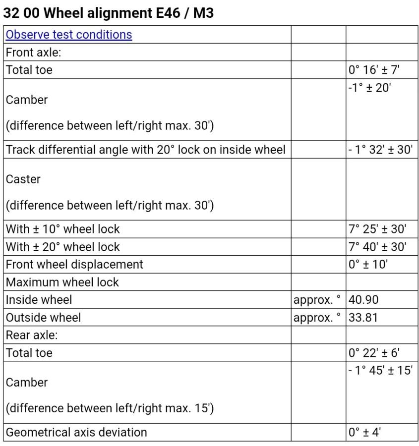

                          The smaller range of wheel lock is 7.4 deg
