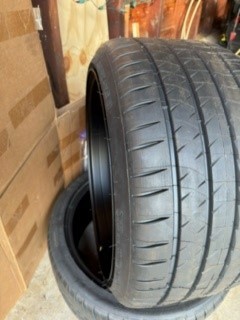

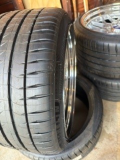

    285/30 PS4S on 19x10.5 wheels. Is it just me, or do these tires look stretched a lot more than they should be? I'm beginning to think the barrel sizes might be wrong
    What do the barrels measure as?
      It was supposed to be 7.5 barrel and 3 inch lip
        If you measure the end result what do you get?
          Haven’t had a chance to yet, wheels and car are at detailer. Going to measure tomorrow
            Ahh gotcha :-)
              I run 285 ps4s on 10.5" rim and yes they are, unfortunately, pretty stretched. I wanted a meatier look, but going up to 295 will have me down from 35 profile to 30 and it will look even punier. And ps4s is a fairly chonky tire as is. Oh well.
              Look at the stats and 285 ps4s is barely any wider than 275. Like why even bother.
                What I was afraid of. I spec’d the wheels based on my old apexes that were 9.5/10.5 and 255fr/285rr, Pilot Sport AS/3 and they were not as stretched. My problem now is that the fronts are square and the rears are stretched. I’m probably going to have to spend more
                money and rebarrel them
                  And is 295/30 too tall?
                    not sure, I thought 285 was widest I could go w/o clearance issues

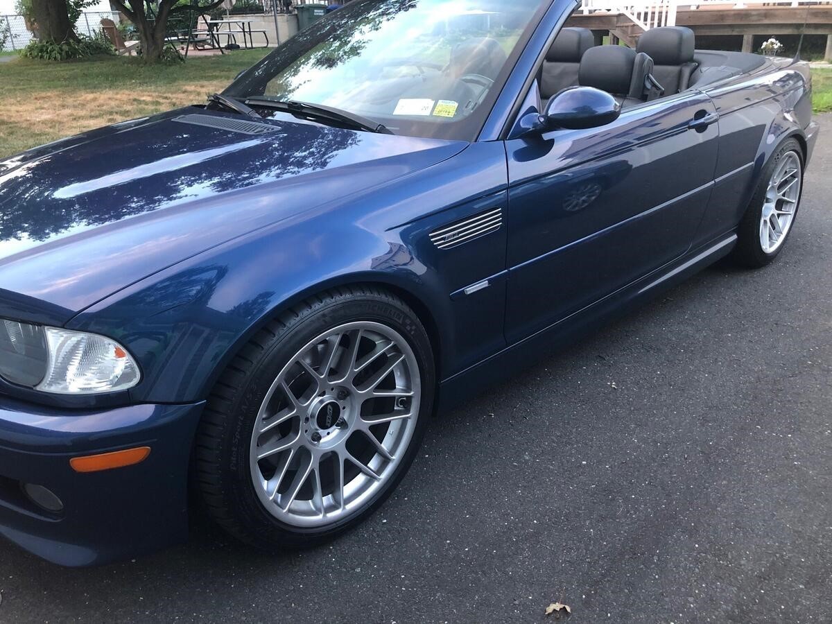

                        Front wheel, 255/35 on 9.5 wheel. Before anyone says anything, I know, I shoulda went w larger lips...

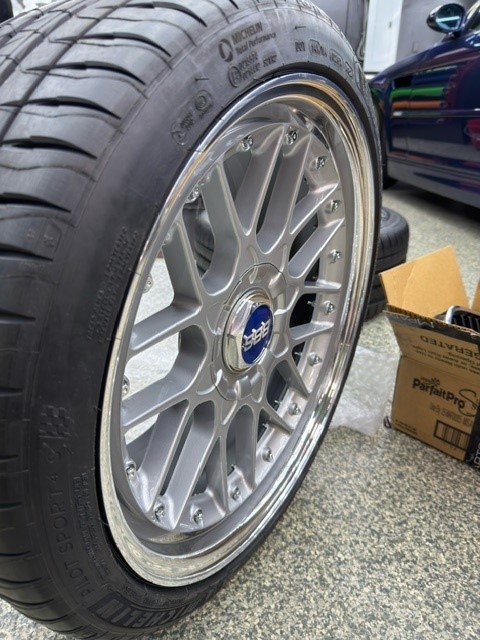

                        for reference- same width wheels and tires, but in 18'
