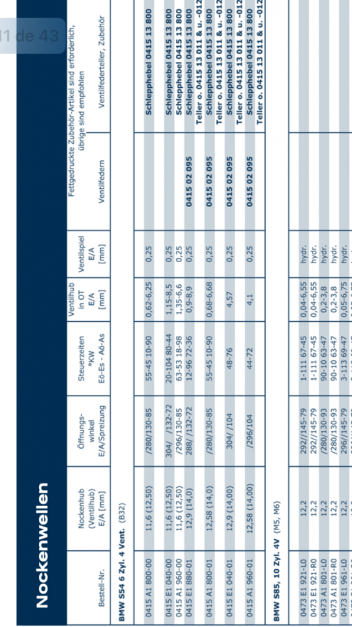

                        What’s the intake & exhaust valve clearence with Schricks 280/272 camshafts? I read 0.0098’’ but is there a +- tolerance??
                        Stock it’s between 0.007-0.009’’ for intake and 0.011-0.013’’ for exhaust side? So I was wondering what is the tolerance with Schricks cause no way it will be bang on!!
                          What's the intake & exhaust valve clearence with Schricks 280/272 camshafts? I read 0.0098'' but is there a +- tolerance??
                          Stock it's between 0.007-0.009'' for intake and 0.011-0.013'' for exhaust side? So I was wondering what is the tolerance with Schricks cause no way it will be bang on!!
                          If you go to the Schrick website and download the data sheet for the cams it will be listed there. The lash spec is different than stock cams.
                            I just assumed same tolerances as stock. So 0.009 - 0.011
                              I did look before posting and it says 0.25mm or 0.0098’’.
                                I did look before posting and it says 0.25mm or 0.0098''.
                                I stand corrected. I remember the numbers were different but didn't recall the units. Apologies for the confusion!
