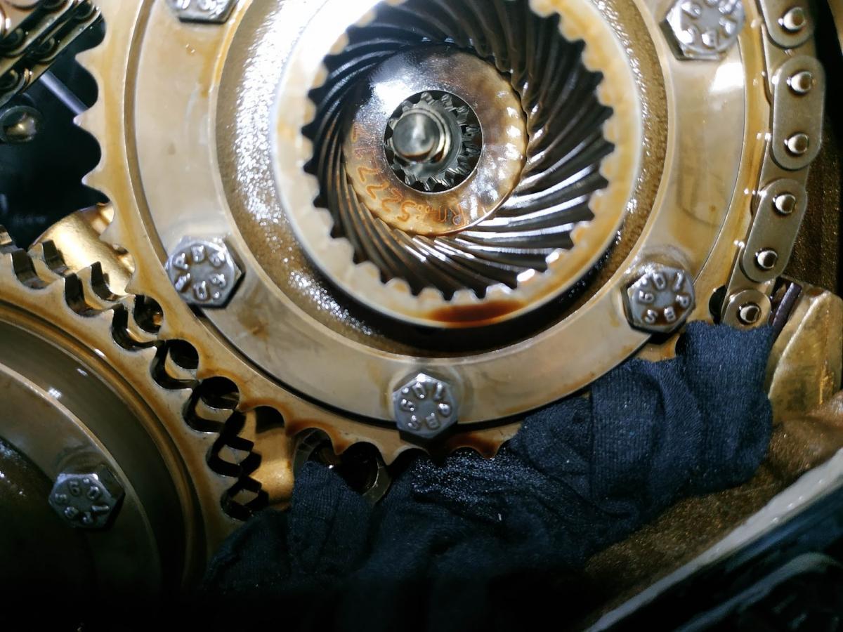

    Whiles at it, here is one i did which didn't have cut threads for oil relief valve. These cams were also off past their maximum target.
    P.S. I have new set (Never installed) of 288/280 Catcams for sale if anyone wants them for Cheap.

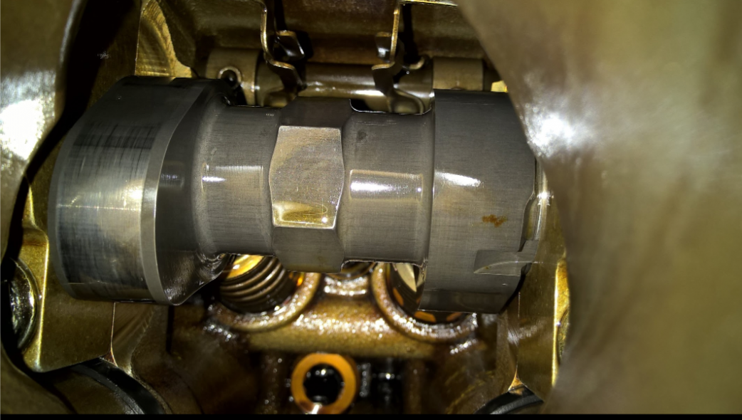

      what i posted is what I've experience on old rocker shaft with new cams. As you can see in the posted picture, it turn out to work great.
      i service other s54 "track cars" that used that break in process.
      They are on Schricks 288/280 with old rockers. I'll grab pics next time they are in for service.
      Funny enough catcams actually suggested that recipe for installing their new cams and rockers with oil bridge.
      if you have experience with other minerals oil share it.
      Here is a close up picture of the lobe wear following that process on old rockers after 35,000km
