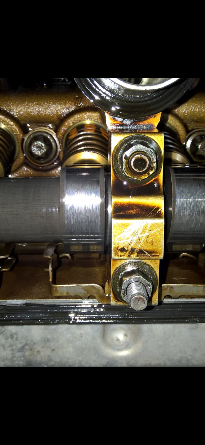

          3000km service after new cams and followers. Didn't see any sign of abnormal wear whatsoever but did notice gunk in my oil filter. Wonder if it's leftovers from the assembly lube I used. Interestingly the clearances were all slightly larger than when I did the install over winter so I reshimmed all valves.

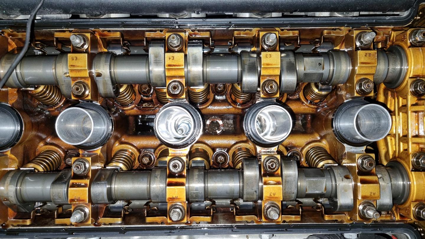

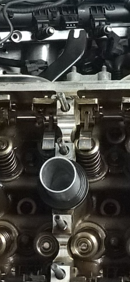

                      attached are pictures of schricks 288/280 running 35,000+km. Oil changed religiously at 5k.
                      Rockers have well over 200,000km.
