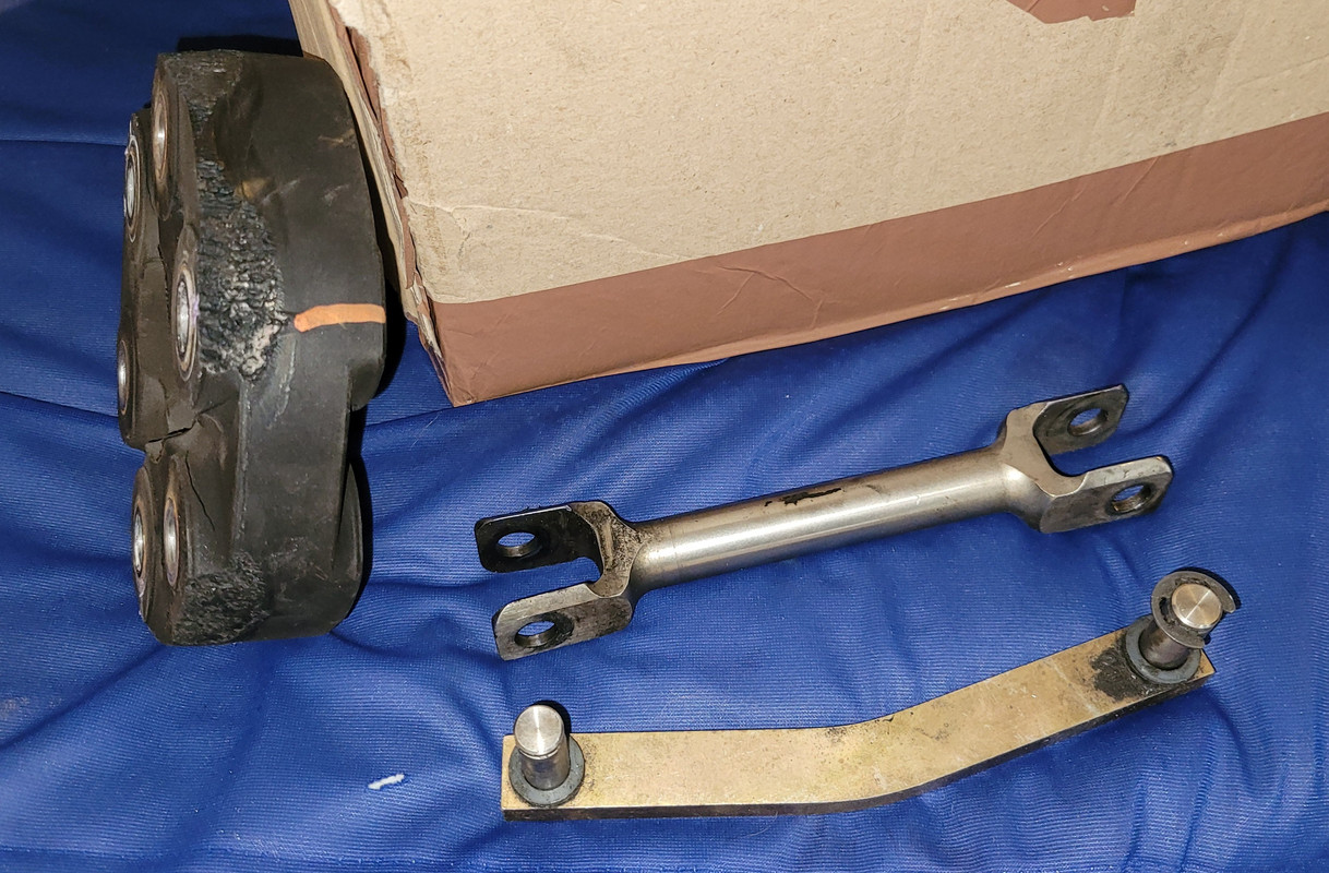

              Thanks for the replies. I had forgotten that i do have an SSK fitted. It is an older Rogue Engineering SSK. I also have the UUC DSSR rod installed. This combination has been fine for a few years. It was pointed out to me that because the UUC DSSR forked rod is straight rather than kinked. It can slightly catch the guibo during a gear change. I have had no issues with this set up though.
              The gear change works ok but on start up, after backing off the drive and selecting first gear. It sometimes won't release first gear to select second gear. This only started very recently. Everything is fine after a few hundred yards. The weather is not cold. Could this be gearbox spring and ball related?
                Well this is why you need a cranked control rod in your gearchange, at least with an SSK you do
                The corners of the guibo/rubber coupling have been rubbed off.
                  how would you drive with it that way long enough to wear the guibo down that much is wild...
                  I just installed an AS AutoX and have that much play as well. I actually think the poly rear slip joint may increase the side to side
                    It only rubbed during changes and so has lasted for at least 3 years!
                    The Rogue Engineering control rod is in now in, along with a new guibo, new clutch (LuK) and new gearbox and diff oil.
