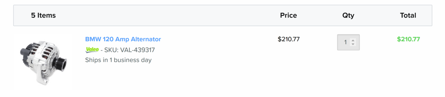

          This is the one that I got. Looks like FCP doesn't offer it anymore though. I see a number of ones available elsewhere - Valeo, Bosch, and Remanufactured BMW. Is the latter what you are referring to?

            Yes.
