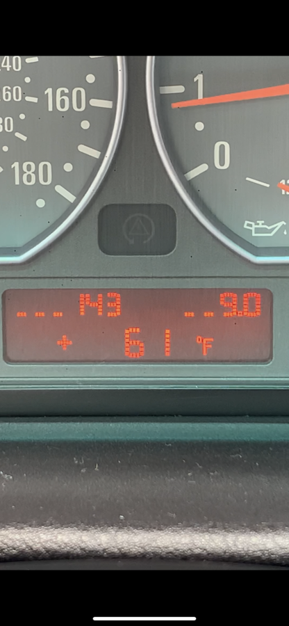

              Checked my battery and alternator with the self diagnostic that's built into the car. They both had a healthy reading. I drove the car around today with no issues but still a bit paranoid what the problem can be as I'm unsure when it will happen again. Is it possible that sometimes the serpentine belt slips or something causing these symptoms. Pretty unsure at this point. Attached is an image of the of the alternator reading.
              Thanks in advanced for any other suggestions. I might just need to end up taking it to shop.
                I didn't see this explicitly mentioned so thought it would be worth asking. Does the engine die when this happens?
                  When my alternator failed, I had no warning until my instrument cluster lit up like a Christmas tree, motor started missing big time as well. As luck would have it, I was just down the street from my indy, pulled into the lot and it literally quit right there on the spot. Had to push it into the bay.
                    Combination of heavy steering and alternator light means your accessories aren't being driven adequately by the belt. Either the engine is stalling (maybe a vac leak or frozen ICV when you come to a stop and put in the clutch) or the serpentine belt is slipping. But the red oil light points to the former (since it's driven by the crank.)
