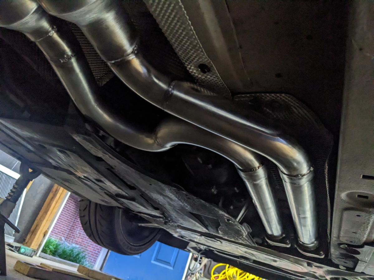

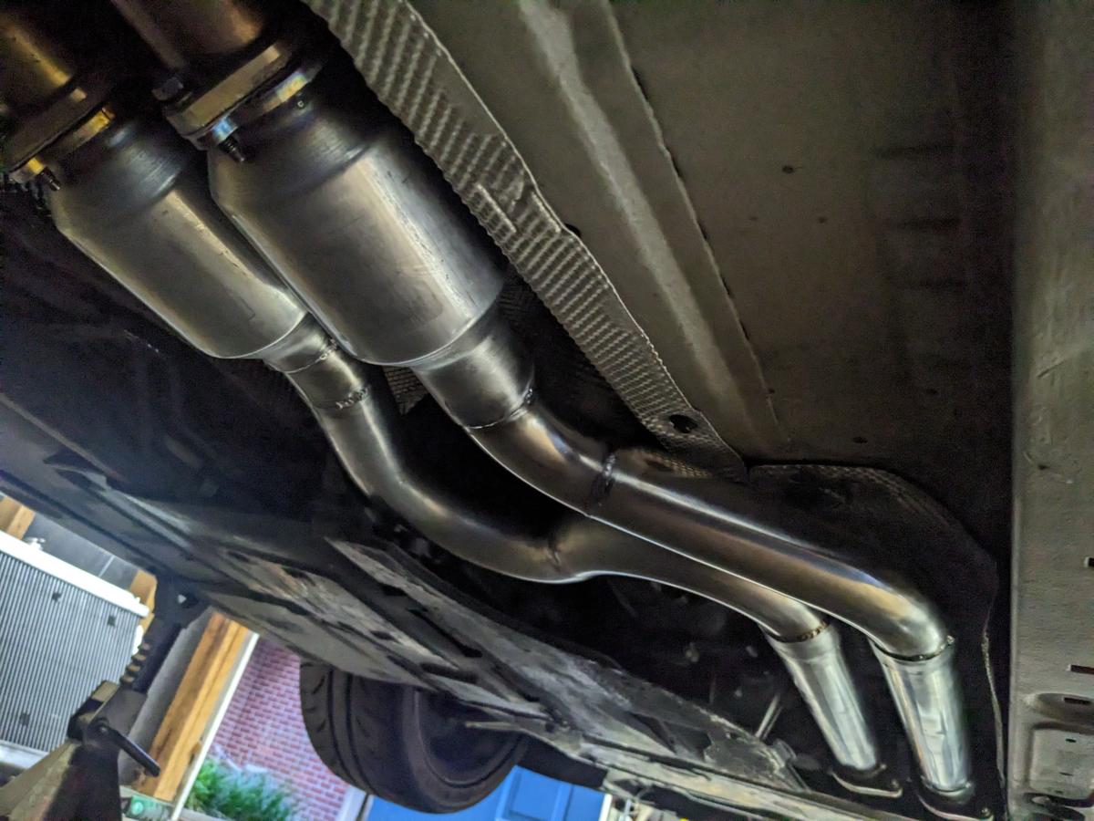

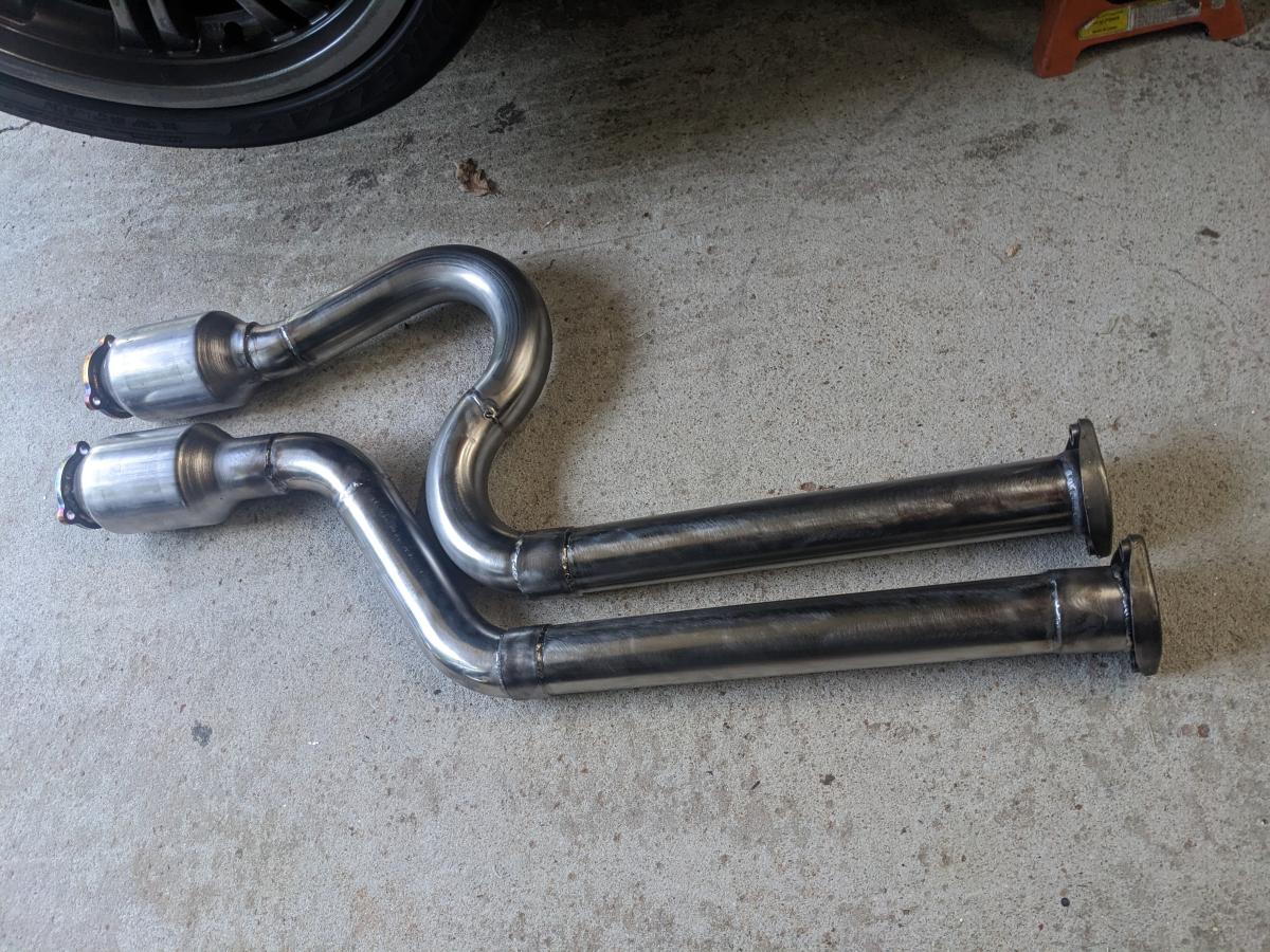

          I tend to agree. I built an equal length 2.25in section 1 a few weeks ago with Catco 400 cell cats. The sunbeam stuff appears to be 2.25in (57mm) as well.​ I think it sounds really good but it's very similar to a euro section 1. A CSL airbox is much much louder from the driver's seat.
