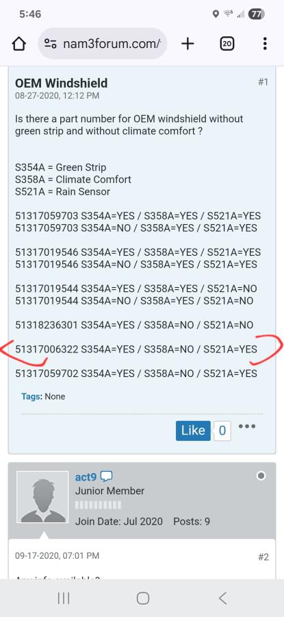

                              Can someone please help me confirm the CC glass P/N for my car (JR21219)? My car is w/ rain sensor, auto lights and I guess I"m just "slow" in that I am unable to interpret RealOEM.
                              It seems that I would need 51317059703​ whereas others here have ordered 51317019544​
                                #75
                                Disregard the red marks, thats the P/N for what my car had from factory.
