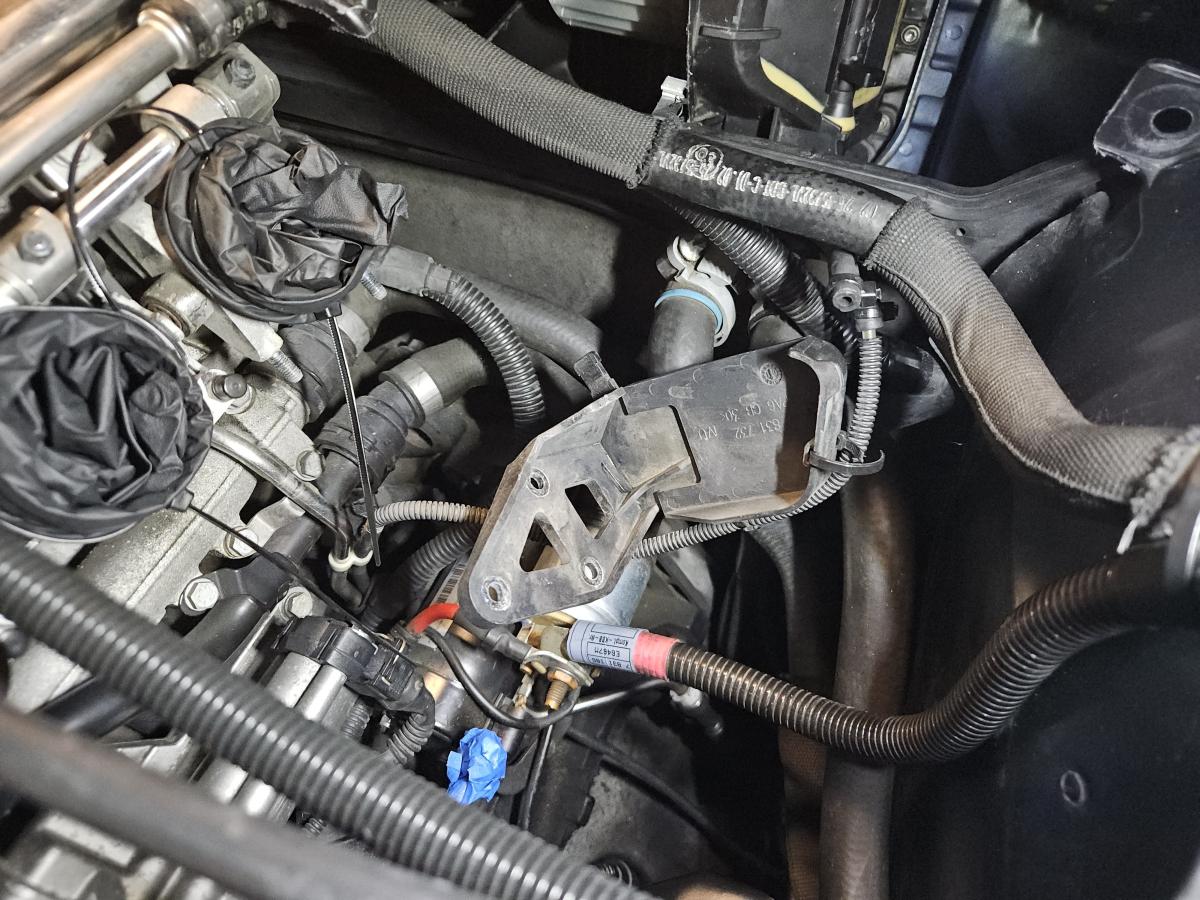

    This plastic bracket also has to be moved out of the way:
    There's three 10mm nuts under the cylinder 6 throttle body holding it in:
    It also has a tab that holds the injector loom. Separate the two (and don't forget to reattach when putting back together!).

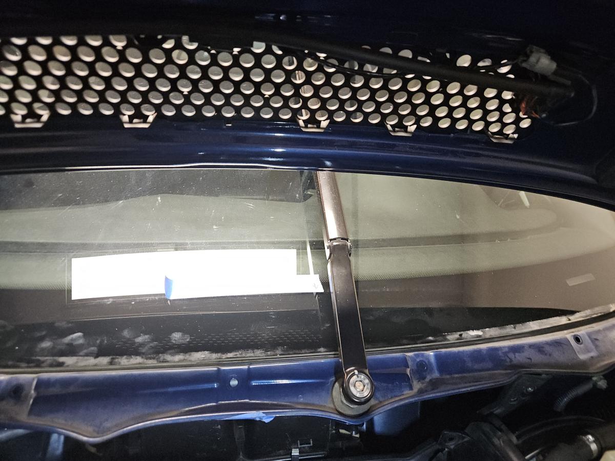

    Lastly, the windshield wipers need to be pointing vertically:
    Do not try to move them by hand. Turn the ignition on, pull the wiper stalk and turn the ignition back off halfway through the wiper's motion.

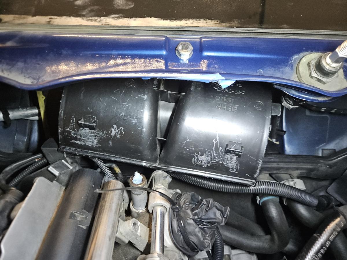

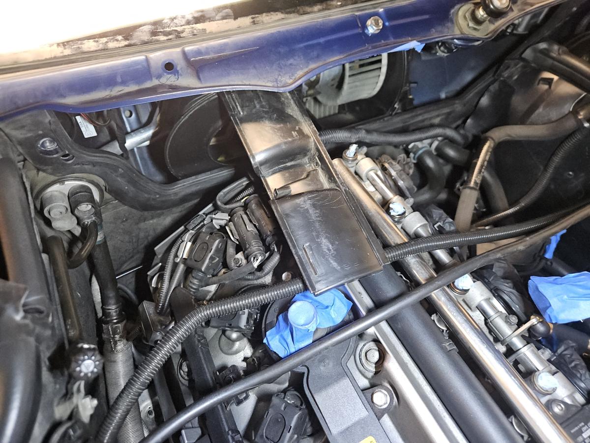

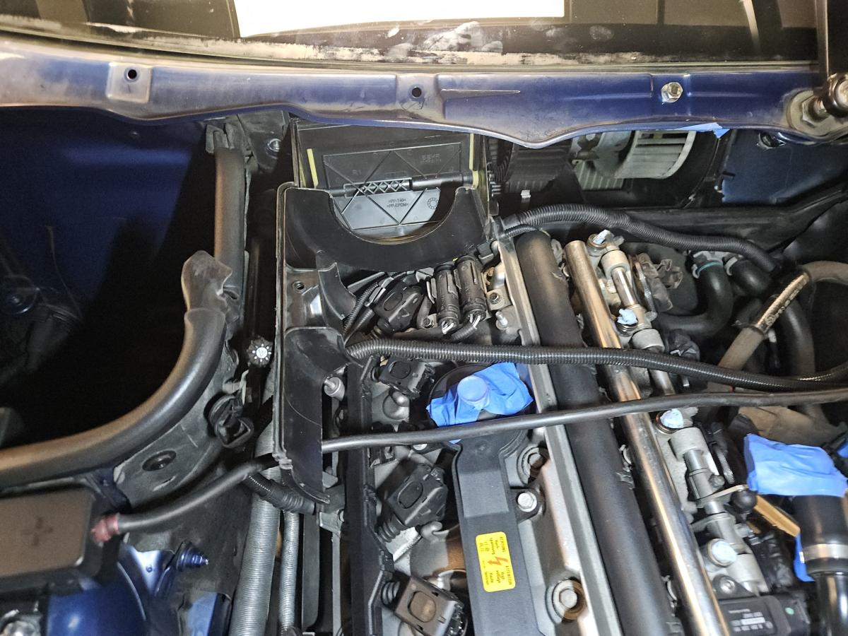

    At this point, your engine bay should look something like this:

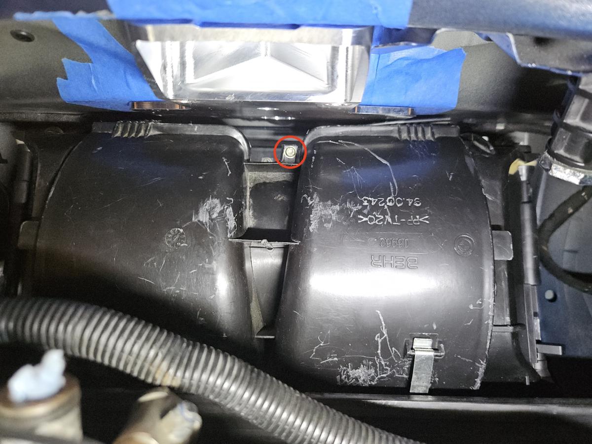

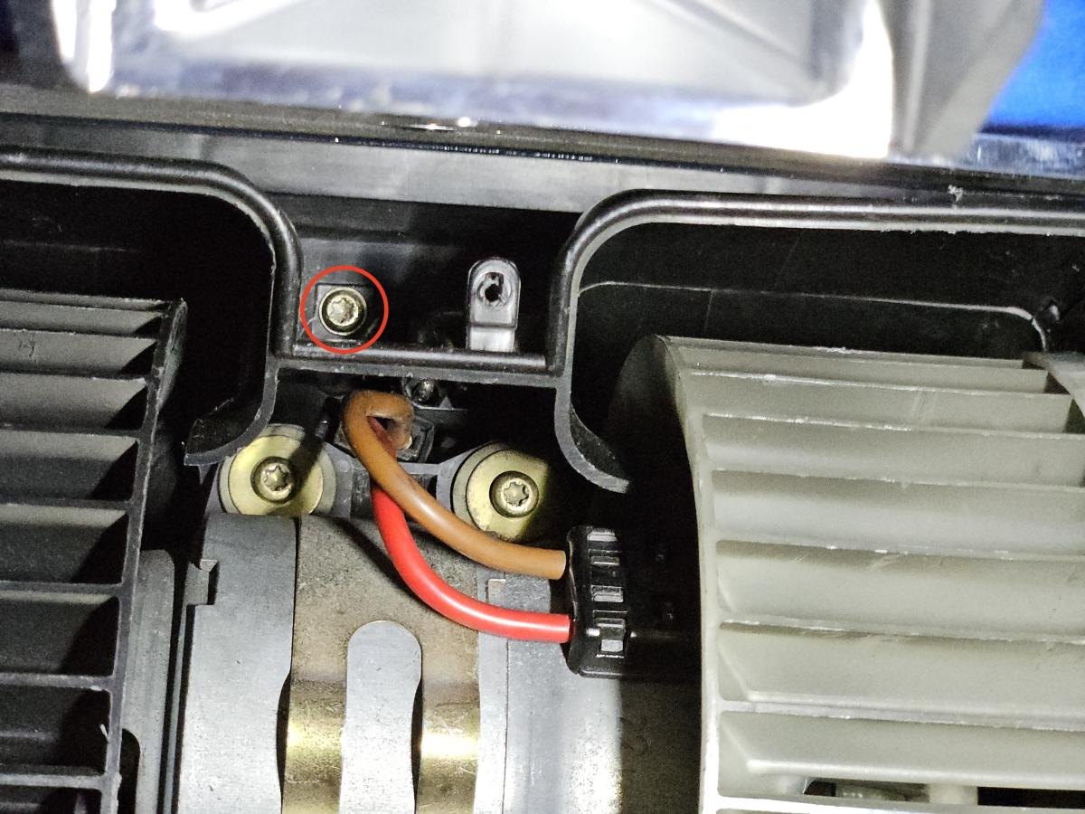

    Step 1: Remove the top T20 screw on the blower motor front cover.

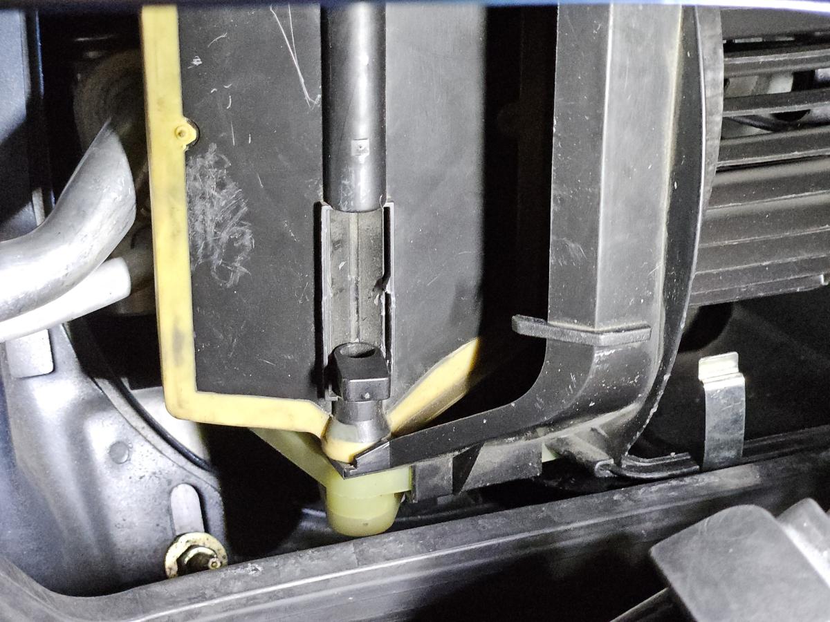

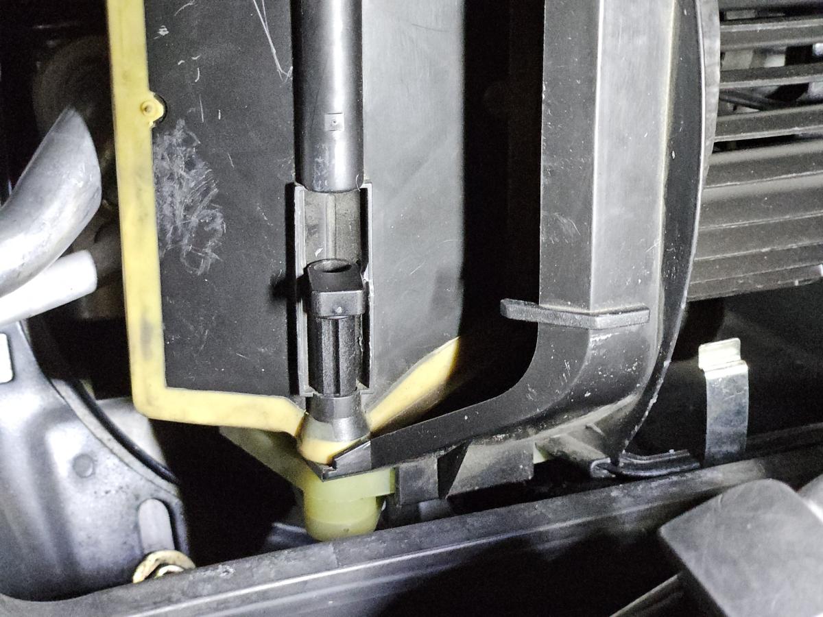

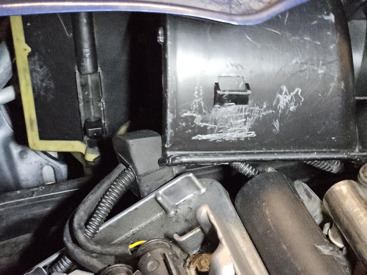

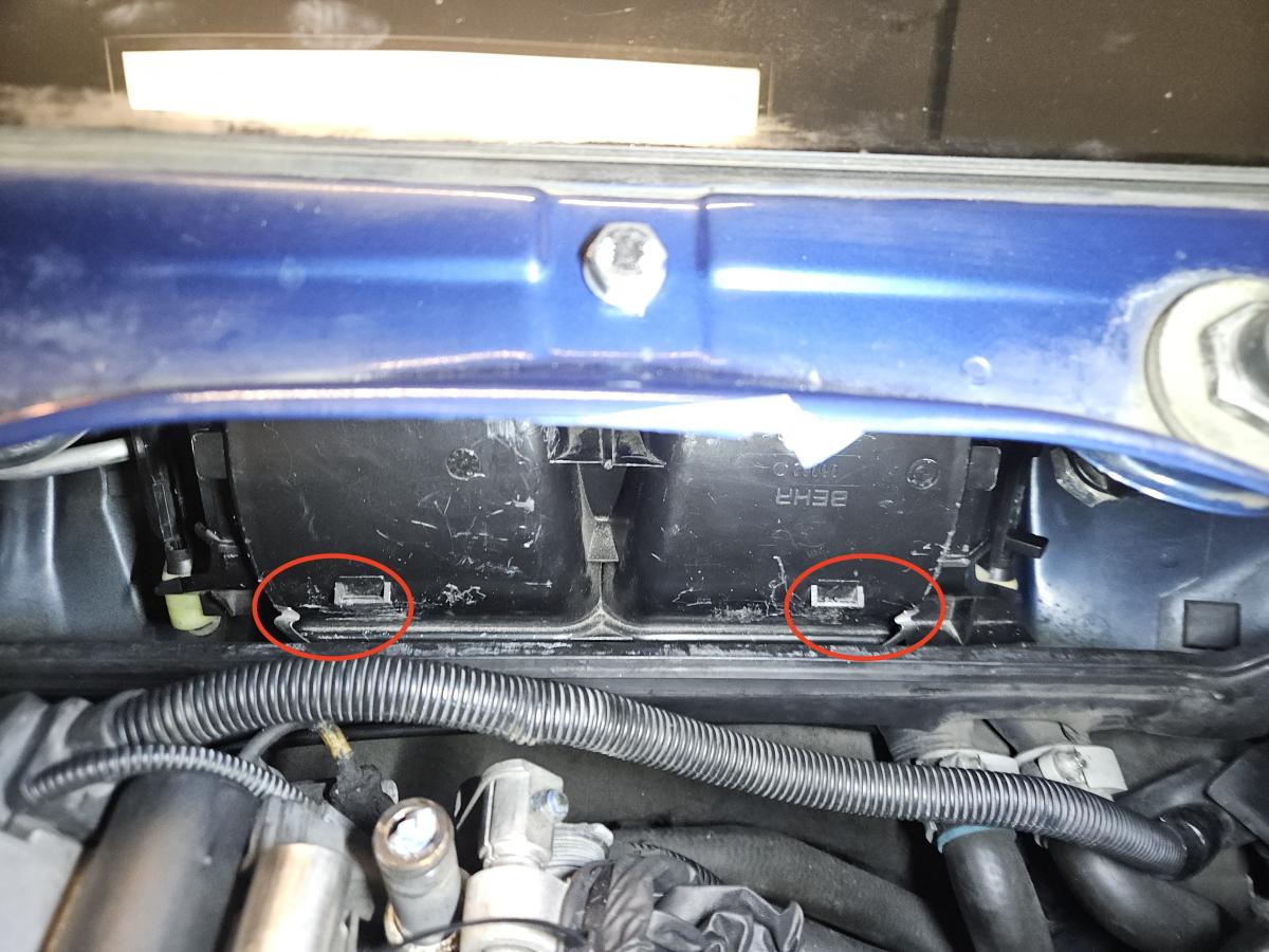

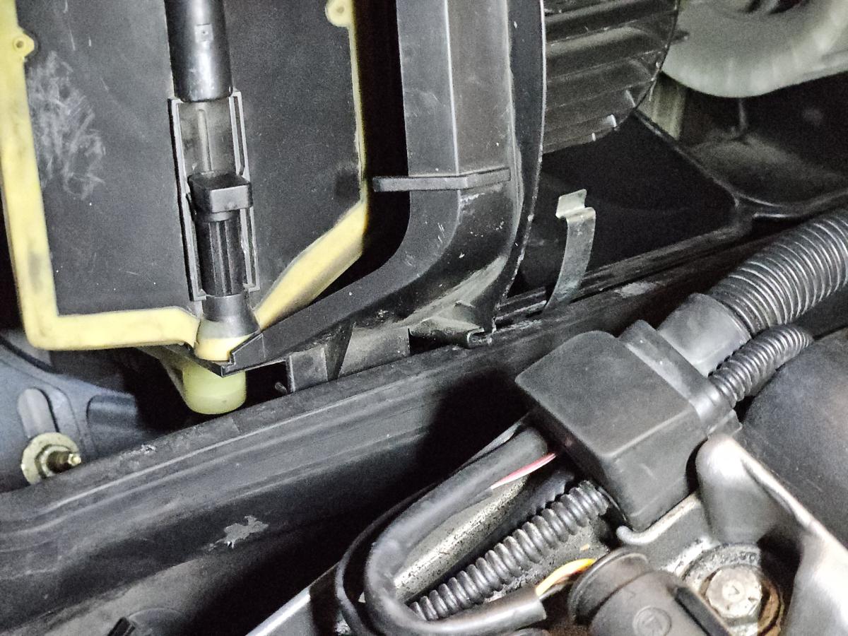

    Step 2: Undo the two clips at the bottom of the cover and push both of them to the side.
    Step 3: Pull the bottom of the cover out past the firewall. It'll want to catch on the clips and the firewall, but it does clear with a bit of bending. Moving the engine harness out of the way also helps with clearance.

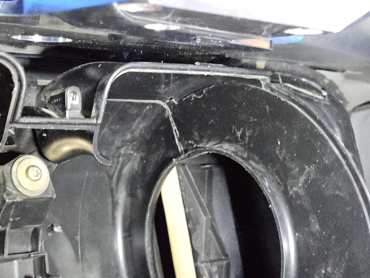

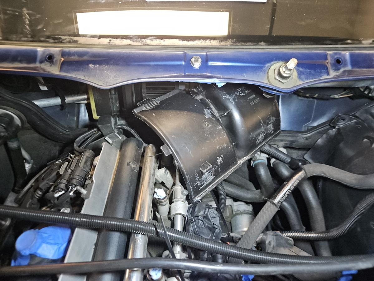

    Step 4: Keep rotating the cover and pull it out on the intake side.

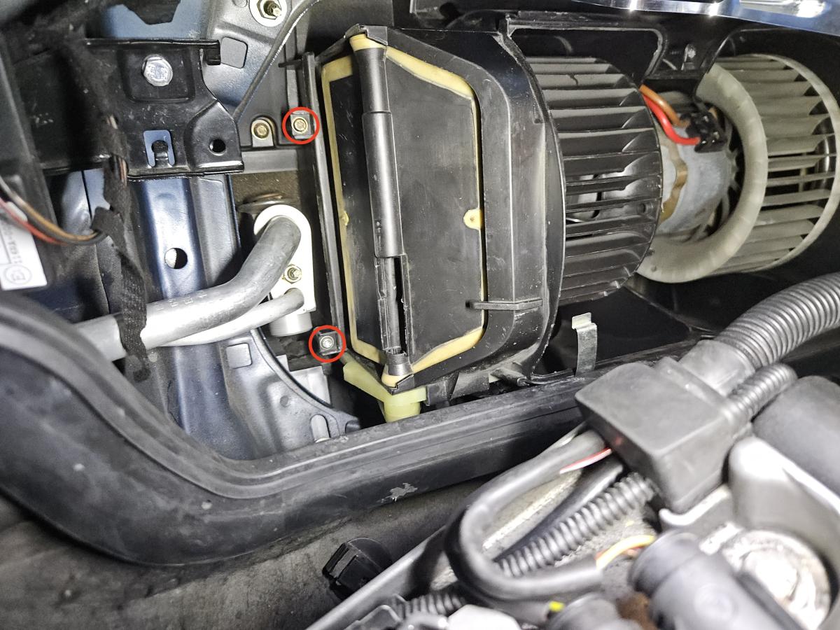

    Step 6: Remove the other two T20 screws holding the right flap assembly in.

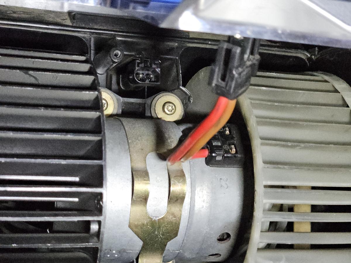

    Step 11: Unplug the blower motor.

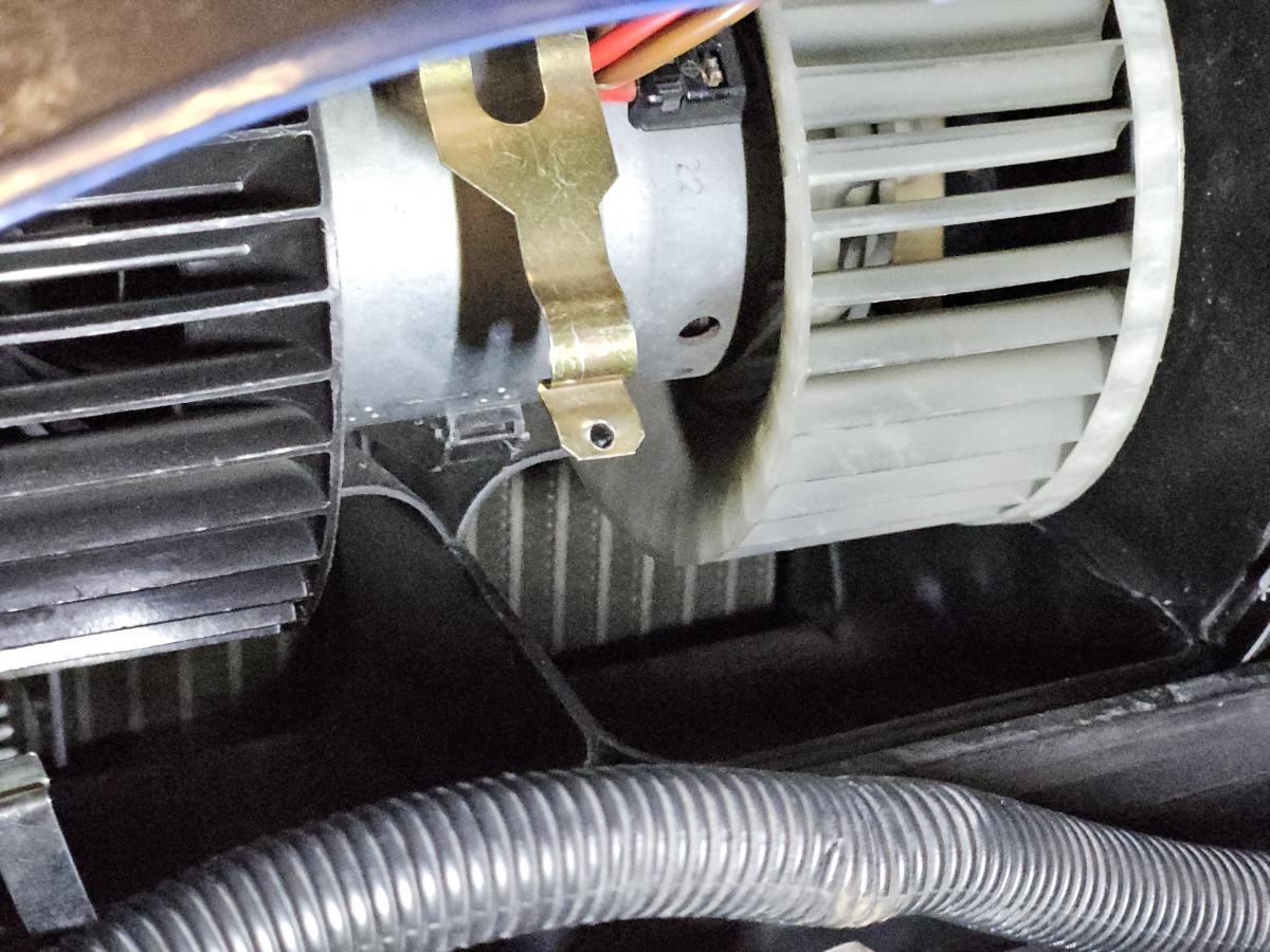

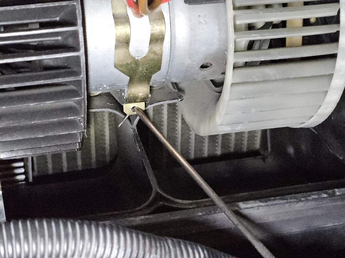

    Step 12: Unhook the blower motor retainer.

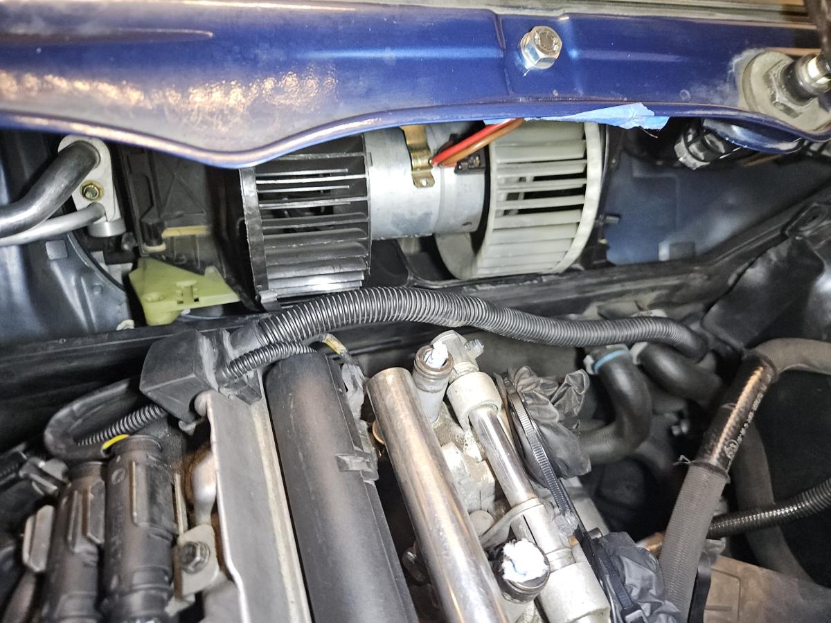

    Step 13: Pull the blower motor forward out of its bracket.

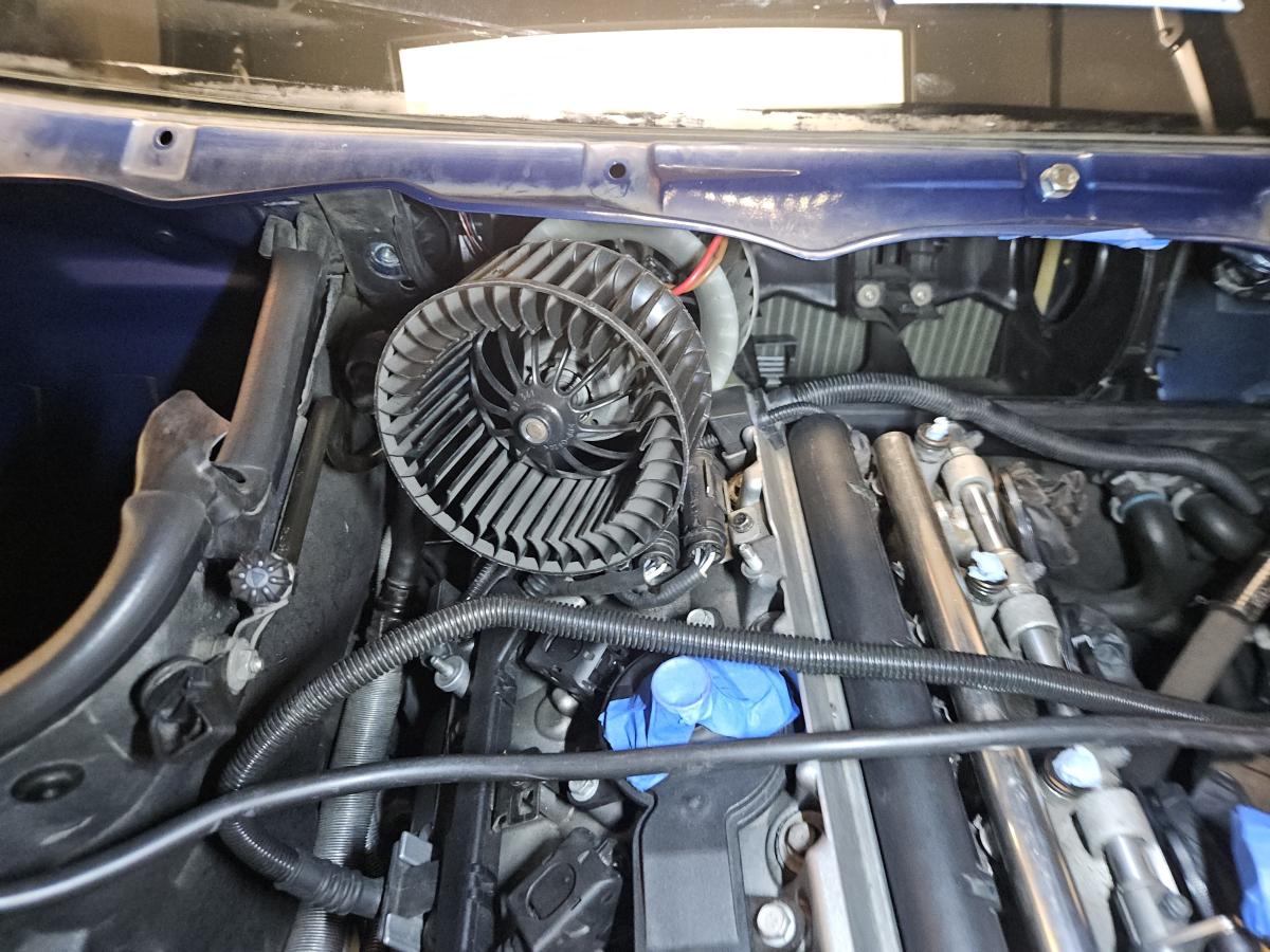

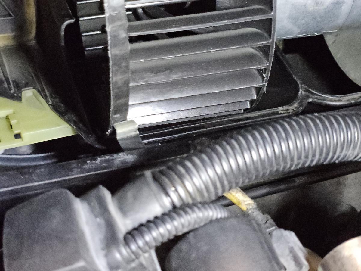

    Step 14: Carefully pull the blower motor out through the exhaust side. Be careful not to damage the vanes with the front cover clips.
