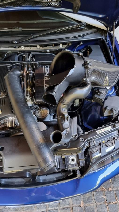

                    My car with an OEM CSL intake was on an Alpha-N tune for years, from 2010 to 2022, and to be quite honest it was a bit of a pig. I knew it had some tuning 'problems' but just endured it because of that glorious CSL intake/Supersprint muffler combo. In 2022 I decided to make the switch to MAP sensor tune and the difference is night & day. The car is more refined, smoother, no jerkiness & other crap, fine at very low speeds and so immediately responsive now. It's far more pleasant to drive, I wish I had never gone with the Alpha-N tune, maybe that's all they had back in 2010, I can't remember. I also went through 4 different mufflers trying to get the intake/exhaust sound I wanted before I finally settled on the Supersprint, I personally think it's the best muffler for these cars also, again just my opinion.
                    Anyway, ditch that Alpha-N and switch to the MAP sensor tune. Trust me, your car will be bloody brilliant after that. Honestly the difference between Alpha & MAP is night & day, I'd switch to MAP before changing your whole setup. CSL intake with MAP sensor tune is THE best mod one can make to these cars imo. If I was buying another E46 it would be the very first mod I'd make to the car. 👍👍

                      strange the OP feedback, but we are all different. one thing I can understand is the drivability of the MAF setup, is tough to beat. the Z4M is less sensitive to it, but I can attest that MAF v Alpha-N is indeed different, being MAF much smoother and hiccups free. however, the noise is in a different league, not only volume, but the quality of the sound.

                            Since I have a pre 2003, I would need a new computer right? What would be the steps to change it to a map sensor tune from an Alpha N? Don't I have to do something with the fuel pressure rail or something, pin my ECU and stuff?

                              Which Supersprint exhaust?
