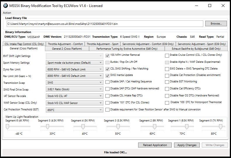

    FYI you can use Martyn's tool to force cat, evap and oxygen sensors to ready and avoid all the drive cycle shenanigans. Just breezed through CA smog this way.

      oooo I have Martin’s tool. Where can I get that done in the app? I don’t see that option. Right now my Cats are the only thing not ready. The only part I see is to disable the cat efficiency and I need to enable it.

          In my case I enabled:
          Disable SAP DTCs
          Disable Cat Efficiency DTCs
          Disable Rear O2 DTCs
          After that basically everything went green on the first cold start once the SAP ran through its startup sequence.

            Oooo I get it now. So the DTCs are when it shows as “not ready” or “ not complete”
            so if you disable it, then it will show green?
            Why isn’t everyone else talking about this then and still going through the drive cycle?

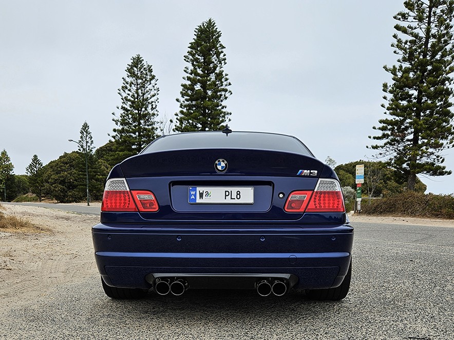

              Which Supersprint exhaust?
              Supersprint Sport, this one here.

                Not everyone has martyn's tool/a laptop set up for diag. At least that was me for the longest😅

                  So would the procedure be: back up my current flash, then load it into Martyn's tool. Then just click on
                  Disable SAP DTCs
                  Disable Rear O2 DTCs​
                  and after it flashes and I start the car, it should all be green? Mind you this is on a car with all OEM US headers.

                    Yep that did the trick for me. If I remember correctly, I let it idle on the first cold start for ~1min to allow the secondary air pump to run (as prescribed in the drive cycle) and then that code set to ready as well. Evap won't be set but that's the one code that's allowed to be incomplete per the regs.
