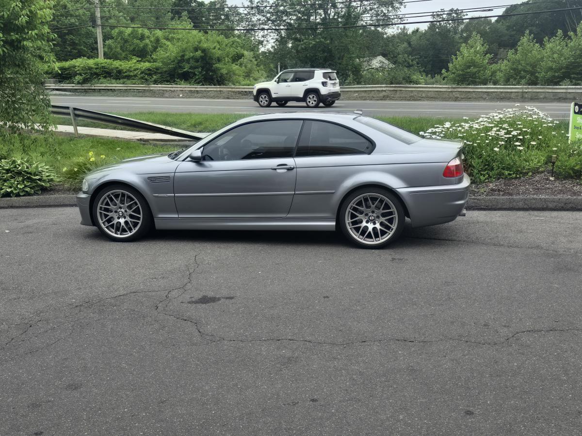

    Hey Fellas,
    So just need some quick opinions. Ive recently purchase another M3 with brand new OEM suspension (under 700 miles on them). There is a guy that is parting out his car who has KWV3 with about $13k miles on them, who said he'd trade my OEM plus $1200. Ive never felt KWs so I have no baseline.
    I can also wait for a used set of Ohlins to pop up (usually around $1600) or get them new for about $2500. Ive never felt Ohlins do i have no baseline.
    Brand new OEM suspension feel surprisingly good... just high.
    Any advise?
