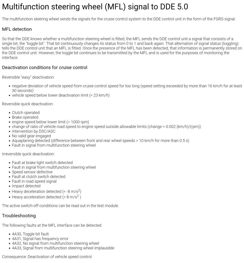

              I was just thinking it could be a replacement for the iDrive controller. Seems nice to not have to take your hands off the wheel to operate it.
              Found this the other day. Obviously not an E46 M3 document, but I would think it works in a similar way:
              So yeah, looks custom, but doesn't seem like it would be too complicated to reverse engineer. Can't be more than 5 or so distinct messages that the module sends out. Should be able to work it out quickly with a logic analyzer. Could even approach on the SW side and use karter16's DME disassembly to work it out.
              Since it's just an async serial protocol, you could wire it directly to an input on whatever ucontroller you're using and do all the decoding there. Practically no HW changes, just SW.​
