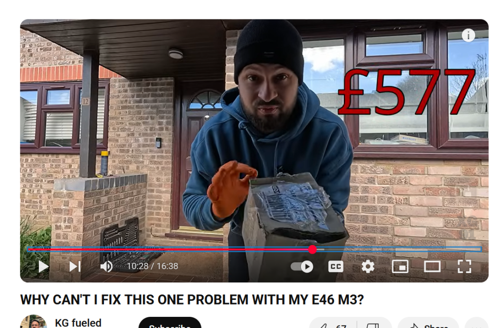

        This guy paid 577 Pounds for 1, 4 months ago
        Good insight how to and when to replace

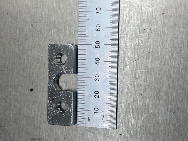

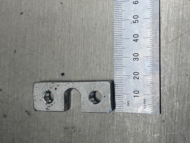

                      Sure thing. I just used a scrap piece of 6mm 6061 I had laying around. About 15 minutes with a drill, hacksaw and file to rough it out.
                      The holes are tapped for an M8x1.25mm bolt. Install the tool between the gear and bearing, thread an appropriate length bolt into each hole (I believe the bolts I used were 40mm in length), then press the bearing into place. It will bottom out ~1-2mm before it sits flush. The interference fit between the bearing and throttle housing isn't very tight, you could probably tap the bearing in place with a small hammer.
