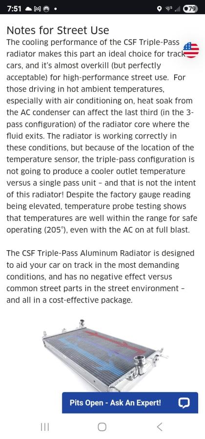

    Hello everyone, I have replaced the entire cooling system with a new csf radiator triple row however the past 2 days i have been seeing air in the system. Although live data shows 210 or 98c the gauge will be at the third dot. Considering my recent head job, is the gasket failing to provide a proper seal? I started the vehicle with the head job with this radiator? I am driving up to Monterey tomorrow night and just want be sure I will not blow up the engine! keep in mind this only happens with ac on; and very minor air bubbles not big ones!

          I did bleed it with the front end up multiple times, if I'm cruising on the freeway my temps are 188, but when I'm stopped it goes up to 204 sometimes it will go up to 210 when I shut off the car and start it up 5 minutes later and after that it will cool down to 205! If I drive without AC the car is perfect they gauge does not move at all! I did use vacuum bleeder! I feel like the flow on idle is very weak so it does heat soak the radiator!

            can't speak for the bleeding part, but as far as temps - I run a CSF and see similar temps when driving around in the city (i'm in the LA area, and temps out here this week are hot). If you're not used to the CSF it does amazing when it's getting clean airflow, however when there isn't any flow (moving but stuck behind cars, or sitting in traffic) it tends to heat soak.

              Apparently that's the design of the radiator that can cause those Temps especially with AC according to bimmer world thank you everyone for the advice

                    resolved replaced with oem and I have normal temps now even with ac and 100 degree ambient temps!
