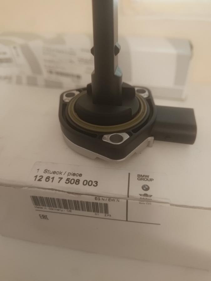

                Sprung for genuine from what looks to be a Range Rover Dealer > LINK
                Legit Seller, Mine Arrived. Last one you will get at this price i think, Better be quick

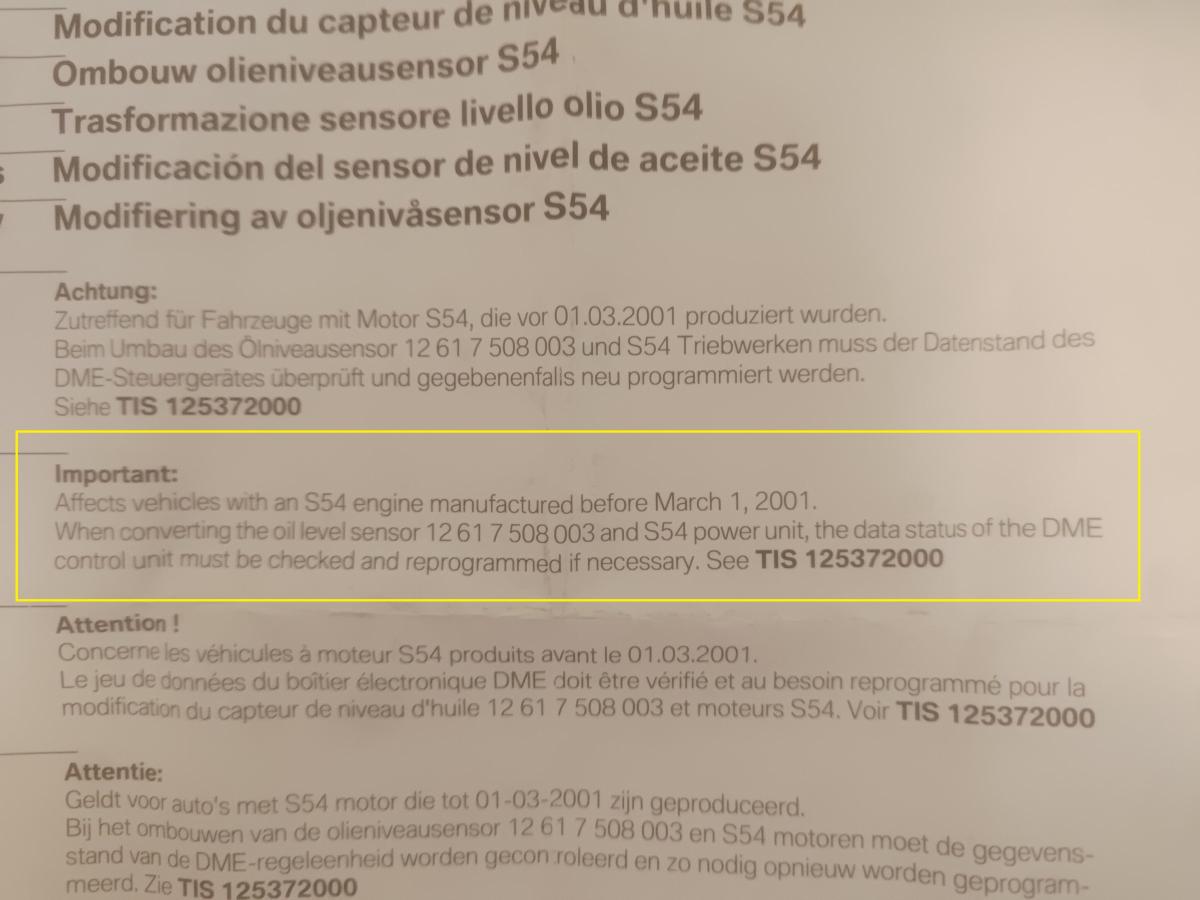

                Heads up if you have a pre March 01

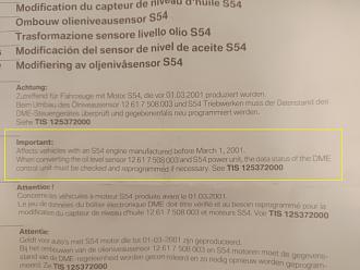

                  Do you have any more info on this? I have an early model with a replacement hella unit. Couldn't find this on TIS. Don't know if related buy mine is pretty finicky.
