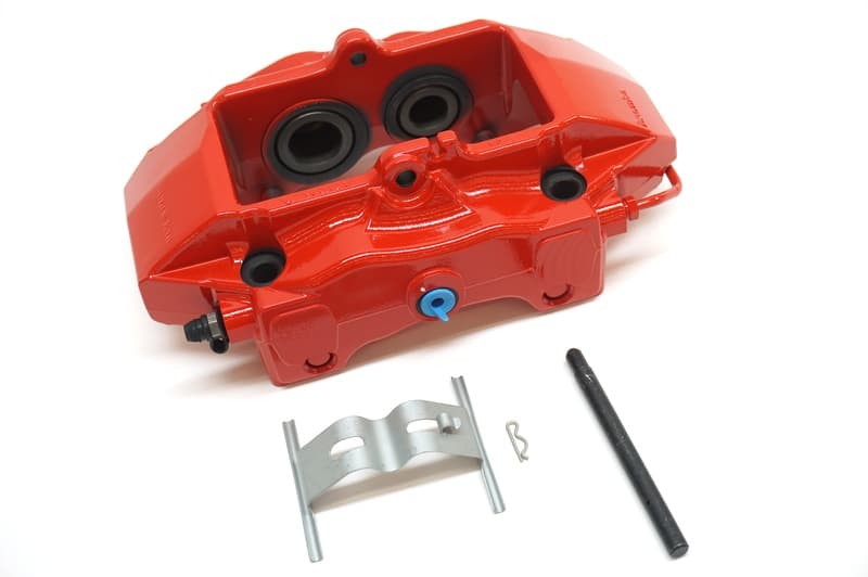

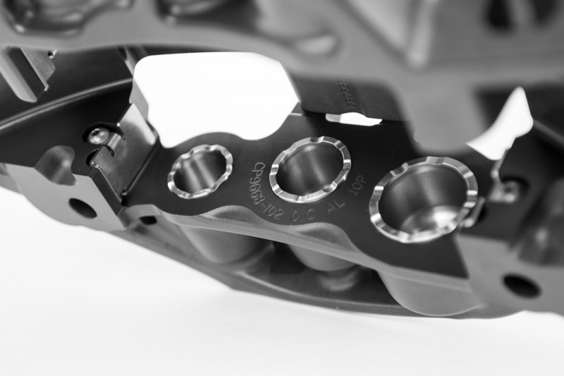

                          First point- if you're using the same ZCP rotor, you are limited by the dimensions of the friction surface. You can't really increase swept area, unless you get a long, curved caliper with a matching pad. 996 pads are rectangular and somewhat tall, so not the correct shape to increase swept area over the stock caliper. My point is, you're not effectively increasing swept area with the 996 setup- measure the swept area of the 996 pad versus the stock pad. I don't know the exact dimensions and don't care to look it up, but swept area is your limiting factor here.
                          Second- it's not an "imaginary barrier" that insulates a piston. If you look at a proper motorsports caliper's pistons, they are designed to prevent heat transfer from the pad to the caliper and fluid inside. Stainless steel (poor conductor) and vented.

                          Compare the image above to this one:
                          See the differences in the piston? The Porsche Brembo uses an aluminum piston, not vented, and the caliper has no venting either, compare to above.
