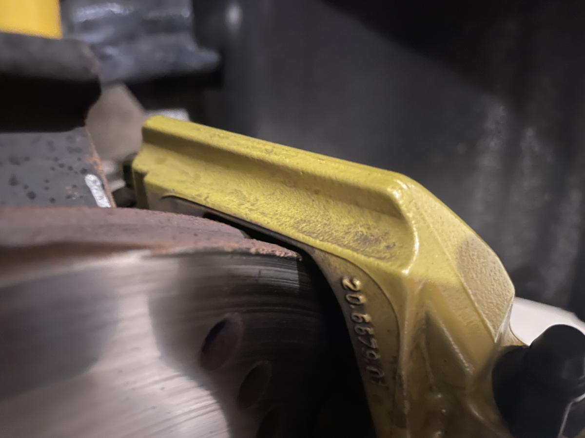

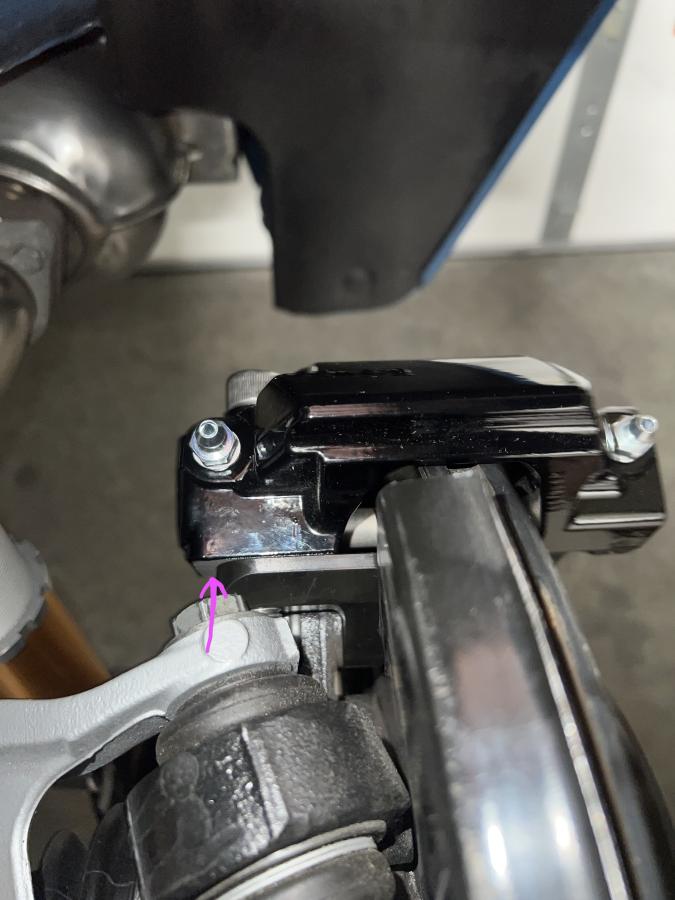

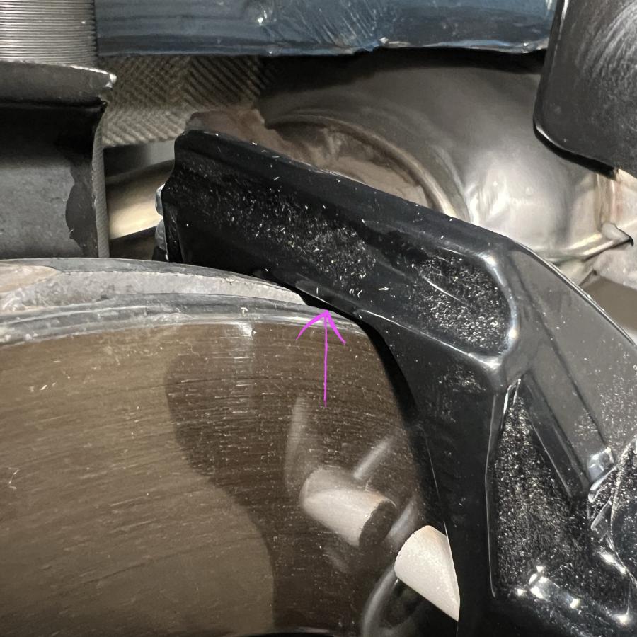

                  Looking for advice here on rear 996 calipers with rallyroad brackets.
                  Does everyone have this tight of tolerance between the caliper body and the rotor? This doesn't seem to be enough space for heat expansion.
                  [I see there are some shims included with the rallyroad brackets, but I believe these are for horizontal spacing of the pins which I have no issue with.]
                  Click image for larger version  Name:	IMG_2429.jpg Views:	0 Size:	113.9 KB ID:	305866​
                  Also, are these supposed to hang over the brackets like this? I don't see any other way to fit these. Doesn't smell right.
                  Click image for larger version  Name:	IMG_2437.jpg Views:	0 Size:	61.0 KB ID:	305867​

                    I remember having to file down part of that bolt head on a friend's 06 zcp. I personally have CM, but I'll be installing rear RR brackets on another friend's car soon.
                      I received a response from Rally Road. Still curious to hear others thoughts with experience with these.
                      "I don’t see anything wrong in the pictures. There’s variations from car to car and rotor to rotor, etc. There’s also no need for the bracket to mate with every part of the caliper mounting surface. Sure…we could have designed it that way but then it would cost $50 more with no benefit.
                      If the caliper is physically rubbing on the outside ring of the rotor, then I would clearance the caliper with a file. A millimeter of clearance should be enough.
                      If we moved the calipers further away, then the brake pads wouldn’t fit the same.
                      Everything looks just fine based on your pictures."

                      Tbonem3 Are you referring to the control arm balljoint bolt? No issue there.

                        yes. It's a tight fit (the rotor to caliper), but no evidence of them touching.
                          Mine does not have that little of a gap. Have the car on stands, let me take a pic
                            I take that back, seems is a tight fit. I don’t have my feeler gages but is barely 1mm of clearance. I do not see any rubbing though.

                            I have more clearance to the bolt, but maybe is the photo angle on yours?

                              Thanks for providing the pics maupineda . I just mounted mine up and they fit fine, like yours do. No rubbing, just spooked me at first.

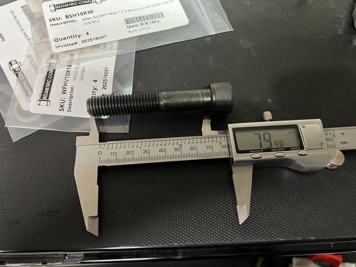

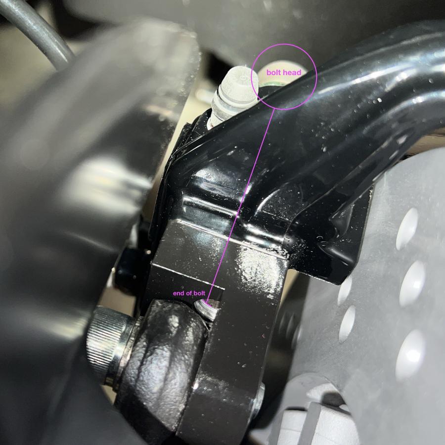

                              With that closed, this project just keeps handing me gifts as I have a new dilemma. On the Megane (Freakyparts kit) front calipers, the radial mount bolts don't thread all the way through the brackets. The provided bolts are m14x80mm socket heads. The next size up is 90mm.
                              I'd like opinions on whether to:
                              1. use 90mm bolts and trim the bolt to avoid the knuckle.
                              2. use 90mm bolts and shave off knuckle to accommodate bolt
                              3. use the 80mm bolts as is...
                              Edit - I was able to locate 85mm bolts on amazon of all places. Nothing on Mcmaster, belmetric or boltdepot. I think these should do the trick, they are fully threaded however.
                              pics:
                              Click image for larger version  Name:	IMG_2462.jpg Views:	0 Size:	87.5 KB ID:	306141​
                              Click image for larger version  Name:	IMG_2464.jpg Views:	0 Size:	162.4 KB ID:	306140​
