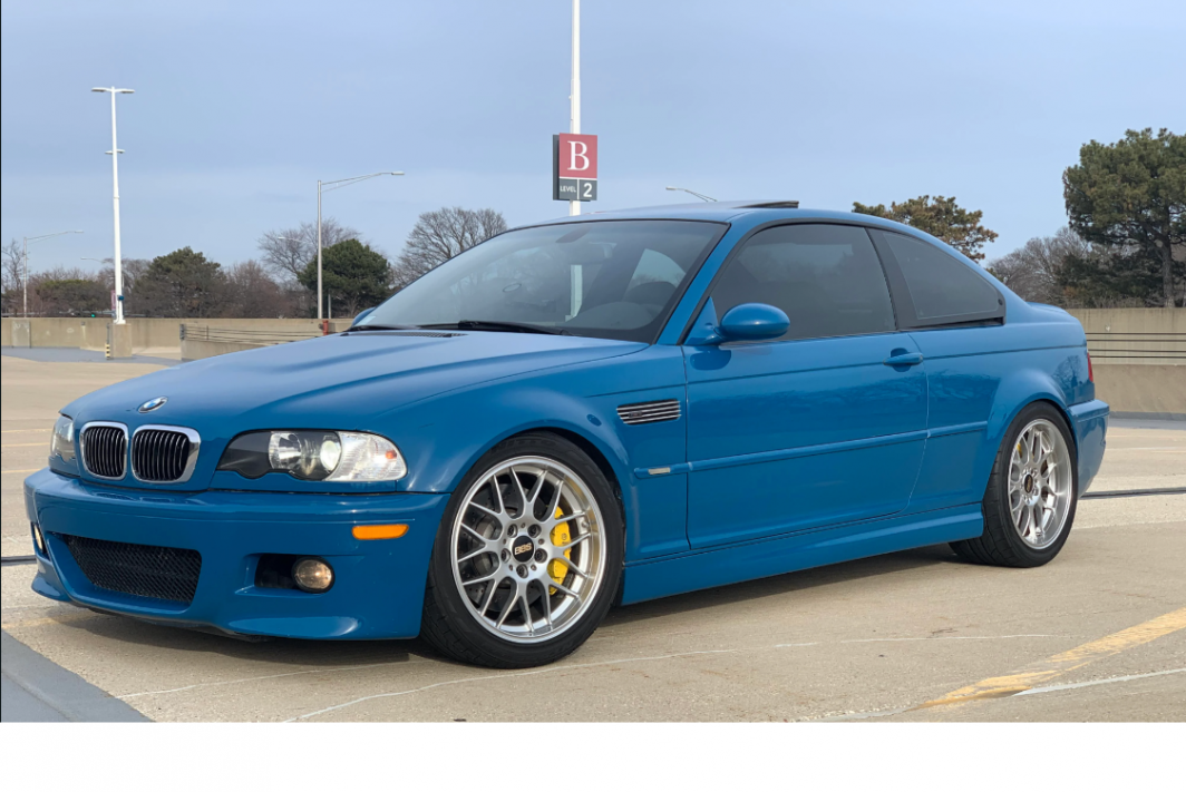

                Any thoughts on 996 BBK clearance with E39-spec'd BBS RG-Rs? I have a set of 996 calipers being prepped but was looking to plan ahead in terms of fitment with the current wheel setup.
                • 18x8.5 ET22 Front
                • 18x10 ET25 Rear
                The general consensus seems to be that it won't clear, and I believe Repoman has already test fitted them and found that it won't clear,
                But I was also able to find someone who did get them to work with E46-spec RG-Rs (18x8.5 ET38 Fronts) with a 12mm spacer up front (guessing based on the owner's previous posts):
                A 12 mm spacer would effectively make the front specs 18x8.5 ET26.​
                Click image for larger version Name:	996BBK.png Views:	0 Size:	941.2 KB ID:	224049
                Thread about the wheels shown above: 18" BBS R-GR's w/Porsche 996 BBK Fitment - NA M3 Forums
