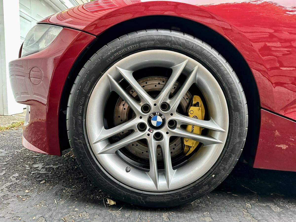

        Not E46 but I know there's some Z4 M users floating here. I have 3 different wheel setups and I can confirm all 3 clear front calipers without spacers:
        1. Staggered Style 641 (8.5 et27 | 9.0 et29) - spokes slightly convex
        2. Square Style 224 (9.0 et30) - spokes flat profile
        3. Square SSR Type C RS (9.5 et35) - spokes slightly convex
        FYI my Style 32 did not fit at all (front or rear) but that's not surprising given the concave spoke design.
