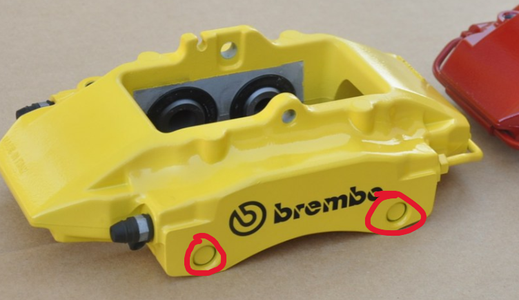

    There's a pin underneath holding them in. They maybe tght and need to be pressed out. I never removed one, but I did have one that was well loose. I could tell it wants to rotate and slide, but I saw that little rolled up metal pin move when I moved the big pin, so I think it's holding it in.
      Does anyone how to remove these pins? I need to pull them out a bit.

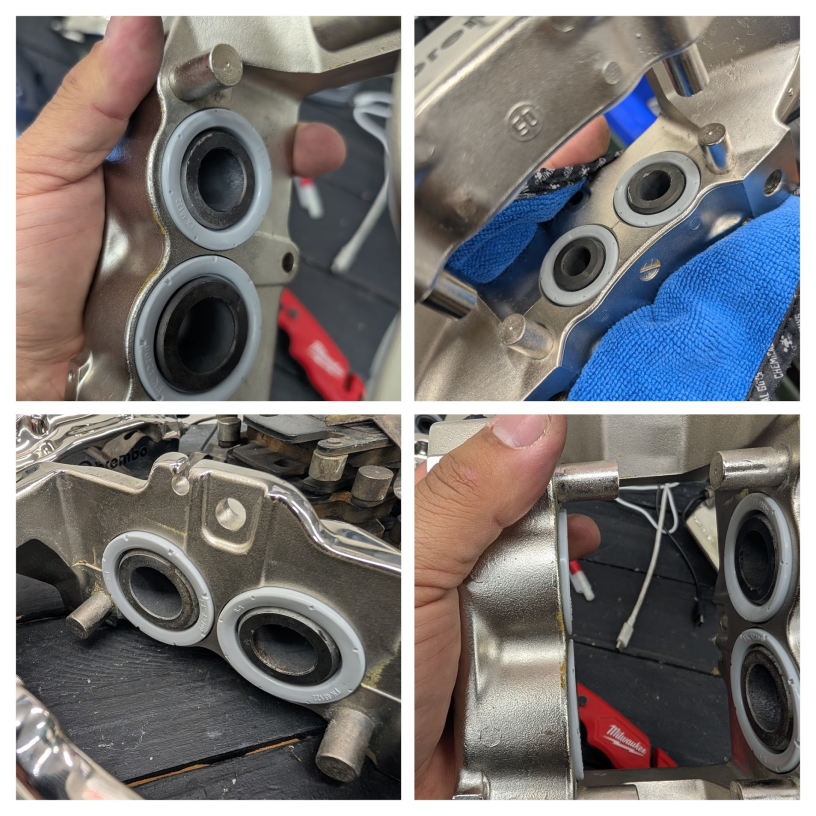

          I got the FREN Kit from Ohio Performance Solutions. The kit is great. I got the whole rebuild for all 4 calipers, I decided NOT to get the calipers powdercoated because it will have to be redone again in the future so I ended up getting it ENP to look like the Essex kit on a budget lol.
          The calipers look SICK, I am super happy with them.​

            Got any close ups of them? They do look pretty sick!
                Please see attached:
