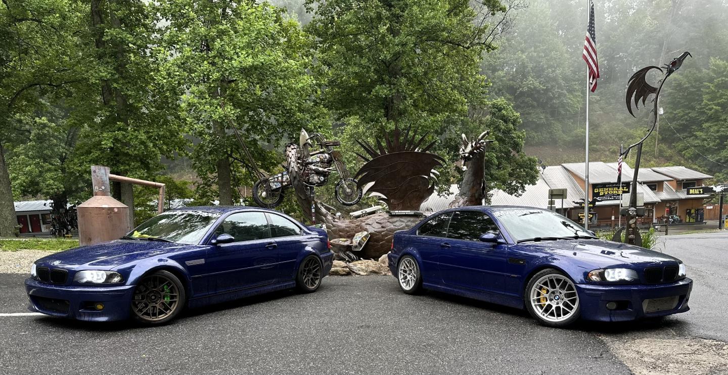

                                Hope it helps, as mentioned above the spoke design matters just as much as the size and offsets.
                                Apex Arc8’s
                                18x9.5 et22 fits
                                18x9.5 et35 needs 10mm spacer
                                18x10 et25 fits
                                silver wheels car is running square 10’s
                                bronze wheels car is running 9.5 front 10 rear
                                2006 ILB | M-Texture
