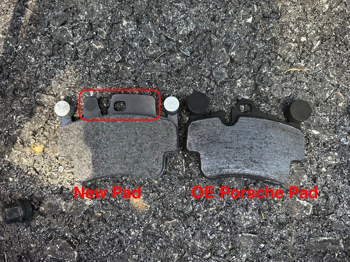

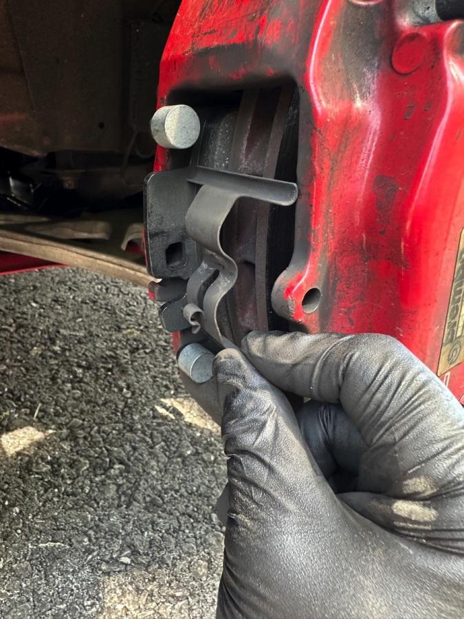

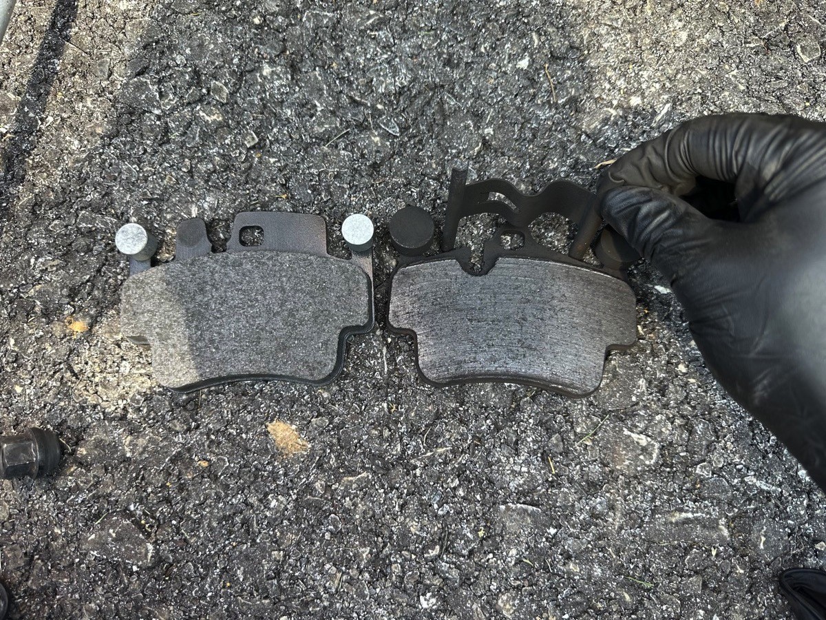

          So, feeling like I'm missing something obvious here.
          The OE Porsche pads that came with my calipers are at end of life, so I ordered new one using the PN in this thread (99635294903)-- which I don't think is wrong, as FCP agrees that's a stock 996 front pad.
          The pads that came have the same pad shape in the portion that goes into the caliper, but there's an extra bit of flange up top that prevents the anti rattle clip from being used.
          ... what am I missing? I'm fine with no anti rattle clips on track, but on the street that'll almost certainly be way too annoying.

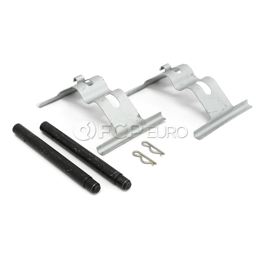

            Turns out the answer is I need an different version of the anti rattle clip than came with my calipers.
            This is what I need: https://www.fcpeuro.com/products/por...11-52843010001

              Porsche did a part update in 2010 or so to their pads and clips for that generation of brakes. My dad and I ran into that issue 7 or so years ago on his Cayman. This is sort of common Porsche knowledge but we are not Porsche owners in general and this is a BMW website. Easy to miss and next thing you know, you're out $30 for no reason.
