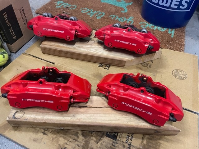

    I got mine on e-bay for cheap, but not so cheap once I refurbished them with new original seals.

      Ive got a full set from a Cayman S (red) in nice shape, will split and just list the fronts separate if you want to work out a price on rears. I can send more pics to your email/etc - just let me know.
        just PM'd you!
