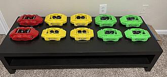

                          Silbergrau metallic here is a member that has multiple Brembo 996 BBK kits for sale.
                          I've watched a few Brintech Customs YT videos (they did the weight comparison between S54/S65/S85) and discovered they have a BBK kit for the E46 M3. Six piston / 365mm fronts and four piston / 350mm rear. No idea what the bias is. They machine their own caliper brackets and rotor hats. Rotors are DBA brand and pads are Bendix
                          Hey that’s me! Lol, I’m like man that picture looks familiar haha

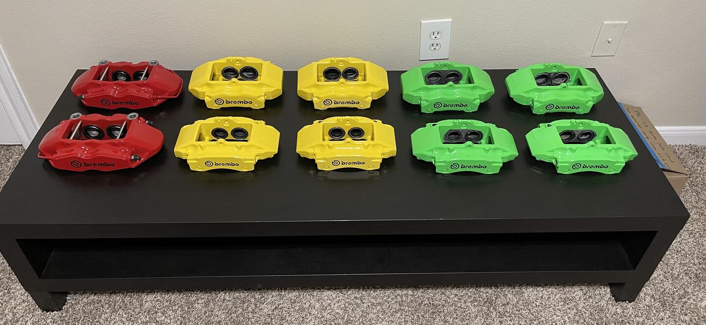

                          yes I have (2) full sets of 996 front and rear. 996.351.425 and .426 are the correct fronts you need, everything is at the front page of this post!
                          electric yellow (not machined yet)
                          bright green (I believe the rears are sold, should get payment soon) fronts are machined and I have the rally road brackets on hand.
                          I followed this post for the part numbers, sourced individually all the new pieces, a second set came for sale at that time so I just bought two of everything and got the second calipers too to have them redone.
                          feel free to PM me with any questions, I’ll try to answer but most these guys on here would be better able to answer I’m sure!
