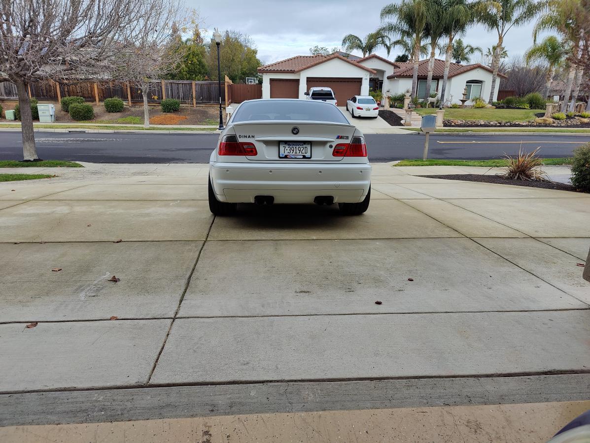

                      If your smog includes that obd2 port being connected, I believe there is no passing. Sold my Karbonius a couple months ago for this very reason and swapped back to stock headers. Big sad here.
                        CA can be done, but the juice isn't worth the squeeze.
