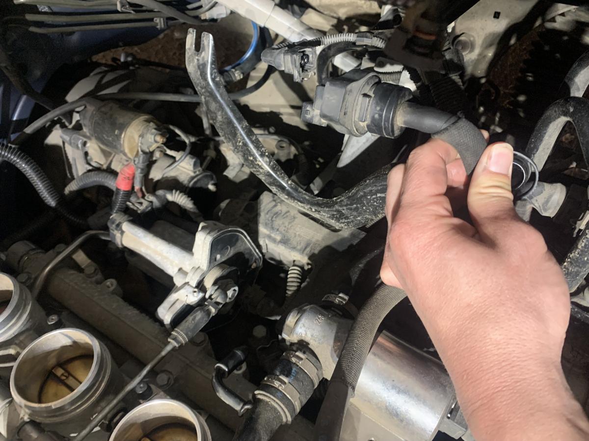

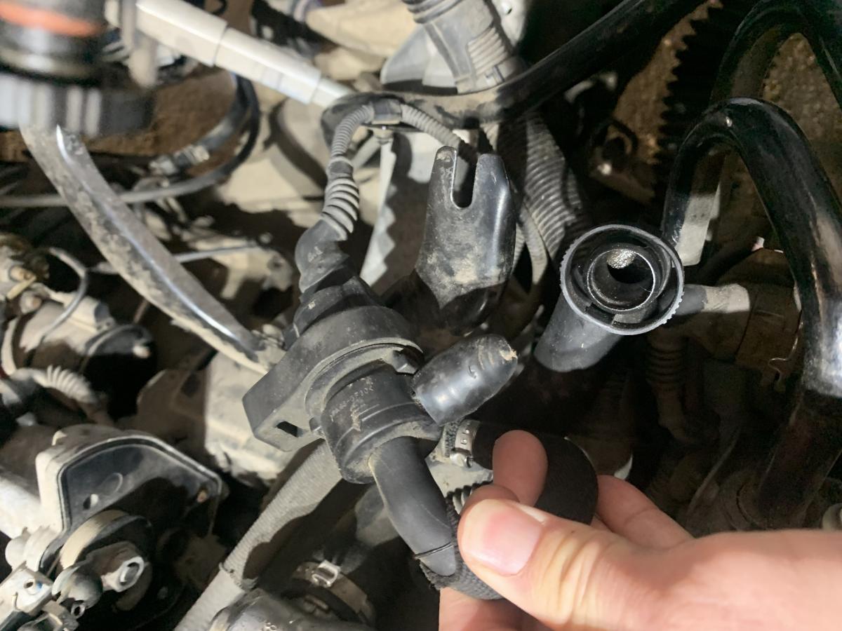

    I've been hunting down an issue with my car, I deleted the charcoal canister. When I deleted it, I put a rubber cap on the valve that goes to the intake manifold. https://www.realoem.com/bmw/enUS/sho...diagId=13_0912
    On this link from Real OEM, I put a rubber cap on Part #1 in the diagram. Could this be throwing a cel? EML light? Thanks
    You removed the entire canister? And did what with the rest of the lines? Short answer, quite likely, yes. What was the original problem you had that led you to believe deleting the canister would possibly resolve? If you can provide more details you might get more helpful response.

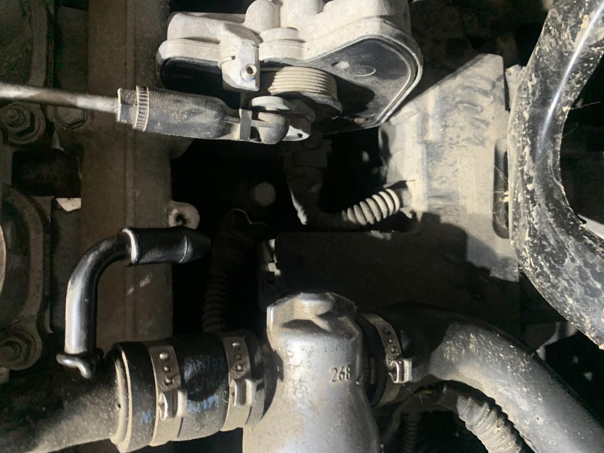

          It's going to throw evap codes, but if you capped the manifold, it won't affect the engine operation.
            Any way to code it out? I'm pretty familiar with these cars, and the coding. I'm going to remove the pump, and cap the pipe off the manifold anyway. If I can get it coded out, I'll just remove those wires from the harness, depin it from the ecu etc.

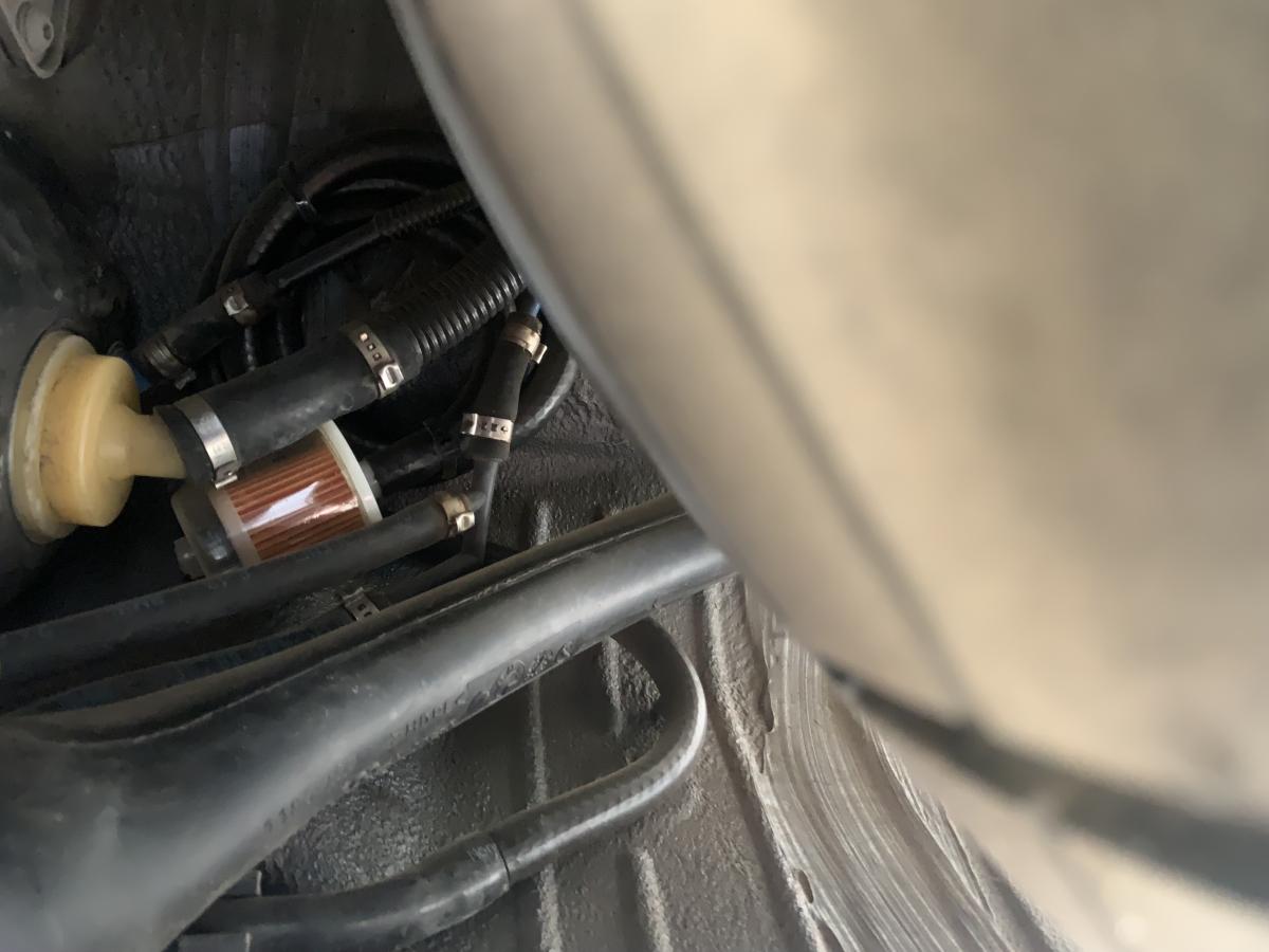

                        You need a way to vent the fuel tank. When you refuel, you are displacing the vapors in the tank with liquid. Some of it goes into the vapor recovery system in the gas pump. The rest gets routed through the charcoal canister. You’ll likely smell gas vapors when refueling. Could pose an issue in colder weather when static electricity is more prevalent.
                        I installed a fuel filter with a check valve on the end of a rubber hose and tucked it behind the rear wheel. It was a universal part from Auto Zone.
                        I’ll see if I can find pics.
                          I posted, what my solution was to the tank venting. SEE POST #4 in this thread. Simple and done. The question is how to code out the pump, so I don't get a CEL Click image for larger version  Name:	image.png Views:	0 Size:	44.8 KB ID:	319380Click image for larger version  Name:	image.png Views:	0 Size:	77.6 KB ID:	319381​​​

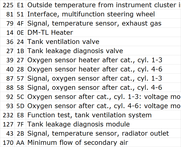

                            I pulled a BIN file and then used Hex Editor to suppress the codes. Below is a list of the codes I suppressed for my wire harness modifications. The info was in a thread on M3Forum with the location of the code strings.
                            I'd guess 36, 27, 232, and 127.

                              perfect, ty edit: after reading through it all, did you delete the egt? I was thinking about keeping it, any reason why you deleted it?
