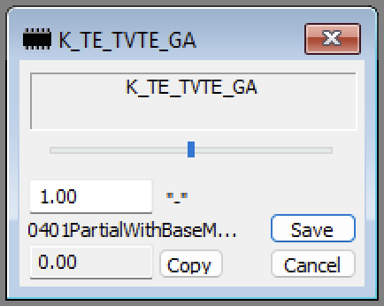

    There's a config parameter to prevent the ECU from trying to open the TETV as well. Let me dig it out for you. Otherwise RF calcs could be a bit funky if it's accounting for tank ventilation that isn't actually occurring.
      I appreciate that, thank you
        TETV valve can be prevented from opening by setting K_TE_TVTE_GA to 0 (default value is 0x80 (1.0 with conversion applied)). I have confirmed this behavior via logging. I'm not sure what version of MSS54 software you're running so can't give you the exact address of the parameter.
        Click image for larger version  Name:	Screenshot 2025-09-18 at 11.54.57 AM.png Views:	0 Size:	10.6 KB ID:	319413
        IMPORTANT: For anyone else reading this. DO NOT leave your tank ventilation system disabled without having an alternative mechanism in place like OP does.

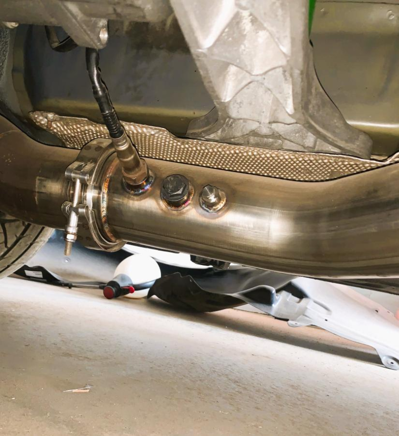

          perfect, ty edit: after reading through it all, did you delete the egt? I was thinking about keeping it, any reason why you deleted it?
          I deleted the sensor. I'm thinking I should have kept it. Too late now.
            Click image for larger version  Name:	image.png Views:	0 Size:	886.1 KB ID:	319424
            Good to hear, I kept it, I plan on plumbing the sensor into this bung on my section 1..​ the other bung is for back pressure.
