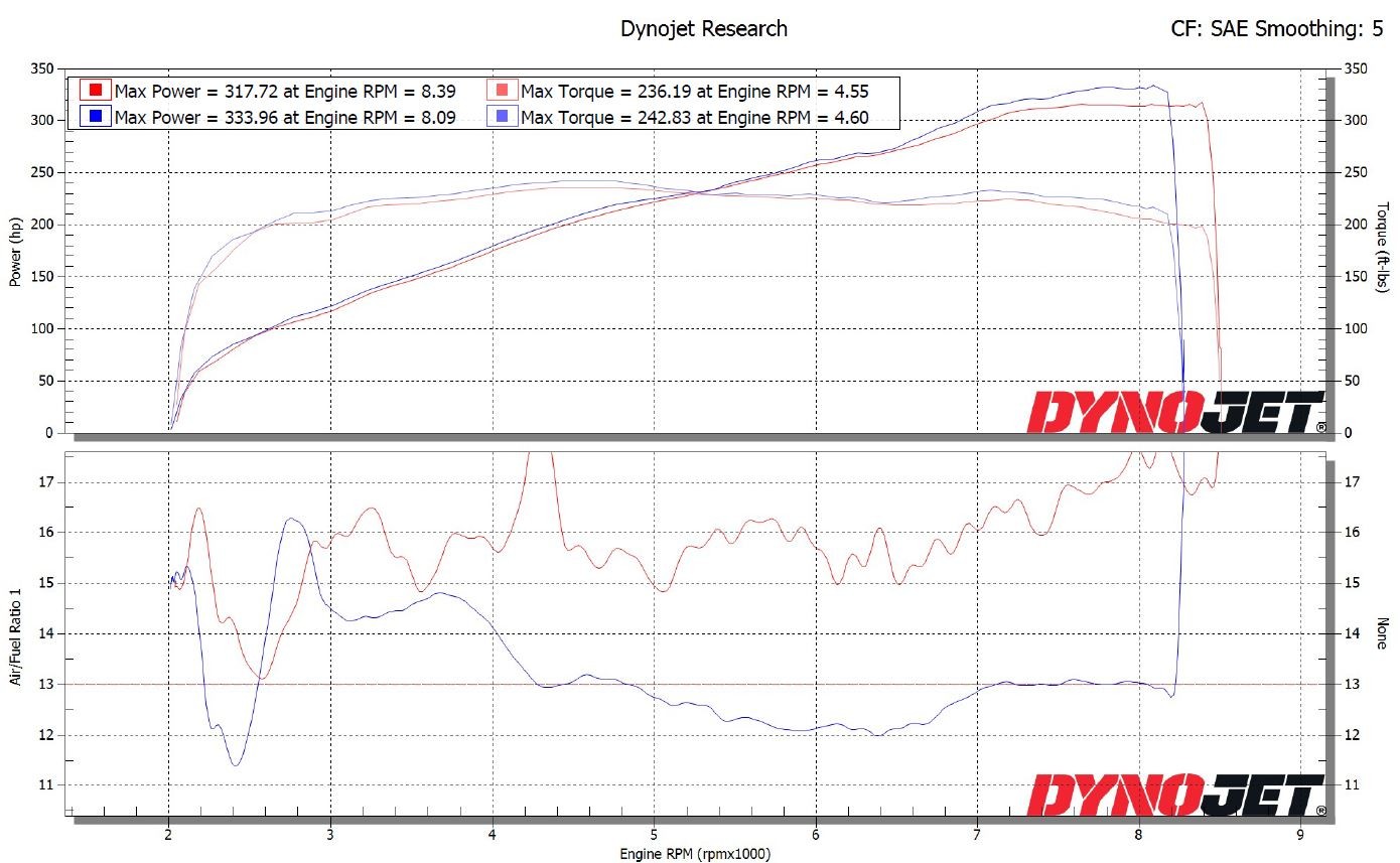

                It's been a while since I have updated this post so here is some new data and area I am trying to figure out.
                First, I will respond to your questions:
                1) When Lang was doing my head work I asked about porting the intake, but Andrew advised that it wasnt necessary with stock diameter TBs. He did suggest porting the exhaust which we did. Not knowing any better, I took his advice on both.
                2) My VANOS has been rebuilt, so not sure what else to say here. Yes the dyno flat lines, but not sure why.
                3) Agreed, from all the other dyno posts I've seen. Not sure if others are reporting SAE or STD numbers, but I did expect bigger numbers.
                4) Keep in mind these dyno progression graphs span across almost 15 years of ownership. The engine aged quite a bit, but it was always very well maintained.
                -- I have performed both a leak down and compression check earlier this year (much after getting it back from Lang). All cylinders are showing between 97-99% on leak down and 154/152/152/152/148/158 psi compression across all cylinders, which from what I understand is nominal for 288/280 cams.
                -- Unfortunately I don't have any adaptation screenshots and none were provided by the tuners.

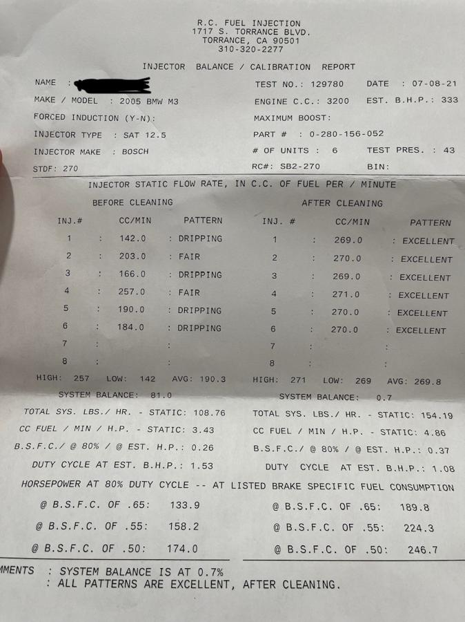

                Yes, as a few of you have mentioned with this setup I expected power 350+ rwhp. I am not achieving that and I cant figure out why. The last couple tuners haven't been much help in providing feedback for areas to investigate. My first tuner was Paul Claudes and this past May I used Matt from HD tuning. For those not familiar with HD tuning, Matt is the go-to tuner for the e39 M5 and tunes many super cars. Since I was originally planning to just tune the M5, I used HD tuning and asked Matt to take a look at the M3 since I was already going to be at the dyno. I brought both cars and here is what happened.
                Since my original tune from Paul, I have been chasing where the lost power was coming from. After performing the compression and leak down tests I started looking at the fuel system. My fuel pump, FPR, and injectors are all original to the car so I replaced the pump and FPR, then got the injectors cleaned at RC Injectors which is local to me in Torrance, CA. The injectors were in pretty bad shape from the pre-cleaning flow rate, so I though that might have been an issue.
                Once I got the car all back together I hit the dyno with Matt in a remote tuning session. AFRs were giving us issues the entire day at the dyno, so I wasn't confident that we were going to make much progress. The initial baseline pulls were really low on power, which I expected with all the changes to the fuel system. Matt slowly dialed it back in. The biggest issue I wanted to address was the hesitation at WOT in low RPMs. After Matt was adjusting the tune he commented that he wanted to make the tune "safer" and that would result in slightly lower numbers from what I originally achieved with Paul. He told me that he raised the minimum timing to eliminate the hesitation. I dont know much about tuning, so that is as much feedback as I received.
                I'm trying to be as transparent as I can with the work Ive done to try and get this figured out. I was assuming 91 octane is hold me back slightly, but not enough to lose 20+ rwhp. My plan is to find another DynoJet and get time with Hassan. I want to get some advice from Hassan to see if my fuel injectors need to be upgraded. Neither Paul nor Matt made any comments that my fuel injectors were maxed out or holding me back. Unsure if that will address my issues.
                Any and all advice is appreciated!

                  Matt at HD Tuning is overrated, E39 M5 guys are out of touch as usual. He dialed the tune back because the injectors have to be jerry-rigged to work when they're running past 100% injector duty cycle. Your injectors are too small and are holding your car back. Period. I have no idea why E46 M3 guys think these small stock injectors can handle an extra +70whp over stock. Hit up HTE asap and have him retune the car.
                  Just to give you an idea of how hamstrung your car is... assuming that dynojet is running similar #'s to EAS's dyno jet, you're making roughly the same power I am and my head is stock, stock cams, Euro header, non-oversized exhaust, Eventuri intake on E85. You should be making about 30-40 whp more than me.
                  People really need to stop going to Lang, Matt etc. Lang is a price gouging predator, Matt is so strung out from partying and tuning exotics he doesn't really put effort into old cars like E39 M5's and E46 M3's.

                    I appreciate the confirmation on the injectors and I’ll be reaching out to Hassan. Being in LA, I plan to use EAS for my next dyno day. For the inexperienced, it’s hard to tell if a a builder or tuner is “over-rated”. Back 4 years ago when I started this build, nobody had bad things to say about Lang (or it wasn’t advertised) and people were moving away from FSTT and raving about Paul. Hassan wasn’t formally tuning cars as a business yet either. Live and learn I guess. Just good to see the community and platform continuing to grow and evolve.
                    Any recommendations on injectors I should consider? Can the stock fuel pump handle any larger injectors I upgrade to? Can I also use the stock FPR?
                    Thanks in advance for the help!

                        So couple things here as I just did an extensive topend build and sorted every possible thing you can think of while in there including redoing things that were “done” already…
                        Build consists of:
                        -Lang stage 3 head with supertech single keeper groove valves and upgraded springs
                        -schrick 280/272 cams with dlc followers
                        -bosch ev14 550cc injectors with radium fuel rail
                        -karbonius csl airbox with map sensor and csl dme conversion
                        -spal 2049 electric fan with custom Zionville shroud
                        Big one is the injectors, you are 100% out of fuel with that setup because I hilariously ran out with milder cams all across the board but still made 348whp on a mustang dyno. And the freshly rebuilt stock injectors were out of fuel all across the revband so my tuner had to dial back everything to keep the car safe, robbing power. Drivability wasn’t great outside of wot but the car was safe.
                        Upgrading the injectors to 550cc was CRUCIAL imho. Stock is basically maxed out and are a literal waste of time if you have any engine work done.
                        The equation is really simple… if you add more air into the engine via cams, airbox, porting, etc, you need more fuel and stock injectors aren’t going to cut it clearly.
                        My car stopped making power at 8200 with stock injectors and moving to 550 the car pulls CONSIDERABLY harder and smoother all across the rev band and I’m still making power at 8600rpm. Could go higher but for a car that constantly sees redline, not sure it’s worth it to me.
                        Also I’d pressure test your vanos if you changed oil pump disks as that is a bad idea (idc what people say) because the tolerances of the disk and vanos unit wear together and if you get a higher mileage disk the pressure will drop considerably and drastically limit the system from working. Happened to me and I had to get an entire replacement vanos unit.
                        I’d also leakdown test the engine because Lang’s machinist isn’t as good as he’s hyped to be. I got my head back with three leaking valves and had my local guy redo the valve seating. Don’t assume it’s good because it’s Lang. He’s a pos and doesn’t hold up to his claims.

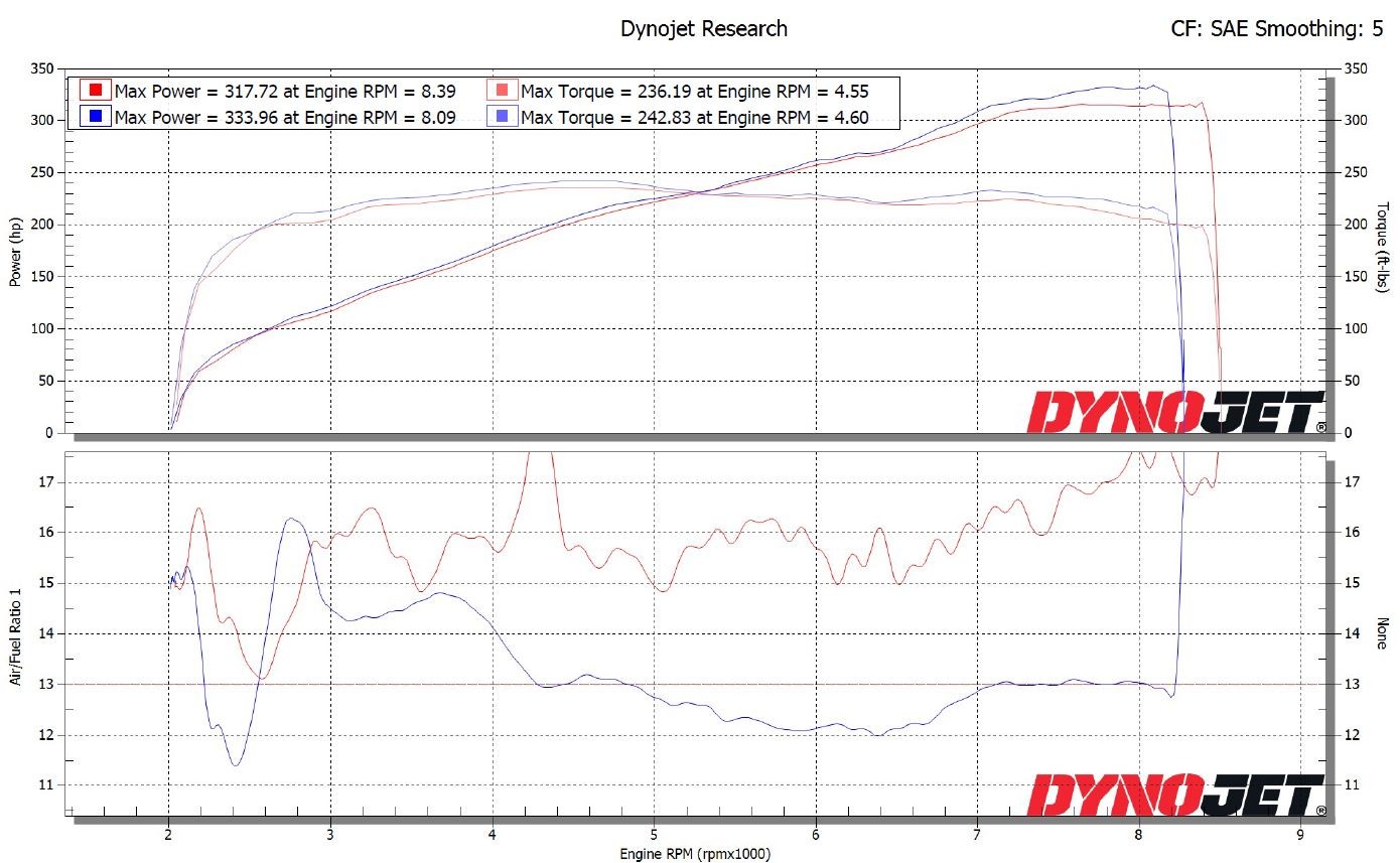

                              This is my third tune and dyno session, all with different tuners. Details below on that evolution. Had a mix of issues between hesitation under throttle and overall drivability. My session today was with HTE Tuning today at EAS in Anaheim. Couldn't be happier with the results. Drive home was a dream and all the previous issues seem to be resolved! Thanks Hassan for your time and effort.
                              Also, big shout out to thegenius46m for all the advice on the fuel injectors and Radium setup!
                              Build Details
                              - 2005 ZCP with ~159,750 miles
                              - 91 octane pump gas (Shell)
                              - CSL converted DME w/ CSL software from Kassel Performance, includes H-bridge to support CSL flap in snorkel
                              - OEM CSL Snorkel with functional flap
                              - OEM CSL Air Intake Temp Sensor in stock location on airbox
                              - OEM CSL air filter
                              - CSL Airbox w/ carbon fiber trumpets (Karbonius)
                              - Dinan high flow throttle bodies
                              - OEM air rail modified to fit updated Bosch MAP sensor (P/N 0 261 230 101) in OEM CSL location
                              - Bosch MAP sensor has OEM scaling from what I recall with previous tuners
                              - Radium Fuel Rail with pulse damper / Radium stainless steel fuel filter / Radium fuel pressure regulator / OEM fuel pump
                              - Bosch Injectors, 52lb/550cc @ 3 bar (EV14, P/N 0280158117)
                              - Ported Intake on Head
                              - Schrick Cams 288/280
                              - SuperTech Intake and Exhaust Valves and SuperTech Springs (OEM size and lift)
                              - Ported Exhaust on Head
                              - Supersprint V1 Stepped Headers (63.5 mm)
                              - Supersprint Catted (HJS 200-cell) Section 1
                              - Supersprint Resonated Twin-Pipe Section 2
                              - Supersprint Race Mufflers
                              - Electric Fan Conversion SPAL 2049
                              - 3.91 diff gears
                              SAE Correction Factor
                              STD Correction Factor​
                              For those who are interested in knowing the details of the different tuners, I have used PCS Tuning, HD Tuning, lastly HTE Tuning. There is a hardware difference between the initial 2 and the last with Hassan. The last tune included Dinan TBs, 550cc injectors, and the Radium fuel system upgrades. Also, each tuner had different opinions on the rev limiter value. I put a marker at 8000 rpm for a more direct comparison versus max values in the legend. Not exactly and apples-to-apples comparison, so I wanted to make that clear. Hassan did note that the HD tune had the knock sensors were "way desensitized" and questioned the how safe it was.
                              RED: HTE Tuning
                              BLUE: HD Tuning
                              GREEN: PCS Tuning
