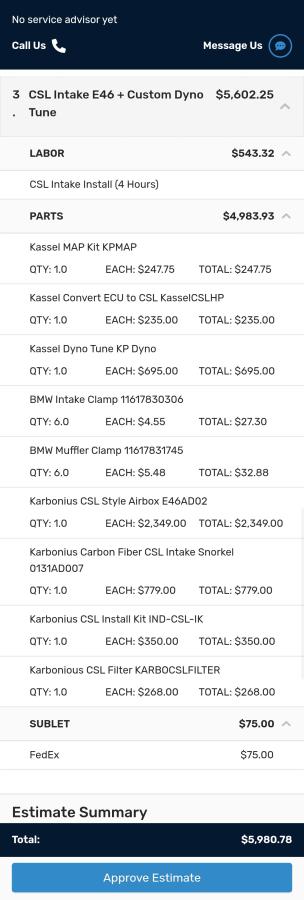

                    So they also mentioned flashing the converting to the CSL map? Now is that something different than a dyno tune?
                    Here's their estimate. I'm sure they wouldn't mind me sharing this as it's probably their going rate for everything.
                    My car is also 2004 so I wouldn't need to new DME.
                          You should ask them but doesn’t seem like it since the dyno tune is a separate line item for $695.
                          All I know is $5900 is a lot. Keep in mind you will likely have to pull the box out every few years for emissions. Are you going to pay someone then to swap back each time? If so maybe you’re better off going with the OE style.
                              What's the going rate for the whole process not including the box obviously?
