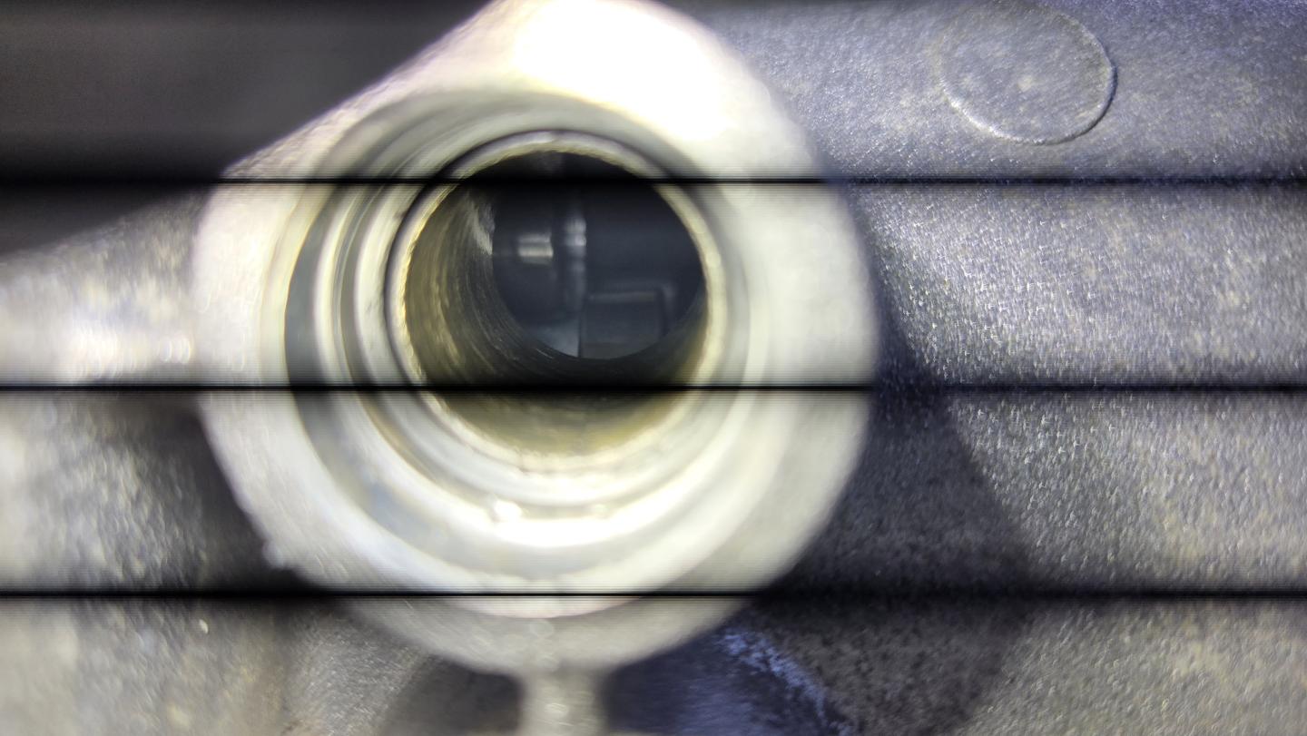

            I recall that from watching the DIY video for the ZF 5-speed detent overhaul. From everything I watched and sourced for the Getrag 420G, the inner sleeves were not replaced. It was mentioned to be cautious and not damage them when replacing the detent parts. The sleeves in my transmission appeared to be in functional shape, so I left them alone.

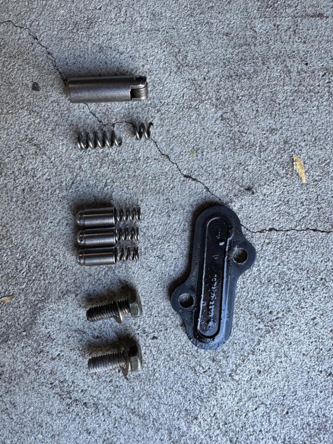

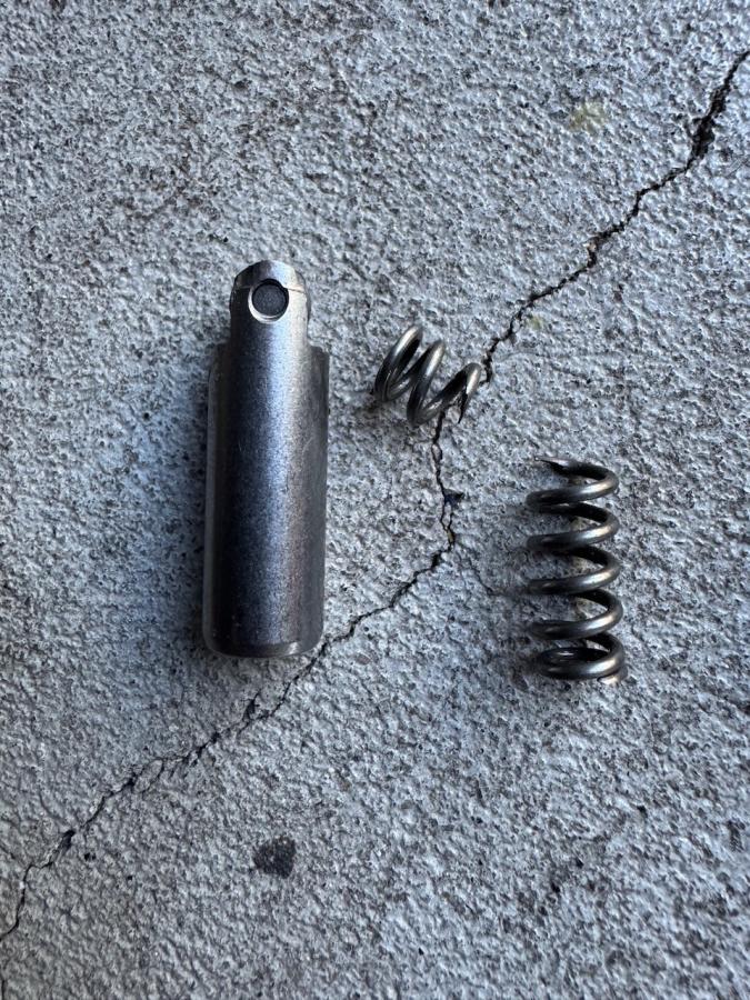

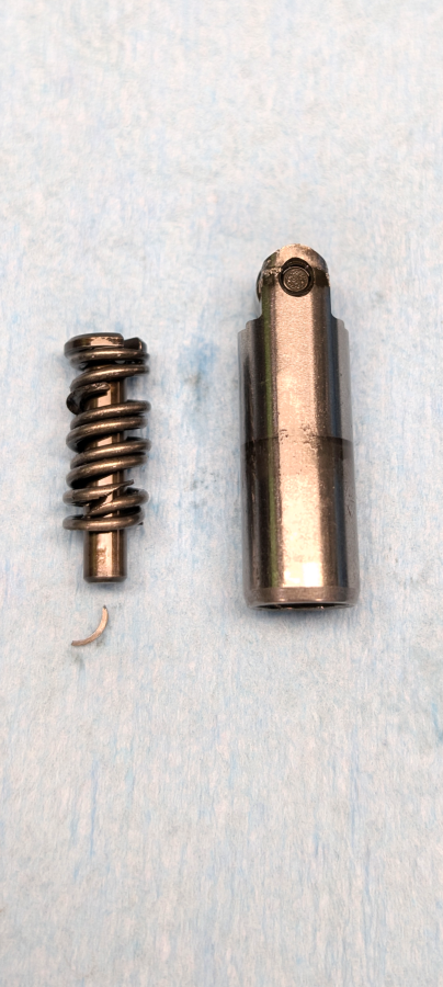

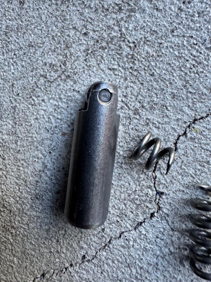

              sapote George Hill I finally replaced the detents on top of the transmission and 2 on the side rear. The one behind the GPS, spring was broken and the metal around the roller seems a little mangled, probably due to forcing it in sometimes. Shifting feels quite a bit tighter compared to prior. What causes this spring to break?
                #37
                Just a bad product, as compared to the engine valve springs which are subjected to more displacement and frequency and they last for many many cylces.
                  #38
                  Was your transmission originally SMG? I think I've seen (1) broken on a 6MT, but I've seen dozens on SMG boxes. No idea why, but I always replace them if the transmission is out.
