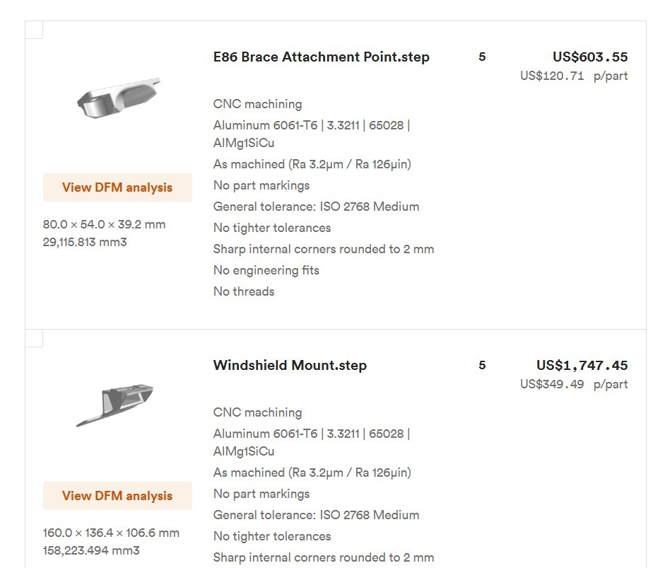

        You can likely take off a good chunk off of the cost with some modifications to the fabrication. Cheaper welding labor (or free if you trust yourself), cheaper fasteners and a different approach to the windshield mount can knock $500+ off the price. Maybe you can convince bigjae46 to sell you his forged carbon version of the mount.
        Ideally, this mount would be a spot welded (or epoxy/riveted) sheet metal bracket, like the one on the E86/E9x/E8x/etc. Unfortunately, I still do not know the typical loads that this piece sees, so I had to design it to be stronger than the weakest link in the chain: the E86 braces themselves. There's a lot of potential for price optimization here, I just decided that spending more money to get this CNC machined was worth it, as I did not want to be stuck with a failed part that is permanently bonded to my chassis.
        If anyone wants to add some strain gauges to a set of E86 braces, I can throw them on my car and capture a bunch of typical load data. Then from that, an optimized sheet metal design can be designed.
          Heinz, I didn't see the sheet metal brackets (that would be cut by SCS) for the strut towers in the files, am I blind or not understanding?
          Re: the firewall/billet mounts, SCS is offering CNC services and they are not terribly far off Heinz price and adding multiple quantities brings the price down.
          I reached out to my CNC shop that makes our parts and asked them for a quote. They want to modify the windshield mount (I'm assuming to make fixturing easier, but waiting for a reply) and so both of these items at qty 1x are far and above what Heinz paid or quoted by SCS.
          BUT if we increased the qty to 5x then my shop comes out ahead. My cost would be $500.11 (with tax) per set for (5) sets ordered. I Imagine we'd be able to get the SCS sheet metal parts cheaper by increasing the qty too.
          I think this is in the spirit of what Heinz wanted, there is no money to be made by me, so if he approves and there are enough of us interested but are held back by the price we could look at something like a Group Buy for the parts.
                That's $500 for both parts? If so, that's an awesome deal.
                By all means go ahead with the group buy if there's interest. The whole point of sharing this is that it gets adopted by as many people as possible!
                I'd be interested in knowing how your CNC shop wants to modify the windshield mount.
                  Protolabs will do volume discounts also. I was going to investigate pricing as soon as I had a chance to open h CAD. I can report back in a day or two

                    Yes, $466 plus tax and potentially cheaper depending on the revisions. I'm not sure what they would want to revise on it too, there would be some leg work on my end, but if we venture down that route even if we end up not following through I'll keep you posted.

                              Protolabs seems like the play here depending on quantity. $120 and $350 at a quantity of 5.
