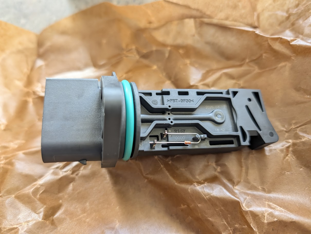

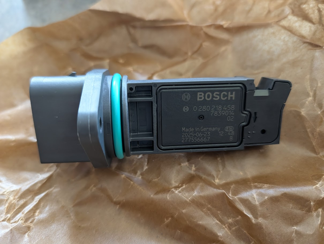

          Okay so I got the updated MAF, it's crazy seeing a 2025 date code on a part in my 2005 M3...
          Click image for larger version  Name:	image.png Views:	0 Size:	931.8 KB ID:	324510
          Click image for larger version  Name:	image.png Views:	0 Size:	924.0 KB ID:	324511​​
          Seems to have solved my issues, but I think my 3yo Hella pump check valve has gone bad.
