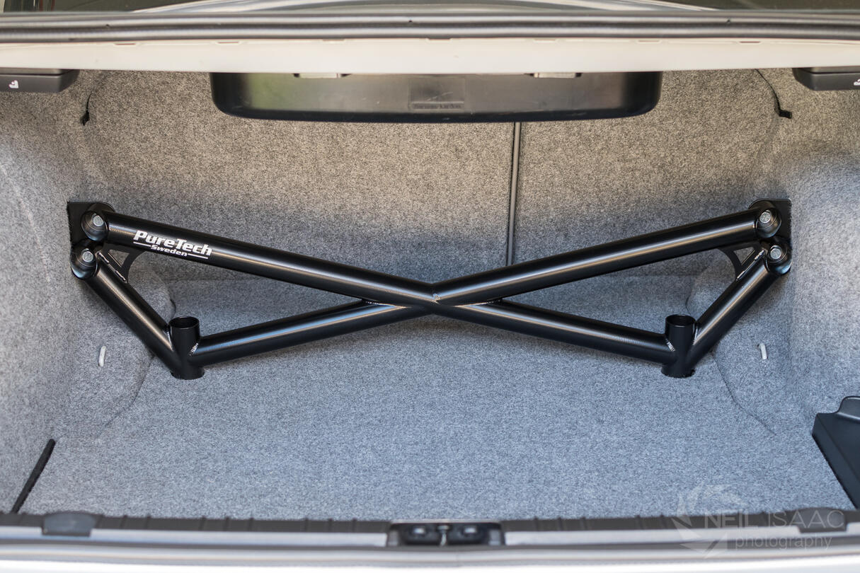

            I bought one and fitted it a few months back. Haven't had much of a chance to drive the car since, due to lockdown in the UK ☹
              Beautifully made piece.
