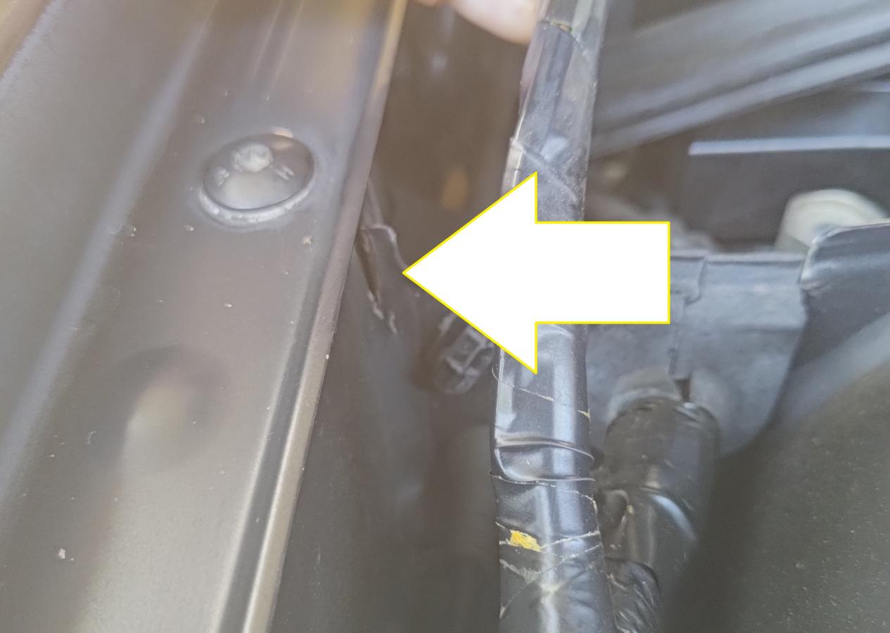

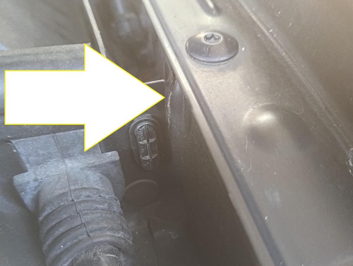

              I see this (eg 1, eg 2​) on early M3s that weren't fitted with the strut brace.
                more body separation. wonderful.

                  I mean you can drive without but your seam sealer will start ripping and the strut towers might move. Especially when under load (in corners)
                      Looks i will be moving the off road package plates / strut bar to the top of the shopping list
