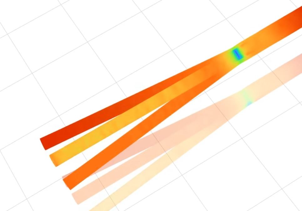

      I was able to get it working earlier today. I created a fairly simple script that, for now, matches the pressure wave Digger supplied. Obviously, this is an extraordinarily simplified header model. It was just meant to be used as a test bed for the offset port timing profiles I was attempting to create. Now that this is working properly, the real work can begin in earnest.
      The really interesting thing that stands out to me is the banding that happens in the primaries under certian conditions- this is evidence of standing pressure waves, which I did not expect to see.
Name:	look at da bandzzz.jpg
      The low-pressure zone at the "collector," if you can call it that, is interesting as well. I think some extreme optimisation of the collector to create a venturi that has maximum effect on the other primaries could be interesting, as could some really innovative anti-reversion geometries, as 3stax has discussed.
      As always, GIGO, so I will need to put a lot of effort into refining the animations and possibly even re-designing the profiles from the pressure-based model they are now to a velocity- or mass-based profile... not sure, at the moment, which will be best. Time will tell.

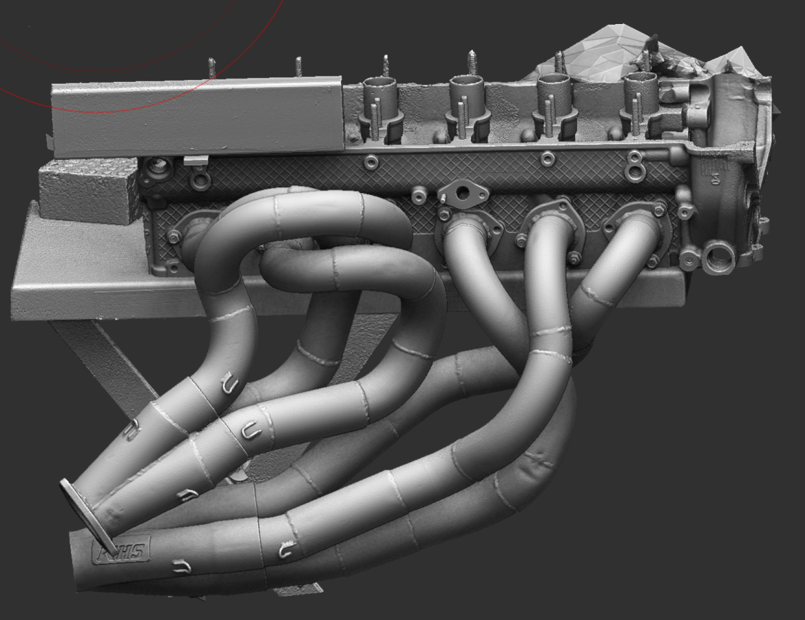

        I started putting some stuff on github:
        So far I uploaded the S54 head scan, CSL header scan, the current version of the pipemax configuration file, and scan of the exterior of the karbonius airbox.
          Kromer Kraft headers to scan thanks to George Hill

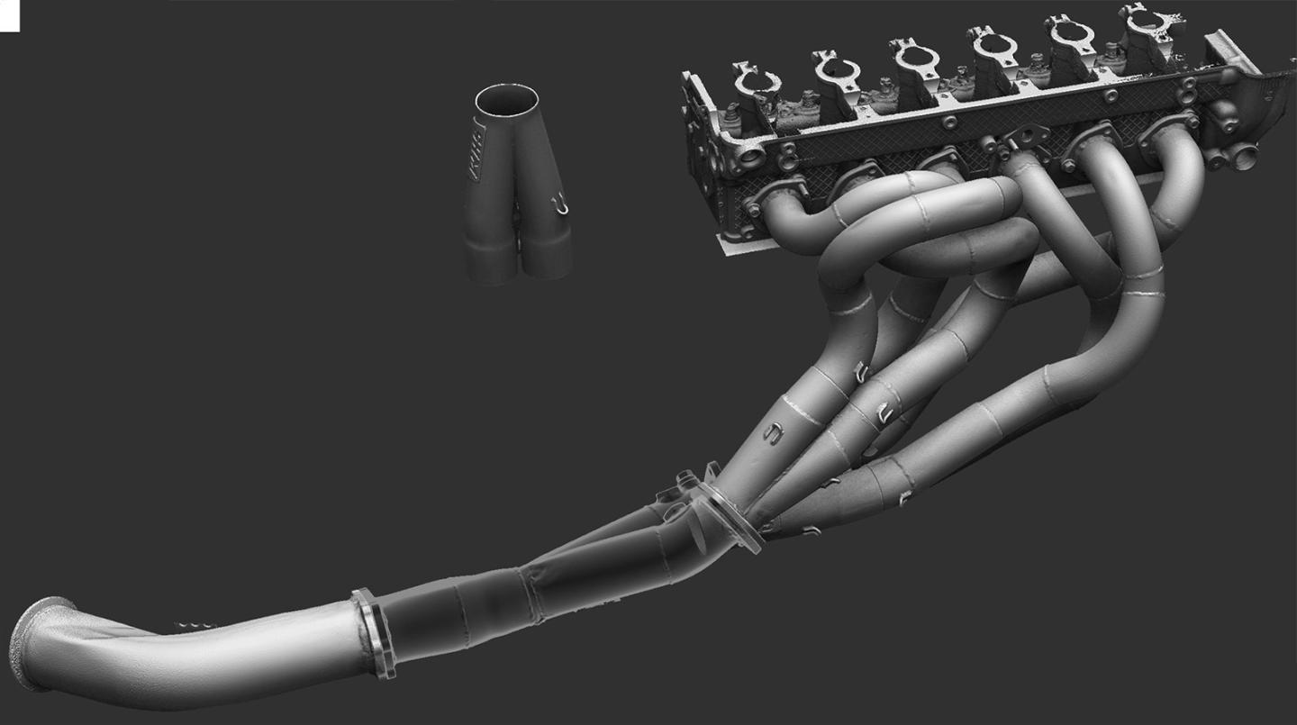

                    Assembled primaries and merges for the Kromer Kraft headers. Finishing up the scans for the other parts and getting some caliper measurements.

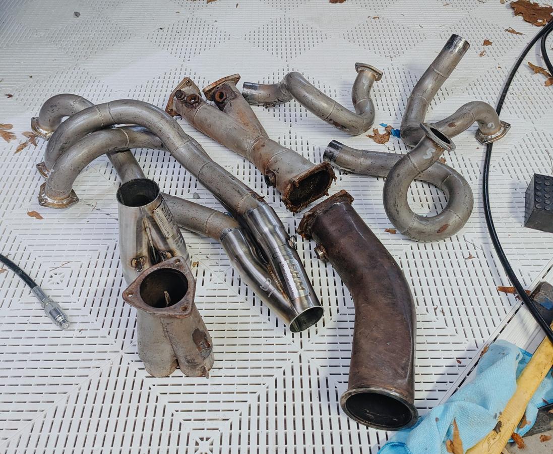

                        Kromer Kraft scans are up on the github now. I measured out the diameters for the primaries and they looks like this:
                        Tubes are a little out of round so many measurements were taken and this is approximate:
                        Primary first step
                        OD 44.5mm
                        ID 41.5mm
                        Wall = 1.5mm (16 gauge)
                        Second Step
                        OD 47mm
                        Expected ID if 16 gauge: 44mm
                        Third step
                        OD 51.2
                        ID 48mm
                        Wall = 1.6mm (16 gauge)​
                        I'll need to reverse engineer the primaries to get their lengths and where the steps are at.

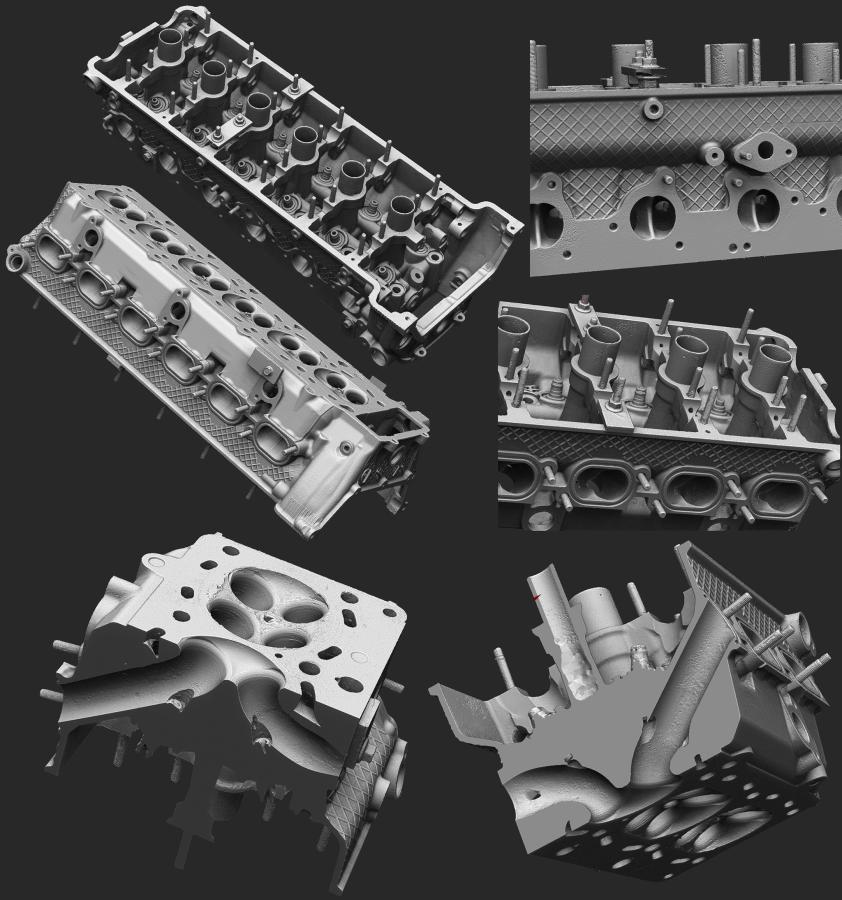

                            Hey so I’m new to the thread and wanting to build at 6to1 header design sequential firing order. Does anyone have a scan of the head or some way to get the flange measurements so I can open it in solid works?
                            going for a very exotic f1 sound thanks.
                              Going for something like this
                                I posted a link to my head scan on here
