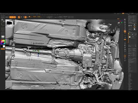

      Over the weekend I redid the scan for the chassis and header packaging, I found some errors in the last one I did between the above the engine bay and under the car alignment. I also expanded the scan into the complete underbody and a decent amount of the engine bay. The new scan is on my github as a 5 million triangle, 1m triangle, and 500k mesh. https://github.com/AlecMoody/AlecMoo...haustPackaging
      This is also by far the largest scan I have put together. About 3600 photos and over 24 hours to process the final mesh which was 4.5 billion triangles.

            I do have an E46 I plan to do the same thing with but its got an M54 so someone will need to figure out how to get the engine/exhaust ports into the correct location. I think I'm pretty much good with the design right now? I want to do some flow bench testing on my scrap head for a last sanity check on all the diameters involved.
              Given what Bry5on's scan data does to my machine, I am in fear and awe at whatever you are using to process that! Really impressive, and makes me want to get my car up on a lift for a scan. Expect N64-esque polygon counts though.
                If only I had a lift. Lol. This is quickjacks laying on my stomach with the camera resting on the ground facing up, scoot and shoot, move about 4" and repeat.
                  Thats crazy man. It totally blows my mind the quality you are able to get with your photogrammetry process. I need to dig back into your posts explaining the process.

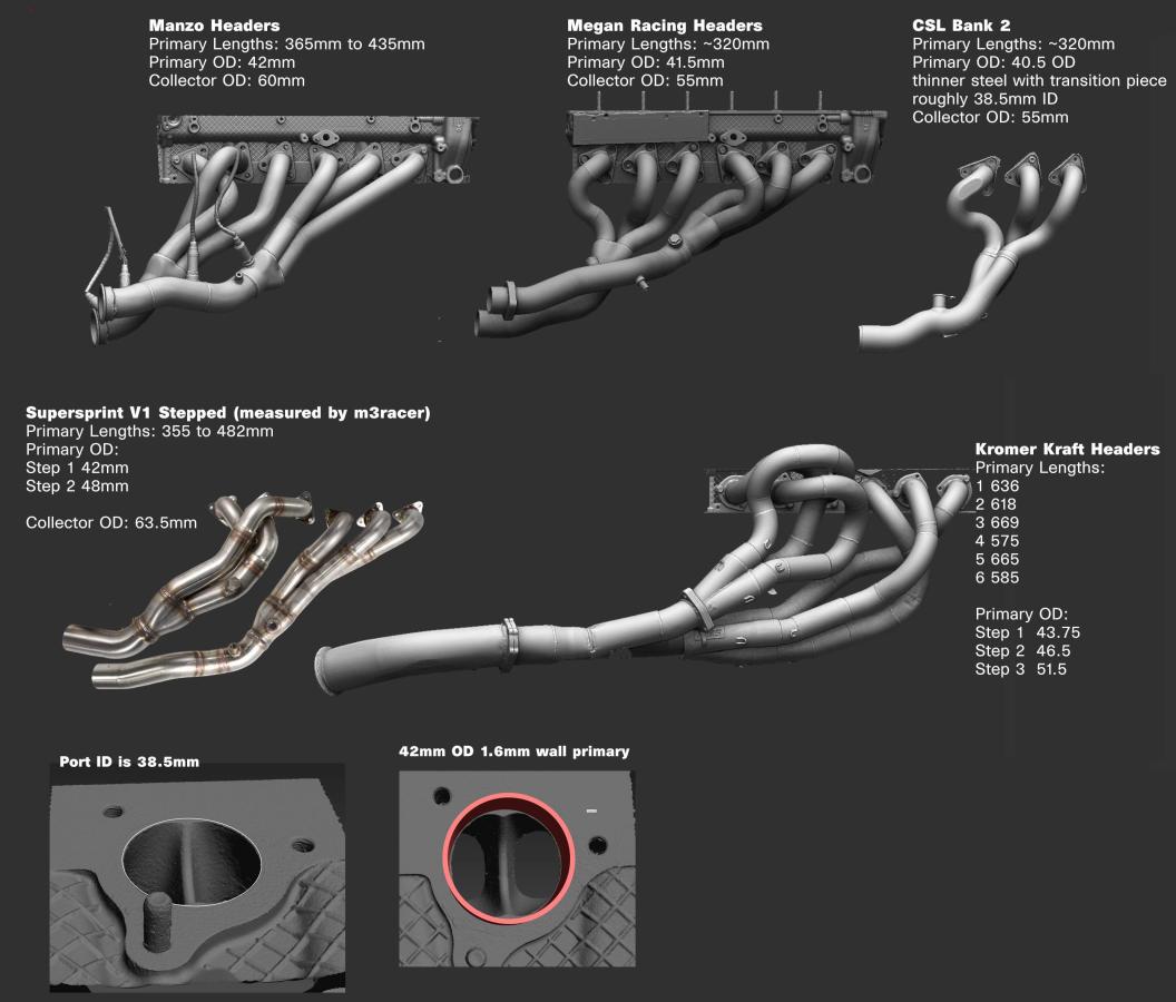

                    Looking mostly at diameters lately and wanted to get everything I have measured out of my notebook into one place and share it.
                    The supersprint header diameters are actually pretty close to what I want to do but the primaries are a very different length and its lacking any kind of choke in the merge.

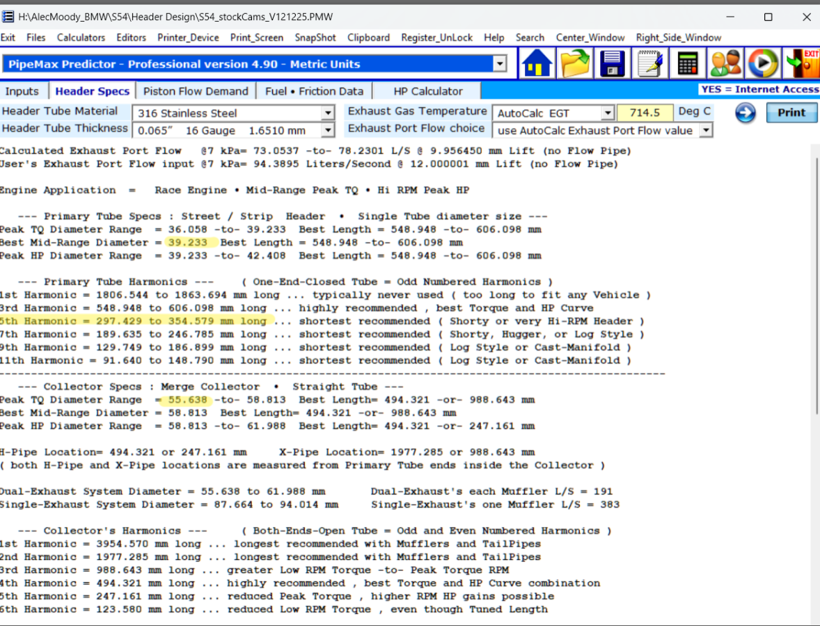

                    I tweaked my pipemax file and im getting horsepower and torque numbers that make a lot of sense and translate well to diameters that look like how existing headers would be designed.
                    My current plan is a tapered primary from 42mm OD (a hair over matching the port exit) up to 46mm at the merge. A 52mm choke/ venturi in the merge collector that tapers out to a 63.5mm OD collector diameter. Still looking a smaller than 63.5mm collector as well. I think something like a 60mm collector into a 63.5mm anti reversion chamber and then place that on some very short harmonic on the tuned collector length.
                    Primaries at 550mm length with merges inline for equal length collectors / good sound.
                    Click image for larger version  Name:	HeaderAllMeasured.jpg Views:	0 Size:	89.8 KB ID:	361535

                      MY MAN, did you make this 'infographic"? I NEED this as a poster, so frickin cool!
                        I think I have pipemax basically dialed perfectly for a relatively stock S54 now. If I switch up my output to give me a "Street/strip" header instead of a race header the outputs basically look like the euro manifolds on a 5th harmonic: Some of the pipemax documentation is really not great. No idea what exactly the intended output paramters for a street/strip vs a race header are. I'm already specifying what RPM I want target peak torque and what RPM I want target peak HP at regardless of which output I use.
