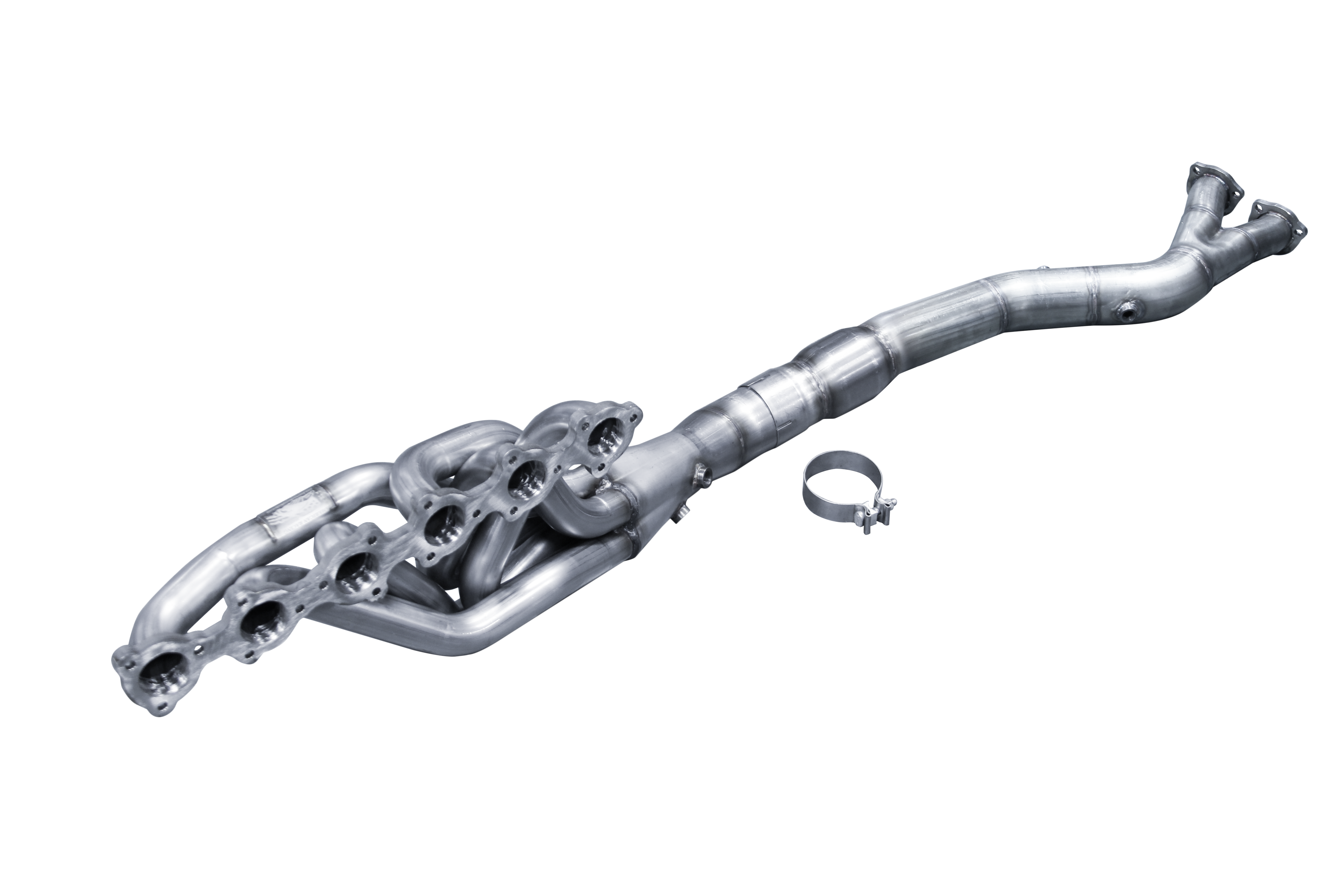

I haven't seen a lot of talk about AHR headers/section 1. Any thoughts on this? I too am interested primarily in getting that smoothed out, screaming exhaust note. Currently have SGT headers/section 1, Rogue section 2 with dump valve and stock muffler. Wondering if I can maintain stock muffler and still improve sound whether dump valve is open or full closed

6-1 headers/exhaust are pretty much known for making a great sound at the expense of torque and generally not much (if at all) hp increase.Originally posted by BTB View PostI haven't seen a lot of talk about AHR headers/section 1. Any thoughts on this?
