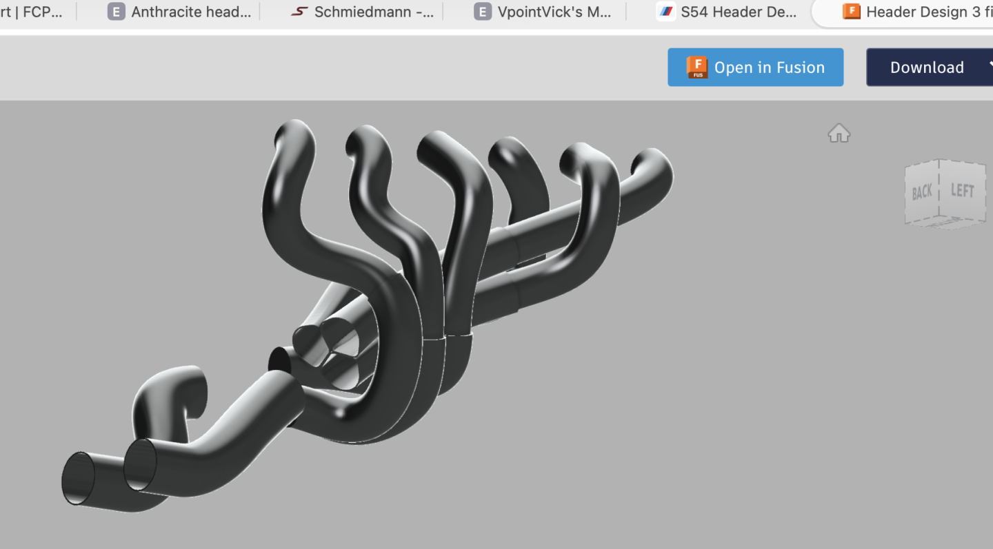

    This is a sketch of an alternative layout looking more like the way achillies did it. Right now its 575mm +/- 4mm primary lengths but that can be adjusted and cleaned up with some stuff like bend centerline lengths. I like how organized the two merges are and they clear the trans tunnel and lollipop heat shield perfectly.
    I'm planning to taper the whole way gradually but also switching a single step would be easy enough as well.
    At the moment I'm just laying it out as quick splines in 3dsmax. I'm going to transition to actual cad soon. Likely fusion 360 so more people can edit or modify for their needs but I'm much faster in 3dsmax so I use it for quickly testing ideas.

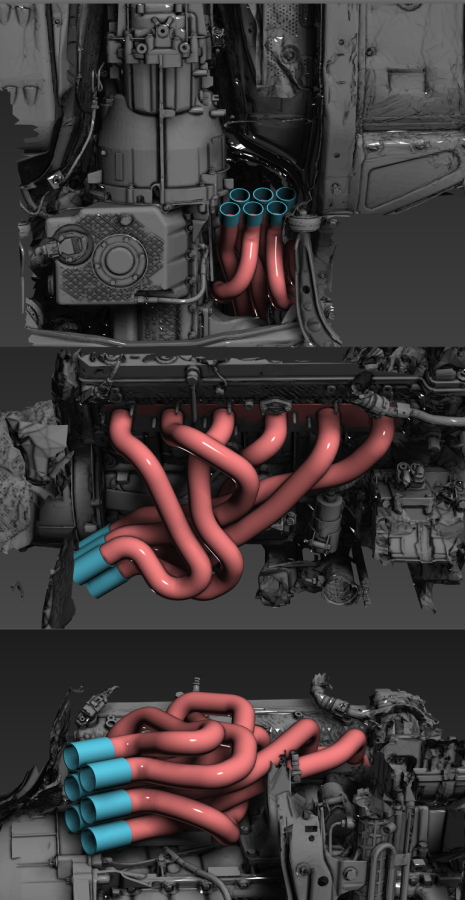

    Bry5on Do you have any kind of engine bay scan for the header packaging area for an e46? This fits the 36 well but I think a few spots on the E46 are actually tighter.

      Woah that certainly looks like a bundle of snakes! I think I sent you some engine bay scans and a scan with an s54 in it via email. I also have a couple fusion 360 models that I can share access to that have my header designs and scans in there simultaneously. Let me know when you switch and what email you want me to send the collab invite to and I’ll figure out how to do it. It’s a bit of a pain to design splines in fusion but is doable.
      I don’t think your e36 design will clear the e46 with shear plate based on first glance. If you want to export STLs, I can bring them into my model for collision analysis as well.
        Okay I'll look in my email for those engine bay scans. I can pack the primaries a little tighter too. I left space so that diameters can be easily increased but this is a 46mm OD right now. I want to rework #6 because that's a lot of turning before the merge. I think you were sharing some stuff with me through fusion but the link expired or something?

          Looks like I shared everything through the fusion link. It's all in the same link. Link appears still good on my end and is password protected

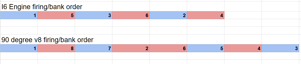

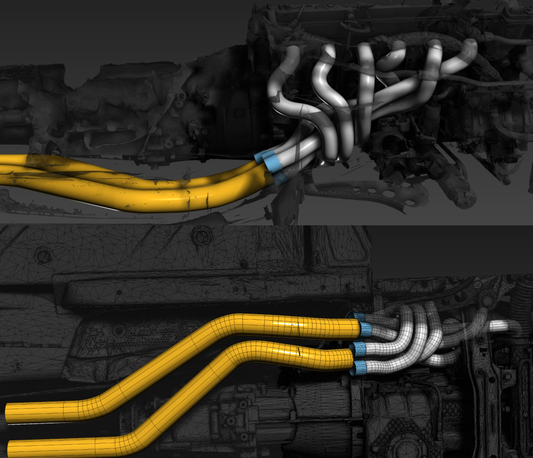

                      I'm working on my exhaust so that I can be prepared to have a good setup to A/B some header designs. Looking at crossover designs for dual exhaust, ignoring the Z pipe for now since I plan to model one of those and A/B with it vs a more conventional crossover. Info on crossover designs online is often targeted at 90 degree crank v8 engines where there is an uneven firing order between left and right banks and so exhaust pulses do not evenly alternate. For that application you actually want to mix exhaust streams to sew the two out of time banks back together (like 180 degree headers do). Most advice for x/h pipe placement is to get it as close to the merge collector as possible and I think that's because evening out pressures between banks is the priority and not timing scavenging waves onto a specific harmonic/point.
                      Firing order illustration:

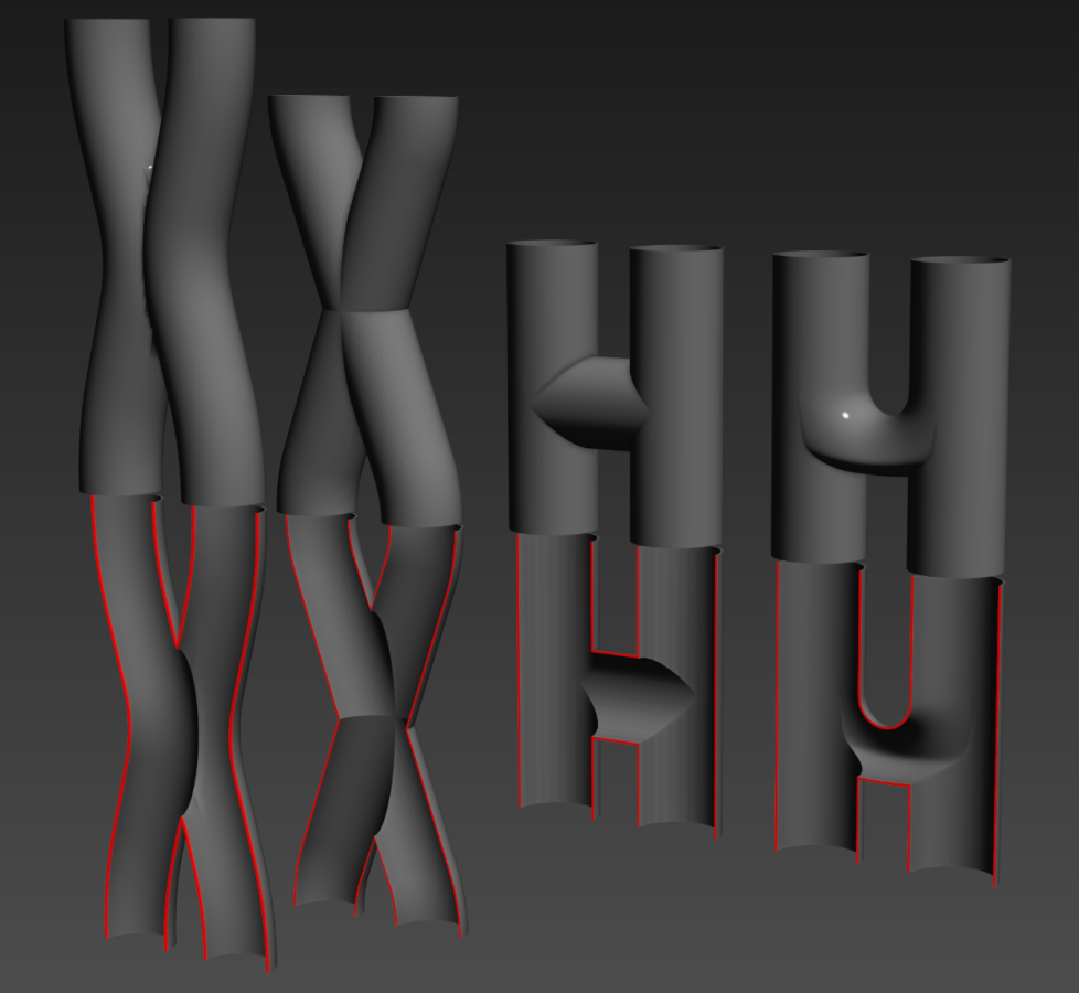

                      I don't think we need to mix exhaust streams but we do want to use a crossover to scavenge between banks and then time that on a harmonic of the collector length. I think the perfect crossover would be compact enough to get it into place where it is needed, able pull a strong scavenging wave at target peak torque (4900 rpm), and not generate so much turbulence that it is a source of restriction at high RPM. These are all my assumptions/ideas based on reading online and looking at what has worked.
                      From the left:
                      Tangentially crossed elbow X pipe, full stream crossing X pipe, traditional H pipe, and an H pipe design I came up with to try to reduce turbulence and exhaust stream mixing.​
                      The tangentially crossed X looks best to me and the overlap/window size between can be tuned to change the effect size and how much it impacts flow at high RPM vs how much of scavenges at low RPM. The main downside is it takes up a ton of space. It can be made smaller with more bend angle but more bend angle isn't ideal.
                      The full crossed X looks like it would generate a lot of low RPM scavenging but start to create turbulence at higher RPM when the time between pulses closer to continuous and the two streams crash into each other. Not sure if that is actually how that plays out of if they blend cleanly. Also at the cross point working out what CSA any given bank sees at any time is confusing and how that interacts at low vs high RPM.
                      My understanding is a conventional X can start to generate a lot of turbulence as RPM rises. I would assume this comes in part from streams crossing and then separating off of the harsh 90 degree angle.
                      The last design is my attempt to keep exhaust flow in the same bank but encourage pulling vacuum behind it from the opposite bank. Flow direction is from the bottom to the top in the image and the idea is that gas is separating off of harsh corner is less prone turning into the H and inclined to flow straight across the gap.

                        I’m pretty sure there is a reason BMW utilized the H design in our sec 2.
                          I spent a lot of time messing around with both the achilles layout and the claw layout. I couldn't get the Achilles one to stop fouling on the motor mount rubber. I went back to the claw layout and moved the merges and was able to get primaries 2-5 within 0.5mm of each other and #1 is currently 1.5mm longer. Merge positions are making about 50mm of uneven collector length which people can ignore or this exhaust routing makes up for it without introduce wavy bends. Exhaust lengths are equal as soon as they return to parallel after the last bend. I'm not worrying about keeping factory flange locations. I'm going to move this into fusion next weekend, model up all the important details like flanges, taper, merge geometry, etc and then 3d print some plastic test parts for fitting. I also want to try some basic acoustic testing on all the primaries and see if they produce the same pitch when air is blown into or across them.

                            I think the e36 is actually more generous than the e46 for clearance based on what I’m seeing. Instead of a steel x-brace, the e46 has an aluminum shear plate that’s right near the end of the collectors. I think the e46 will favor a ‘tucked up’ grip arrangement.
                            And thanks for writing off the Achilles approach and saving me the effort of modeling it 😅
                              I'll load up your scan data soon and see how it fits. This design doesn't protrude any lower than the factory exhaust so I think it will clear. If not it can probably be worked around
                                Keep in mind the E36 engine support arms are not interchangeable with the E46. Also, the distance between the arm and firewall is different between the two cars (if you swap E36 and E46 arms it moves the engine forward or aft, I can't recall which). My KKs are designed for the E36 chassis and I made them work with the E46, but they absolutely do not work with an E46 support arm. *My point being if you are using ALL of the E36 real estate they likely won't fit the E46 chassis.
