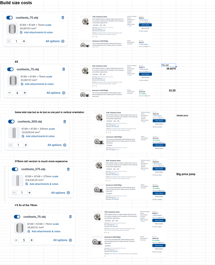

    Looking at how craftcloud prices with their auto quote system. First test is for finding maximum dimensions before the price jumps up. There is a hard jump somewhere between 300 and 375mm and I assume that has to do with needing a bigger machine:

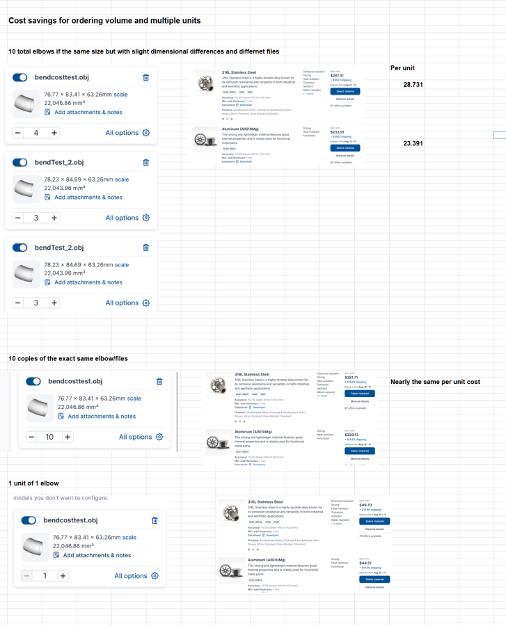

    More interesting is how it handles multiple units of the same part and ordering volume. For this I made 3 nearly identical elbows, files are all slightly different. Pricing doesn't seem to care about 10 units of the exact same part vs 10 units of a mix of similar parts. It does give a large discount for quantity.

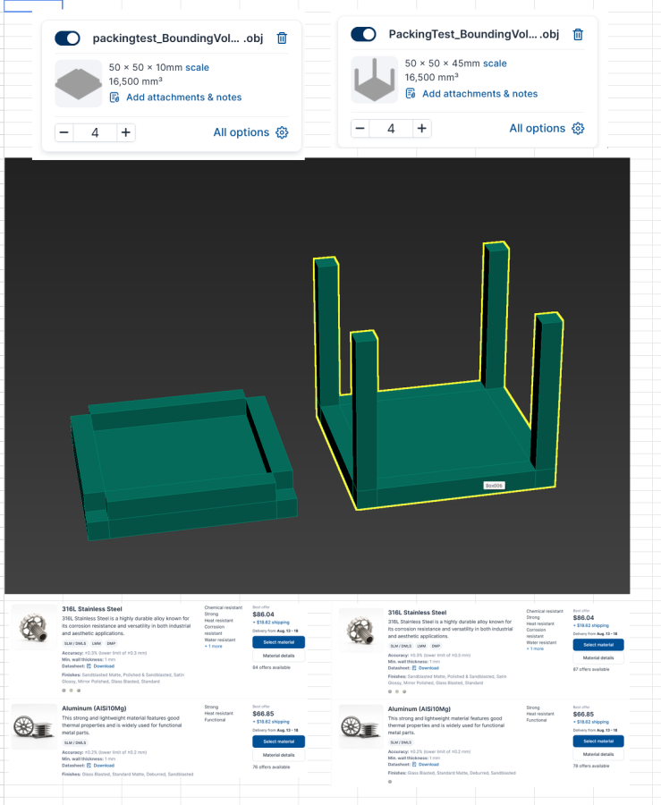

    Tomorrow I want to test some complicated shapes and compare bounding volume, material volume, and how much something impacts packing space in the machine. I'm expecting parts that pack easily to be cheaper than those that would eat up more space in the machine or be harder to pack efficiently.

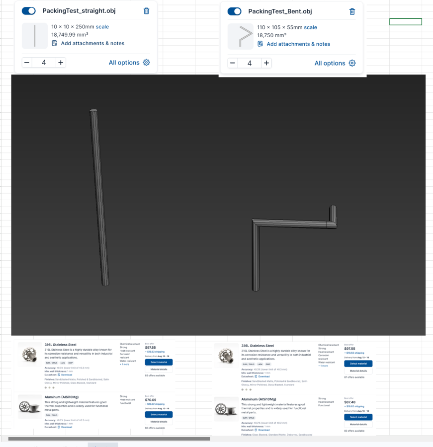

      Quick testing on how packing efficiency impacts pricing and it doesn't really seem to in any meaningful way. I'm sure there is some minimum scale at which a negative space is considered not pack-able by their software but it's probably a smaller scale than matters for anyone making car parts.
      Both of these tests the two models have exactly the same total volume they are just laid out a little differently so they take up a bigger bounding box or become harder to densely pack into a build volume. This is good to know because it means bendy primaries aren't any cheaper by cutting them up more times to keep straighter runs. There might be support material reasons to try to do that but its at least not a cost concern:

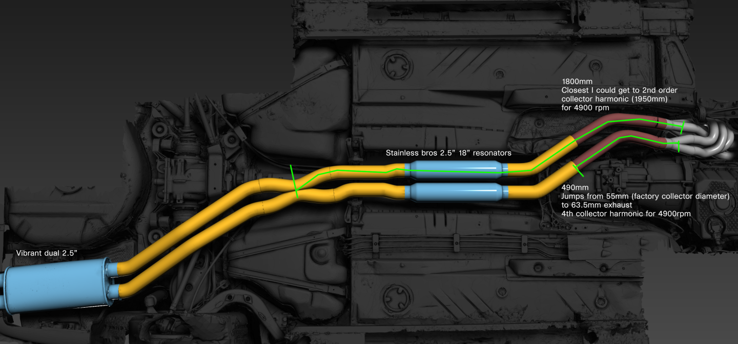

        I think this is how I'm going to lay out the exhaust. The merges are so much further down the line which shifts back a bit compared to what people are used to. This X pipe location is on the second order harmonic for 4900 rpm which is where the factory puts the H. Also stepping from 55mm factory collector diameter up to 2.5" exhaust at the 4th harmonic which should also generate a wave that hits at 4900 rpm. The transition to 2.5" tube is dead on equal length and then X cross is very close, within maybe 20mm. Total exhaust length is also very close. This should all sound very good and perfectly in time between banks and at every wave,splitting event.

          I think that you’re right that ditching the factory header flange location makes sense. I think this is why I was struggling so much to pack everything.
          Would it make sense to target a different harmonic for the 55-63.5mm step up? Or is it advantageous to stack all of the harmonics at a single rpm? Thinking maybe you’d want to move this closer to 7krpm if you could to broaden the curve benefits.
          Now you’ve got me thinking about making a full section 2 with a better/shielded cat setup for the HJS cats. Hadn’t considered downstream of the headers printed parts. Are you running catless?
            I'm not sure about stacking harmonics vs spreading them out. Sort of by mistake the two collector harmonics are slightly spread with the X pipe hitting slightly higher rpm. I'm very curious to see where there might be holes in the torque curve. Also my understanding based off of google reading is that H pipes tend to produce a bigger effect on the bottom end at the expense of high rpm flow and X pipes do better on the top end. Not sure how big that difference is though or if its going to matter here.

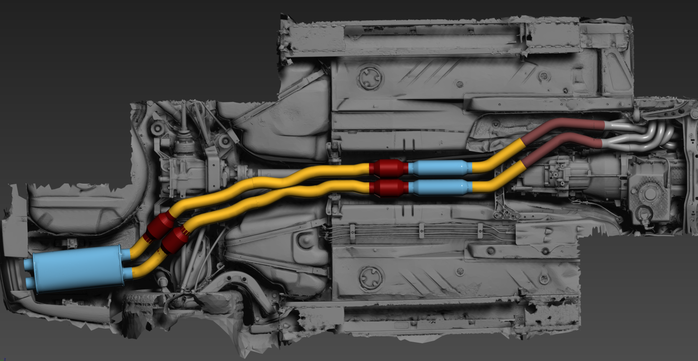

                It's one more place to spend money right now and another packaging problem to solve. The 2.5" cats I have here are probably slightly too big to fit side by side with this 100mm on center exhaust routing.
                  Fair enough for your own project but personally I think if you don't make allocations for cats to fit, even at a later date, you are cutting out a large segment of potential buyers. IMO a guy who is into your kit for $5-6k isn't going to be stopped by $500-750 for cats.

                    Here are two possible locations for cats. A more typical middle position with the resonators swapped out for 12" versions and a position way far back where cats reducing velocity won't matter. They will take much longer to heat up in the back but should have the least impact. You could also just as easily move them to just in front of the resonators.
                    I'll update the exhaust and xpipe spacing to 104mm on center to fit 4" cats without any challenges.
