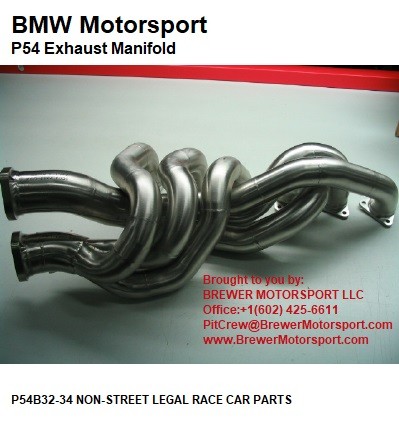

                      This layout is definitely the way to make it package. I tried a few quick spline layouts and only this one really made sense to me.
                        They are also equal length. My understanding is they don’t offer good low end torque but that’s something could be fixed by stepping them like SSV1.

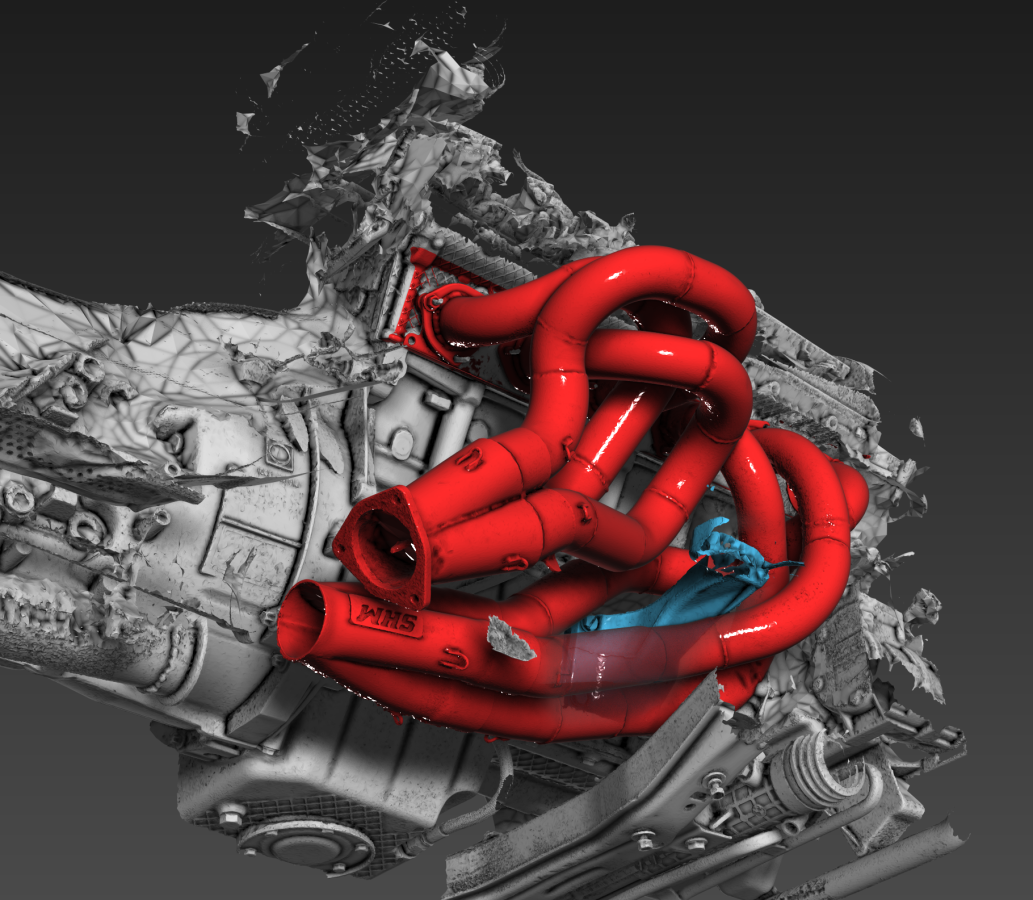

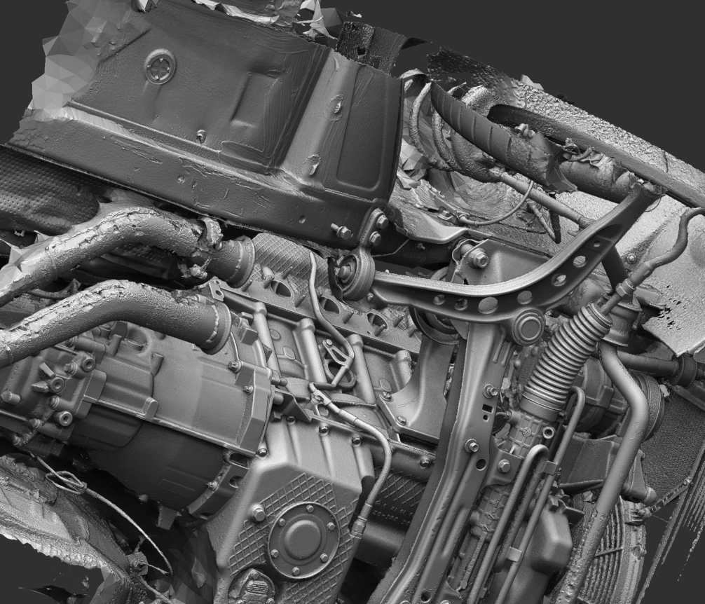

                            This was a pretty challenging scan for my setup, especially on quickjacks. The camera setup is to bulky to get into most positions and then there are very few surfaces that can be clearly seen from above and below that can be used to tie together image from both sides. Also shooting through the top into a small gap to try to see the top of the engine mounts, etc most of the light is blocked.
                            So far pretty happy with the result. I think the two sets of images stitched relatively well:
