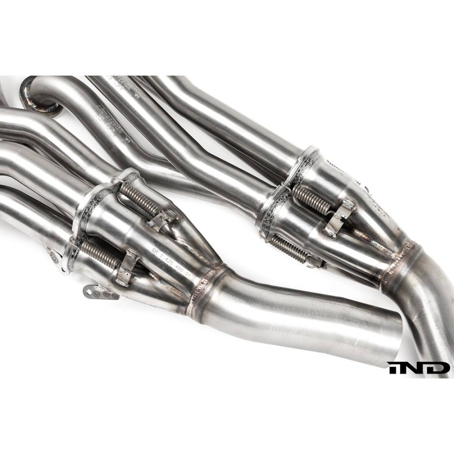

                  i was more thinking about slip on collectors like the 3D printed version of
                    I've been assuming that the move is to print the final step inclusive of the merge, with each first or first+second step as its own pipe+flange. Then fixture those up with a simple fixture, weld, and enjoy.
                      yes, but with one whole piece having 3 primaries, collector merge and collector pipes segment it makes it much more difficult to install particularly as the primaries get longer
                        There is also the Supersprint idea, but it is bulky
