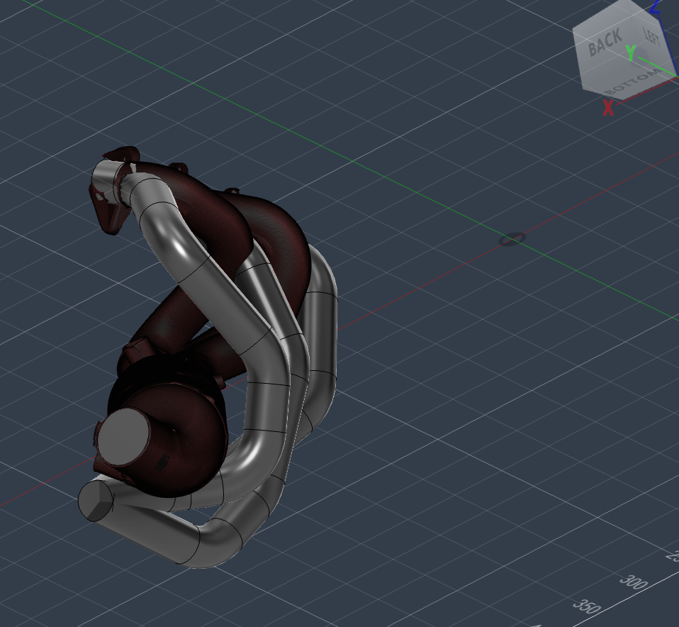

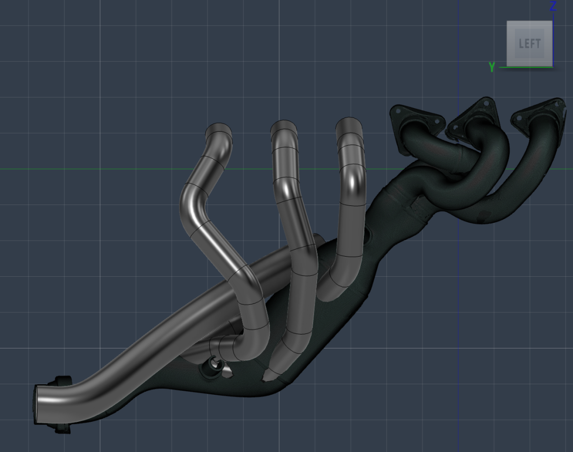

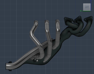

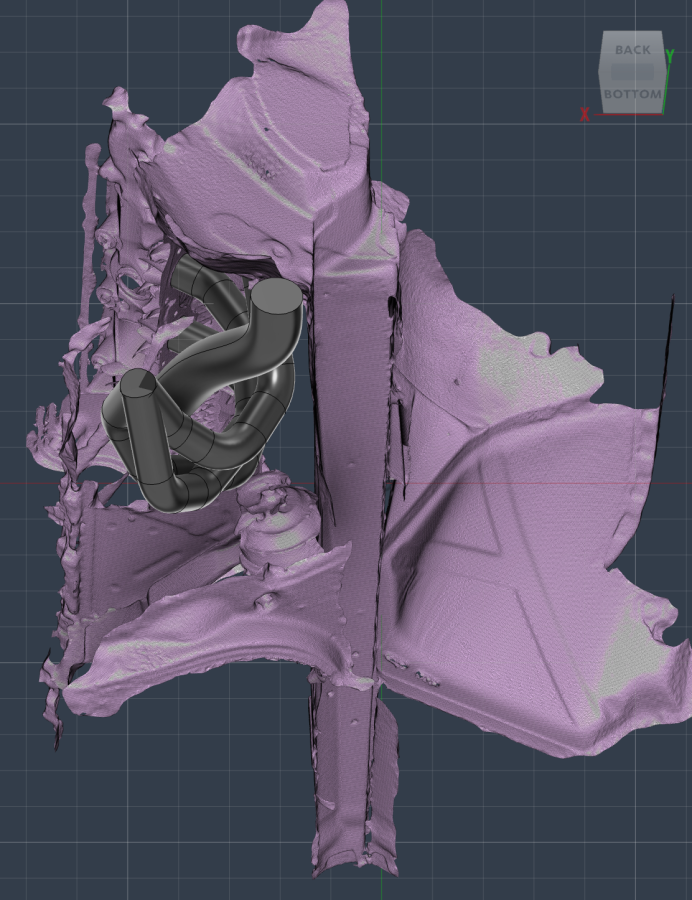

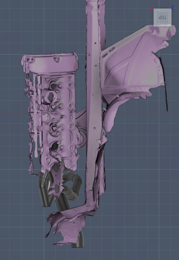

      There's plenty of room to do the 'hand grip' header in there. This is a 37mm extrusion with space all over the place, US headers shown for clearance reference:

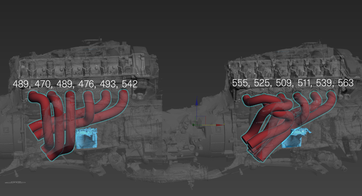

          Here's two different layouts, both at their minimum primary lengths where I could still get something close to equal lengths and also get the merges placed in line with each other. The primaries can be made longer easily but not shorter without getting more extreme on bends or losing the merges being placed in line. Version on the left is inspired by the P54 headertube layout and the one on the right by the Kromer Kraft headers. Neither is a copy of anything, just following a similar routing.
          I think the design on the left is a lot better, fewer bends, should fit easier, and there are more possible primary lengths so its a more flexible layout.
            Beautiful. What’re you using for CAD that allows you to show the primary lengths like that?
              I think the design on the left is a lot better, fewer bends, should fit easier, and there are more possible primary lengths so it’s a more flexible layout.
              The Motorsport headers are true equal length there design allowed for a lot of high RPM torque but weren’t great in the low RPMs. The Epic headers were similarly designed and from all the designs I’ve seen a it’s been the best.
                It's just polygons in 3ds Max. It's the fastest way for me to sketch stuff and when I go to make a cad model I'll bring that into SolidWorks as a reference.

                  How close in length are you targeting?
                  I assume the Kromer style will be easier to tighten up the length variation?
                  While the P54 style will be way easier to manufacture and install/work on.
                  How much do you think the packaging will change when fitted to an E46 chassis? Or maybe I should say, how much will the E46 chassis and engine support arm restrict freedom of tubing layout compared to the E36?

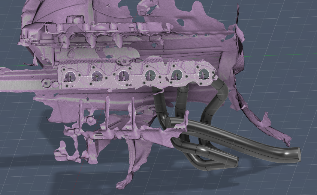

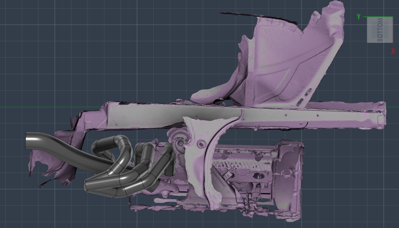

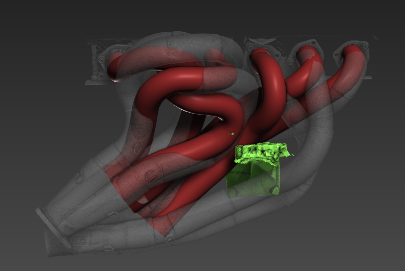

                          This is already heavily cleaned up from the kromer kraft original design. This picture is the scan vs this tube layout- You could absolutely sit down and fiddle with the lengths more but this is pretty close before adding super convoluted tight radius bends to add length. You can see its pretty different and also I moved primaries 1 and 2 to sneak them under the engine mount instead of wrapping around it so that it would be possible to make this header as two solid banks instead of individual primaries that slip fit into the merge.
                          Click image for larger version  Name:	image.png Views:	0 Size:	580.7 KB ID:	351779 ​
                          I'm not 100% sure on E46 fit yet. I need to look at that closely next. I have an e46 chassis here I can scan but no way to correctly get the S54 placed into the right spot (its a 330i with an m54) Bry5on shared a scan with me a while ago that I think includes some E46 chassis in it. I might be able to align that with my E46 scan and get the engine placed correctly. Also I was under an E46 looking at space last week and I think there is actually less room on the E46 than the E36 which I was surprised by because the E46 chassis is wider. If it's just the engine support arm causing an issue then the designed based on the p54 has plenty of room to move primary number 4 away from the arm. Not so much on the other design without really throwing off the lengths.

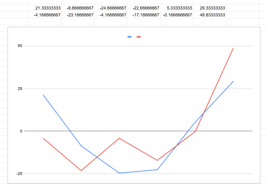

                          As far as how close to equal goes. This is mm of delta from the average for each of the two designs. P54 style is the red line and kromer kraftish layout is the blue line. Right now its at about a 50mm spread which I think is pretty good:

                            Not calling it a copy at all, just referencing the front bank tucking behind the back allowed them to be equal length, in essence that design features has been best. I’m excited to see what you put together I have plans in the future for a 3.5 build so might be asking for help in the future if you’ll lend it.
                            Yeah I just meant that whatever characteristics that layout has show probably wouldn't be reflected in this since the basic dimensions will be very different.
                              I’m targeting +/-<3 mm, so +/-25 seems pretty bad! What mean length are you going for, and have you settled on a half-way step or something like a 2/3, etc? I was looking at the T50 and it appears the step is super late, more than 2/3 in.
                                I believe the part numbers for the front right motor mount arms and the crossmembers are both identical between the S54 and M54 cars. I would think that you could use the motor mount as a common point between the models. Alternatively, IDK if you can get any through holes on the bellhousing bosses but that could give you an locating point, I would think?
