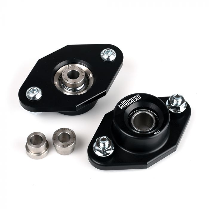

      I run Millway
      Upper Shock Absorber mount in aluminum with bearings for the shock absorber upper mounting point. Original rubber mounting point flexes a lot and will break sooner or later. With our mount with bearings, it will be completely flex-free, and allows the shock absorber working as intended. It also removes accents on the s
