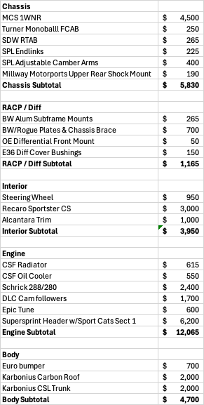

    I've been interested in buying a 911 for over a decade, and probably should have done it when I first started thinking about it, but didn't. I recently had the opportunity to drive a well equipped 2006 Carerra S with PCCB, and while I liked it, I didn't walk away with a "I HAVE to get one" reaction. I'm not saying it was a perfect example but it was decently cared for with 58k on the clock. My friend told me he wanted near $50k for it, and I just don't see that car as offering a $50k experience. Something that starts with a $3x,xxx and I might be a buyer.
    As such, I'm looking to finally focus on putting new life back into the M3. I bought this car back in 2010 with ~80k miles, daily drove it for about 2 years until our first kid was born, and it's largely sat on the side for the better part of a decade. It's an early 2003.5 now with 111k miles. I've thrown the full Beisan catalogue at it, did the BE coated bearings, cooling system, and some other basic maintenance. More fun stuff is the CPI RTX, SS res X pipe, SS Sport, and Evolve airbox with Kassel MAP conversion and tune. It's about to get a significant refresh as the H&R/Koni suspension is corroded and at the end of its life, the old Michelin super sports are cracking, and the RACP needs to be done which brings a ton of other "while you're at it" items.
    The car will primarily be used for street duty and needs to be well mannered, but I do want it to be "track competent." It will see a few 200 mile road trips each way every year, and if it sees the track it will be driven there and back. I also want it to feel like an occasion when I drive it. For each item I generally want the best available part for the stated purpose. Some of these items are probably unnecessary, others there may be a better option, some things are omitted, and some I'll never get around to. But I have to start somewhere and I generally haven't been able to keep up with all the chassis development over the last decade. Hoping the collective can provide some guidance.
    Generally planning on addressing the RACP/Diff first, then chassis, then interior, then body, then engine.
    So here you go, with BF coming I'm on the looking for deals on anything and everything.
    Chassis
    MCS 1WNR $ 4,500
    Turner Monoballl FCAB $ 250
    SDW RTAB $ 265
    SPL Endlinks $ 225
    SPL Adjustable Camber Arms $ 400
    Millway Motorports Upper Rear Shock Mount $ 190
    Chassis Subtotal $ 5,830
    RACP / Diff
    BW Alum Subframe Mounts $ 265
    BW/Rogue Plates & Chassis Brace $ 700
    OE Differential Front Mount $ 50
    E36 Diff Cover Bushings $ 150
    RACP / Diff Subtotal $ 1,165
    Interior
    Steering Wheel $ 950
    Recaro Sportster CS $ 3,000
    Alcantara Trim $ 1,000
    Interior Subtotal $ 3,950
    Engine
    CSF Radiator $ 615
    CSF Oil Cooler $ 550
    Schrick 288/280 $ 2,400
    DLC Cam followers $ 1,700
    Epic Tune $ 600
    Supersprint Header w/Sport Cats Sect 1 $ 6,200
    Engine Subtotal $ 12,065
    Body
    Euro bumper $ 700
    Karbonius Carbon Roof $ 2,000
    Karbonius CSL Trunk $ 2,000
    Body Subtotal $ 4,700

    That list is more track car than street car. Have to dial it back IMO. Mainly the MCS, monoball FCABS, 288/280 DLC, CSF.
      I'm more than happy to leave off the monoball FCABs, but I thought I had read on here that they don't increase NVH?
      The cams are way down the priority list, but as long as it still holds idle why they would make it less street worthy?
      I've gone back and forth on the MCS in my head a million times. Part of me wants to get the PSS10, but the other part of me thinks that a higher quality damper with modest spring rates will ride just as well, and definitely feel more "special" ever time I get in it?
        Mcs is like eating Bestia while everyone else is at Wendys
          lol this whole build looks familiar.
          OK, since you're doing Millway rear shock mounts, I'd also run their FCABs (I do in fact), and I'd suggest their RTABs as well. Keep it in the family. Plus, Millway > Turner.
          Again, on the subframe mounts I'd go Millway since you're already running them and they are A++ quality. The Rogue chassis brace and exhaust braces are totally unnecessary and I only run them since it's a show car, but if you have money to burn then what the hell.

            Personally, I'd run the Nitron R1 over the MCS for the same price.
            2004 Dinan S3-R M3
            2023 X3M Competition
              I think your order of priorities is about right since you already have an Evolve airbox. I think I would do the headers before body though. Get a good set of lightweight wheels and maybe an Autosolutions SSK after getting the RACP and suspension sorted. At that point the car should be well suited for double duty.
                I'd go with do88 over CSF, but I'm also mildly retarded
                Looks like an epic build, I'm sure it'll be quite the car when you're done
                how's the NVH with the solid FCAB/RTAB? Happy to use them for the subframe as well if they're better - what makes them better?
                The rogue chassis brace I'm referring to is the topside RACP reinforcement, not the v-brace underneath the car.
                I'll never get all the way through the list. It's more to keep myself organized so I can watch for deals on BF, classifieds, etc, and keep moving towards a specific target.
                  I've started to look at the Nitron R1 as well, curious why you'd prefer them? The MCS seems to be pretty universally well regarded.
                    I have Apex EC-7 18x9 and 18x10 on 255/275 with I think an E60D short shifter and delrin in the linkage.
                    I've been poking around and period correct BBS wheels, but unless I spend big money there's not a ton to gain.
                    with 110k+ miles the car needs some paint/bodywork as it is. I know there's a lot to be had from headers, but I don't feel like the car really "needs" more power. But I do often look at the knicked up bumpers, door dings, etc and it bothers me.

                        I don't want it to be a track focused build, and if things like the monoball FCABs add NVH that I won't want to deal with on a 3hr road trip, then I'll happily skip them. That's what I need everyones input for. I haven't done a good job of keeping up with all the development with this car over the past 12 year through two kids, two moves, five job changes, and an on-again-off-again pursuit of competitive amateur golf.
                        But when I got this car I think the collective opinion was to never put any solid bushings in the car anywhere, and now I think it's accepted that solid subframe, solid RTAB, and others don't add any noticeable NVH. I've watched the tuner du-jour go from epic, to TTFS, to the scotland guy, to hassan, to a mullet tune. Point being a lot has changed over the years, and please tell me I'm wrong wherever the modification listed violates the stated objective of a well-mannered, street focused, but track competent build.

                          Looks like a very familiar build to me too, haha. It'll be a GREAT street setup, I actually think my car is more like a M3 CS. A little bit tarted up, but not a total track car by any means.
                          One comment. Ditch the CSF. Either go OEM, or DO88. I went CSF and my car started overheating, for whatever reason, it's does not evacuate heat well with the S54. If you really want the CSF, I'll sell you the one sitting in my garage for a deal 🤣
                            If this is a street car, then yes, the parts you've selected are going to transmit NVH and you probably won't be happy. Especially hearing you say things like a "3 hour road trip"
                            When you go spherical you have to understand the nuances and limitations that come with it... you are going to hear clunking, things will be loud, and the car will be stiff. Parts require maintenance, and with no deflection in the rubber, everything better be up to snuff or you're going to have other parts fail. It is not suggested for street cars. My car sees little to no street use... and when I do drive it on the street I'm prepared for the sacrifices in comfort and noise.
                            That being said - if you buy quality parts with good bearings (Aurora, FK) and you make sure things are serviced in a timely matter, and everything is greased, you shouldn't have any issues. A spherical car can be surprisingly compliant on the street if setup properly.
                              MCS is well regarded cause it's the Spec E46 suspension. And yeah, it's a good coilover. But I personally don't find it superior to Ohlins, KW, AST, Moton, or others, I actually think it's over hyped. But, I've only ridden in one car with it, maybe it just wasn't setup right.
                              I've never ridden in a car with Nitron, but I was looking closely at them at the Bimmerinvasion booth and they seemed really nice. The quality is way up there.
